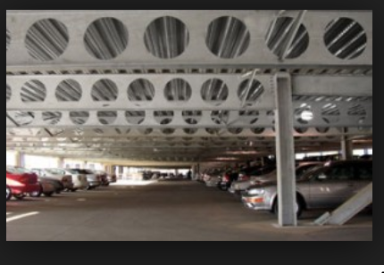

Think of all the radiator pipes they could run in that car park if they wanted to though. They must have been planning ahead for when they turn it in to retirement flats.
