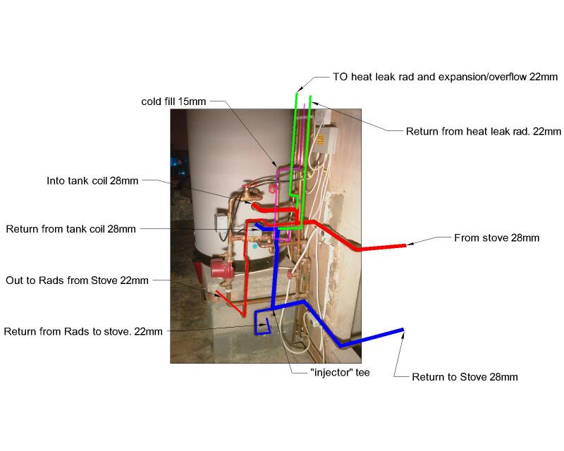

Where do I start?? CH system & DHW...
Firstly, I must say I am not conversant with this cylinder, but as it appears to be based on a thermal store, the radiators should be connected to the heating circuit outlets on the cylinder (5 & 6), the boiler/stove flow and returns to the post heating connections (1 & 2), whilst the solar connections are 3 & 4. Hence my belief that the boiler and stove need to be plumbed together before the cylinder as my previous post..
Because of the lack of hot water I would be loathed to plumb the rads into the tank, there is little enough DHW as it is!. No, the rads tee off before the tank and the high stat kicks in the CH pump at 90 deg C on the gravity flow from the stove to the tank. Theorectically an "injector tee" on the return draws SOME hot water through the DHW tank to keep a flow to the DHW to avoid robbing all the heat away from the tank.
It does mean the woodstove and hot tank are plumbed in parallel but one problem is the CH pump reverses the gravity flow through the tank when it kicks in?? (injector tee not working?) ....and I don't think you could put a one way valve in a gravity circ??
Driving me insane... and the plumber wants ME to take time off work to show HIM whats wrong with the system!!!!

ACV technical up in Fife recommend connecting the primary heat source flow at 1 and the lower 2 (as I thought)
If you have solar connected at the bottom coil then a 3 port valve on the return diverting between the two 2's allowing more solar gain when appropiate.
The recommendation for solid fuel is at 5 and 6.
Your first priority should have been to your DHW requirements thus the 600L would have been better in your case.
With solid fuel at the bottom then use 5 and 6 on the opposide side for radiators.
If the DHW is unvented then a standard solid fuel connection is a no no unless the DHW section is set up as vented or alternately have the system set up with a separate neutralizer/low loss header arrangement.
The "post" heating they refer to is a European term afaik and is the upper section of the primary water jacket that surrounds the inner stainless steel cylinder.

The diagram in the instructions have a couple 2's and a 5 on each side. Is it purely the "upper" connections are flow and the lower ones return? On a radiator the ideal connections are top to bottom, end to end I believe, in this case would it be better to go in on one side of the tank high up and return out of the other side of the tank, low down?
As our friend the plumber has already connected the oil boiler into RHS 5 (heating flow) and coming back out of 6 RHS (heating return) I intend to ask him to remove the stove from the solar coil in the first instance. ACV technical suggested the easiest would be to connect the wood stove to no 1 top LHS and return to the stove 6 and bottm LHS.
Me, I would chop all the pipes off it to start with and start again!
You mention a "bottom coil"? as far as I am aware there is only a bottom coil but I wil stand corrected?
What would you class as the "primary heat source". We have been running the stove only for quite a while now and I purposely haven't orderd any more oil until the stove side and DHW is sorted properly.
The DHW is vented. (there is a hot water loop runnning down the house to the bathroom as the property is 28m long . The loop is vented at the cylinder.
How can I tell the plumber to remove the brand new "undersized" store and replace it with the 600 like several people have recommended? The SLME600 is 600 litres TOTAL capacity (606 actually) and is still only 225 l sanitary capacity.
Was talking to one of their people earlier and the recommendation I received concerning the solid fuel was 5 and 6 as a solid fuel stove is not the primary heat source.
The oil boiler is the primary heat source and should be connected at 1 and the lower 2 giving HW priority and top down fast re- heat. This is how the SL cylinders are connected also.
There's only one coil. Stating "bottom" was just a reference and the recomendation for the coil is "Solar".

You say "giving hot water priority", sorry non comprende on that one
Top down cylinder heating delivering the boiler heat closest to the draw of point as opposed to convection currents rising slowly from the lower section.

The woodstove is just through the hole in the wall.
See how many 90 degree bends you can count that the flow from the stove has to negotiate before it gets to the tank!!
Also note the 50mm rise from stove to tank!!
