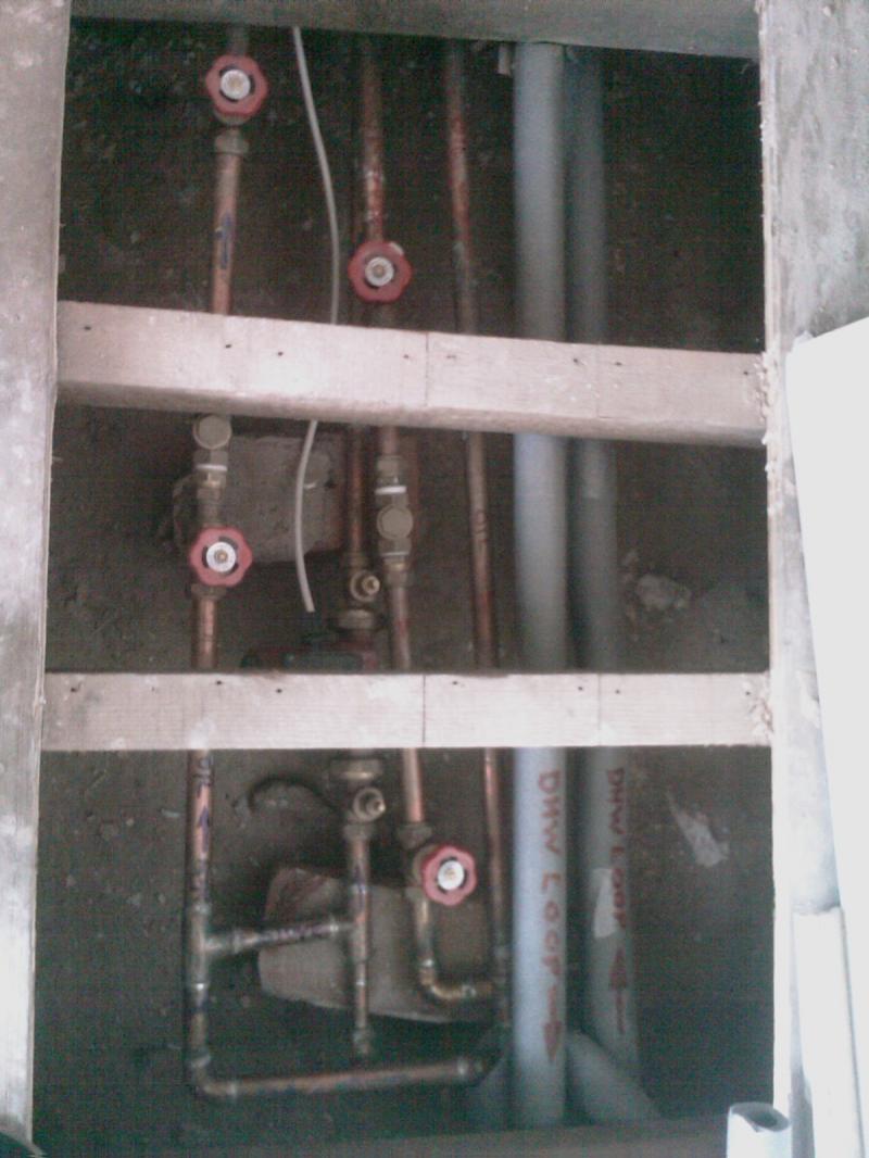

What model of solid fuel stove have you fitted and does it have a separate circulating pump fitted?
located near the DHW tank
It's not in the image as far as I can see. I assume the pump that is visible is the oil boiler pump.
Where is it located exactly?
Sorry, I was refering to the pipe stats when I said near the tank. The rads pump for the stove is just under the floorboards on the return to the stove, about 6 feet before the so called "injector tee" in the piccy. (will post a piccy of the pump in a mo.)
Yes, the pump in the piccy is the oil one that has the two valves just after it for water and rads circuits.
Ok, piccy of rads pump for woodstove looking down onto floor. (should have rotated piccy really.)
Pipe in order left to right:-
1 - Oil return flowing up piccy
2 - Stove return with pump (hidden by floorjoist) flow up piccy
3 - Stove flow from stove after tee'ing off from gravity circ, flow down piccy to rads
4 - Oil flow to rads. flow down piccy
1 & 2 tee into each other bottom left of piccy
3 & 4 tee into each other bottom right of piccy.
Note non return valves cos of reverse flow.
