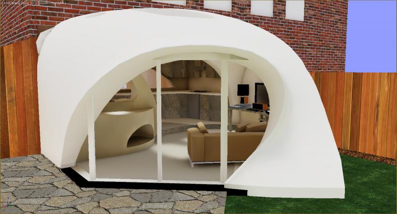

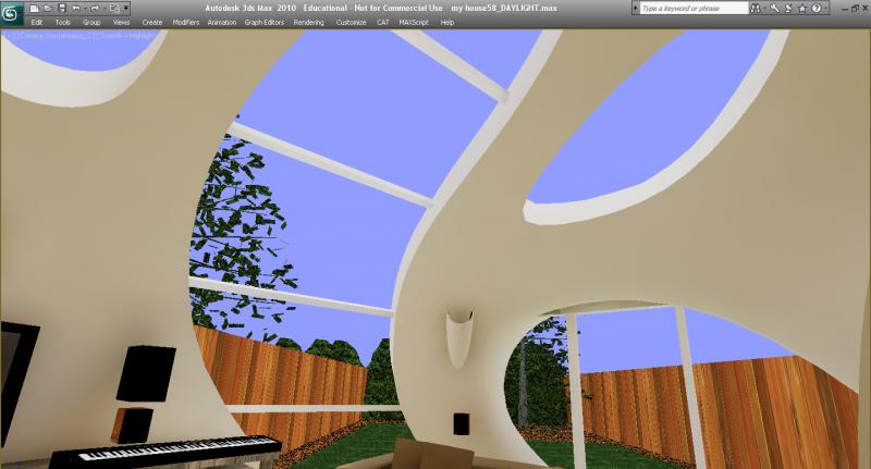

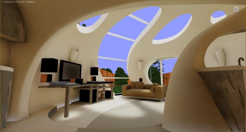

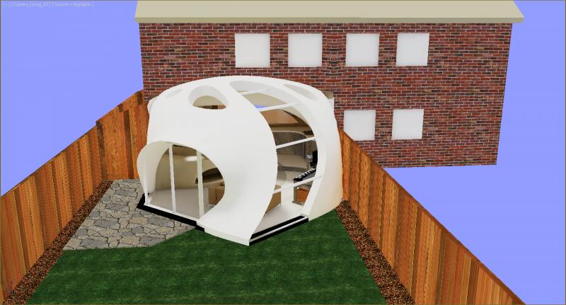

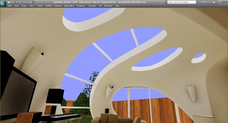

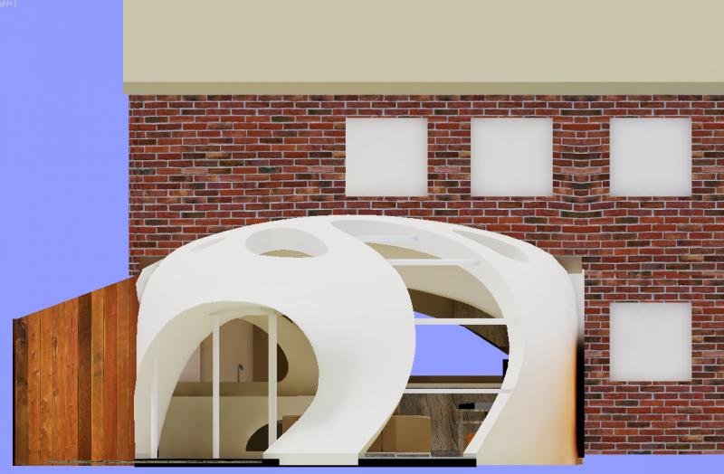

I'm planning an extension which i hope to do as a part self build project. Its very ambitious and involves the fabrication of custom shaped window frames. Does any one know any companies that fabricate custom shaped windows? They are very irregular shapes as illustrated in the attached images and will need to be double glazed, (but are however intended to use flat panels of glass not curved, as this may be slightly unclear in the images)
Are the windows in metal rather than timber? I would suspect so. Honestly I think you would be better off contacting metal fabricators as your first port of call. Try googling any in your area or even the good old yellow pages. We hd circular port hole type of window put into my parents house so shaped , but flat , windows should be possible from any decent double glazing company. Won't be cheap mind.
All that aside what is the building constructed of and do you have planning permission for such an extentsion on what looks like a very conventional house?

Thanks for the advice. I'm open to any suggestions for the window frame material. probably what ever is cheapest. I'll do as you suggest and contact some local metal fabricators. The building is planned to be constructed from ferrocement (building method popular on continent and USA but rare here. involves a metal wire mesh and rebar structure with impregnated ferrocemnet over the top)
In terms of planning I've had an initial consultation with the planners. Apparently as it's in a back garden and not visible by the general public the only real issue is neighbours and shadow, which is okay as far as i can tell as both neighbours have just built extensions (recently, so they are still grateful for me not making a fuss :) ) They said there would have been a problem with a lack of visual compatibility with the rest of the street (materials/shape) , but as it can't be seen from the road this shouldn't be a problem. Structural planning guy said it looked very solid and should be fine (ferrocement curvilinear structures are used to build bomb shelters apparently! so no danger of it being unstable) They just suggested i do some tests on water run off for the full application. They also said the construction of window frames would be by far the biggest challenge.

more likely to be the quote that is just under 70k as opposed to just over
the problem is you have 12-15 windows none with strait edges no 2 the same so every component has to be specially made
i simply don't know the costs but wouldn't be surprised if i have guessed a bit low
i have the feeling you where expecting less than 10k this will never happen in my opinion but it is only my opinion
the point i am making is do your homework before you build otherwise your stuffed
simplifying your curves or standardizing several components will bring it down
until you get a hard fast quote don't do anything
