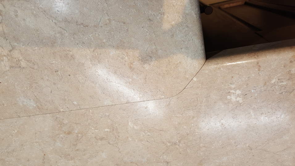

Aye, cheers for that. One (hopefully final!) question - it's an L-shaped worktop, so I'm going to have a join.
If this pic comes out OK, you can see the existing one has been sawn or machined to fit - I'm not very enthusiastic about those kind of aluminium joining strips you get, but is it going to be possible for me to replicate what I have now with a Black & Decker jigsaw, or am I being unrealistic?
Thanks again :D
On the upside, it should be possible to hire a 1/2in plunge router, 30mm guide bush and worktop jig from a local tool hire place (check the jig for aný nicks in the edges and reject unless it is spot on). Get some decent 1/2in diameter cutters (e.g. Trend, Faithfull, etc) and use one cutter for every 2 joints.
You may also need a circular saw with a fine tooth blade, a straight edge and a couple of cramps to cut the worktop to approximate length as well as at least three trestle (to make your cuts on) and finally a fine, single cut file (8 or 10in/200 or 250mm) to finish the end laminates. Most "dog bone" worktop joiners will require a 10mm open ended wrench (a pair of pliers or a combi wrench won't do)
