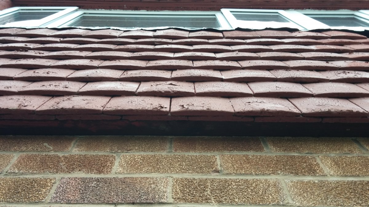

Hi people
I have had a few fascia tiles fall off the front of my property and I cant seem to find them anywhere to buy.
They have a kind of arched face and I have'nt a clue what they are called so I was wondering if anyone could help?
pic included
Regards
Well whatever colour you find them they won't match the colour as I believe the colour you have is PikeyPaint.
If the missing tiles are on the front you'll have to use painted ones from the back and put the replacements there.
possibly acme double camber plain tile.. easy to get colour as the others have said
They are hanging tiles, which are different to roof tiles. So make sure to ask for hanging tiles.
Actually tiles used on the roof and tiles used vertically are exactly the same. The only difference is vertically they are all mechanically fixed (nailed)
They are Acme double camber plain roof tiles. made of clay and readily available.
