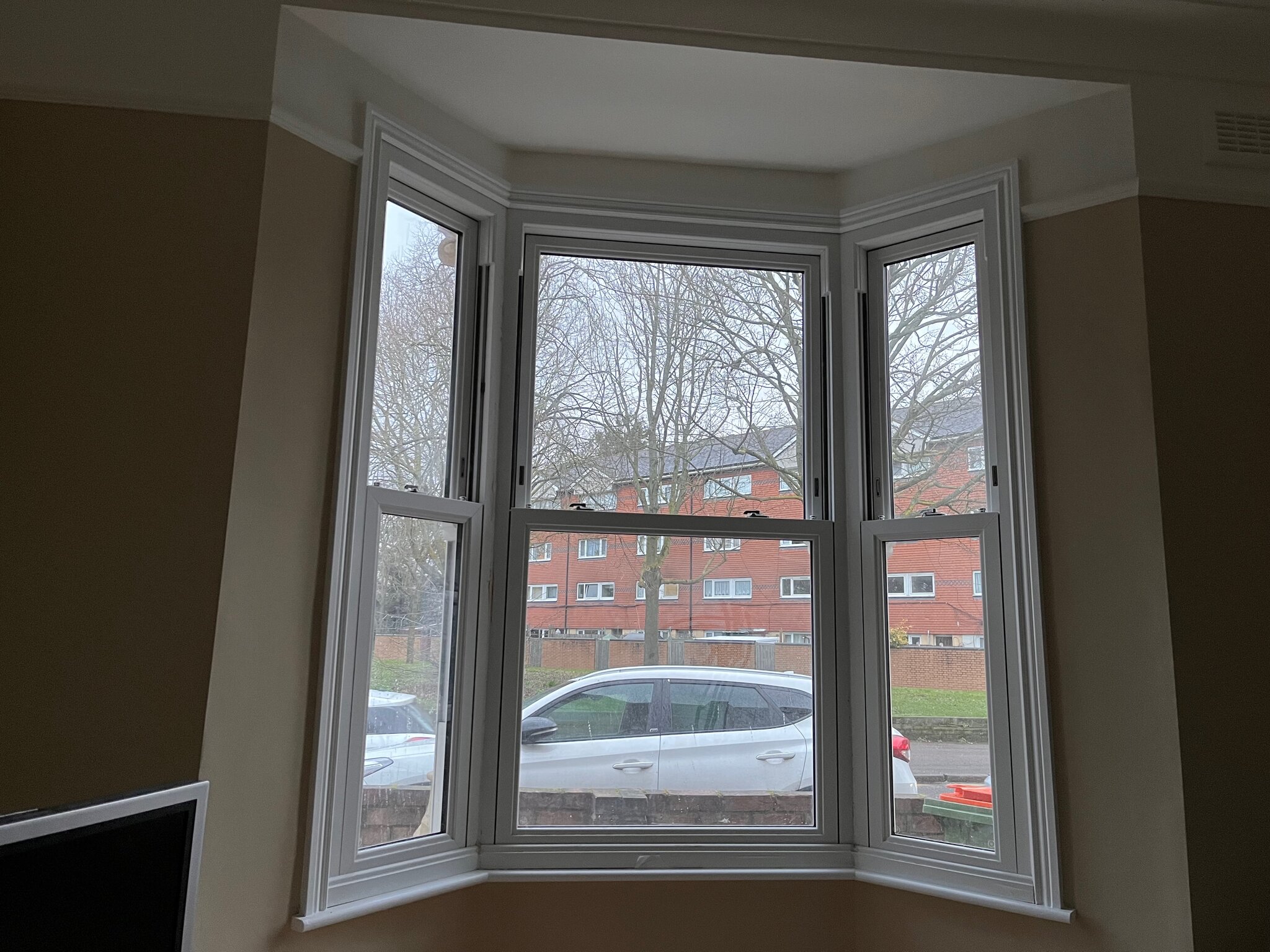

Hi. I'm measuring up for blinds to fit on an angled bay window. The window is uPVC and I don't want to drill into the uPVC. The blinds I've chosen are 50mm wooden venetian blinds.

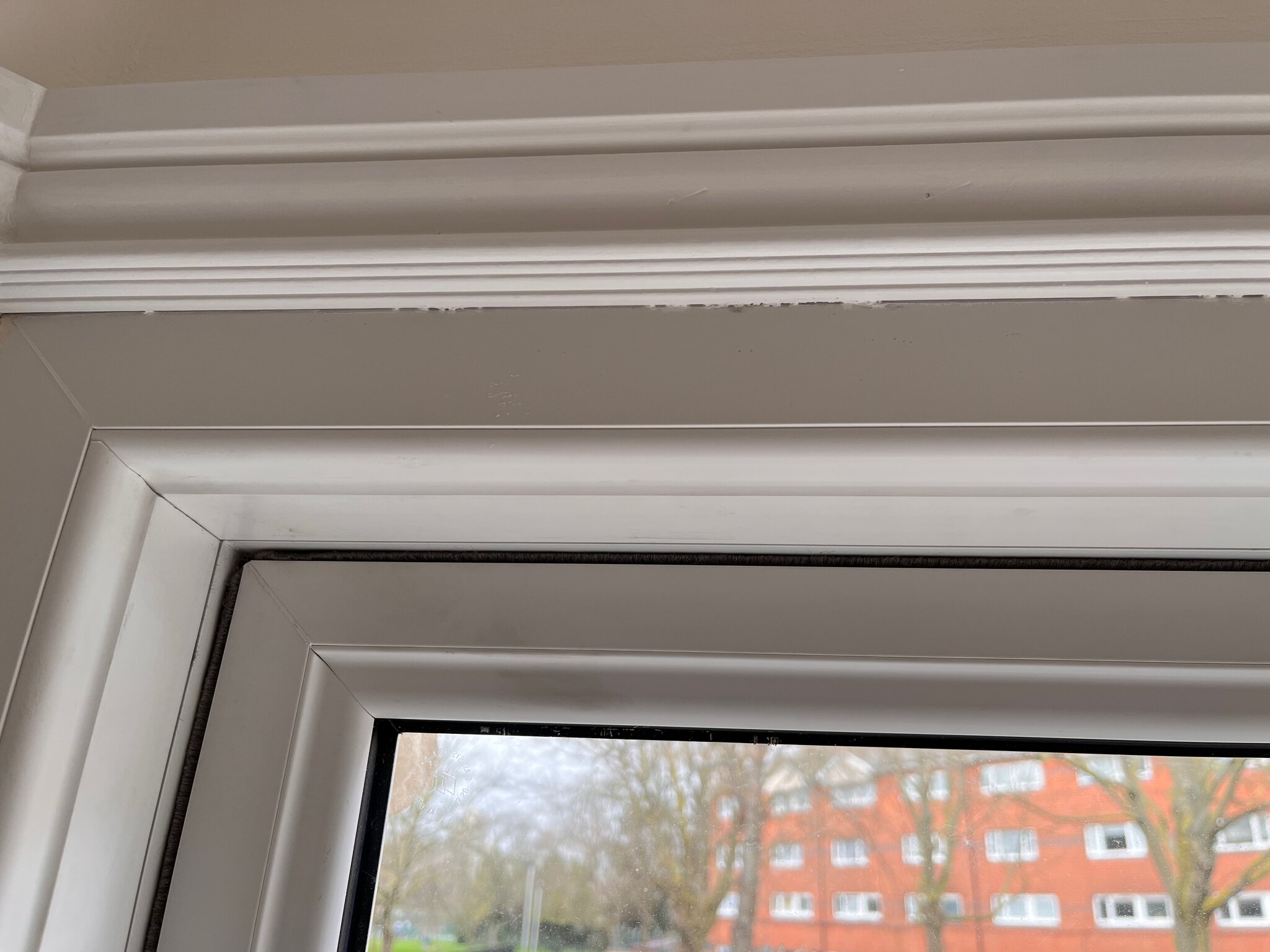

I think screwing the headrail to the wall above the architrave might be too high and look odd. So I'm thinking of screwing the headrail to the architrave itself. I think I'd have to pack it out to turn it into a level surface, perhaps using a length of pine moulding or something that compensates for where the architrave is indented. I might have to add an extra strip of timber over the top anyway, to add enough depth for the blinds to clear the sash lifts (I haven't fitted the sash lifts yet, which is why they're missing in the below pictures).
I measured the width of the blind for the centre window using the blind manufacturer's instructions, allowing space for it to clear the sash lifts without getting in the way of the blinds on the left and right windows.
I thought I would make the left and right blinds slightly wider so that they overlap the architrave a little bit. That would reduce the light leaking around the edges and it would also allow a bit of leeway in case, when I hang them, it looks better to budge them slightly closer to the centre blind.
Does that sound right? I'm just wondering if there's a standard way of doing this.
See below pictures of the window, a version marked up with where I'm thinking of fitting the blinds and a closer view of the architrave.
Grateful for any advice. Thanks.
This is where I thought I would fit the blinds:
Here's a closer picture of the architrave, to show where the uPVC window frame ends and the MDF architrave starts:

Take your time measuring up. You don't want to find that the middle blind is so wide that when you open each of the blinds they clash/hit each other. A 50mm blind will require a bigger gap than, for example, a 25mm blind.
The following kinda explains it but not very comphrensively.
Your suggested fitting points look OK but I have no way of knowing if they just used grab adhesive to hold the architrave. It might be prudent to use some nylon plugs and screws behind the blind mounting plates and fix the architraves to the brickwork (assuming that the bay is brick).
If you hang the blinds on the archs which stand away from the windows, the gap between the blinds at the angle in relation to the window frame has to be even bigger to avoid the inner corners of the blinds clashing. Draw it to scale in plan view from the top with 50mm blinds and you'll see. Personally I would have gone with 25mm blinds as you can close them together tighter at the angle without them clashing, and you'll get less light leak.
