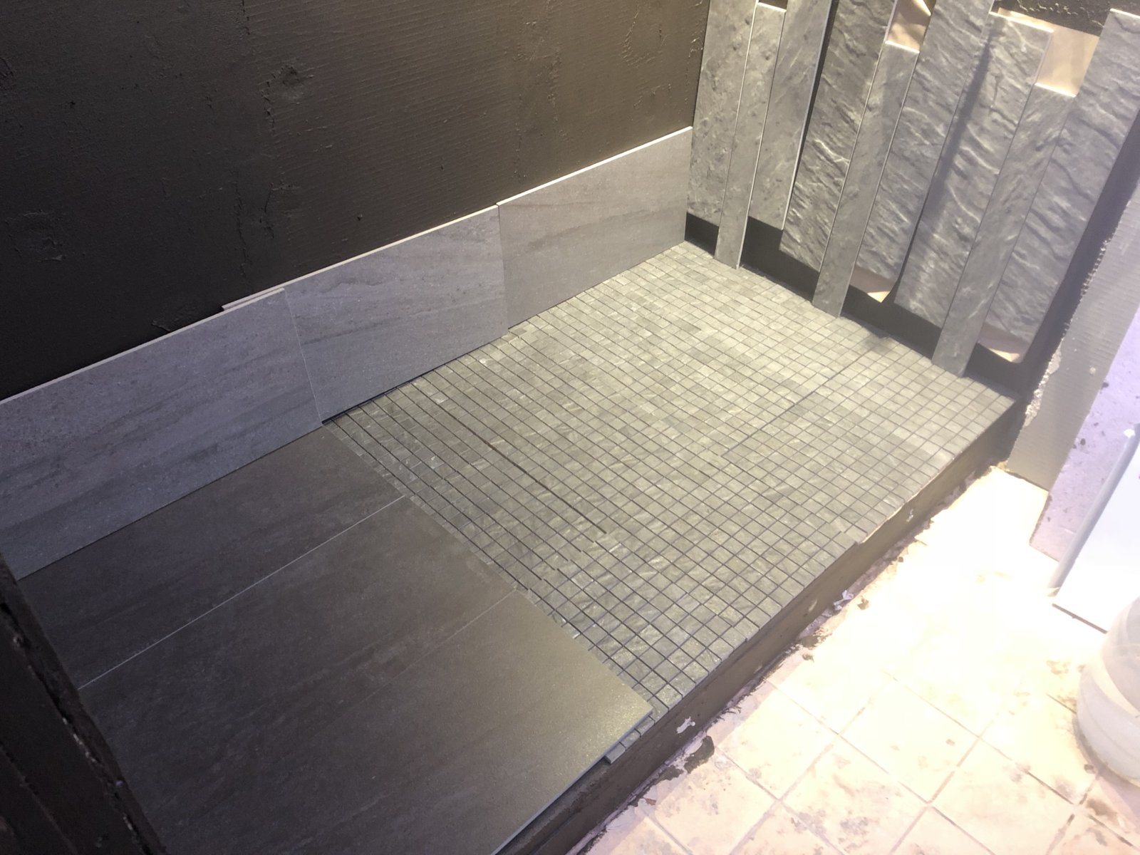

Hi,
I'm renovating my bathroom at the moment, lots of work already done and I'm about to start tiling the shower area tomorrow.
I was planning on starting on the back wall first (the biggest wall) then follow round at the same height on the joining walls, then the floor - but one of the walls has a rough/raised tile finish so wondering if that makes a difference on where to start - the base is a mosaic.
Any advice?
The walls are all tanked with Jackoboard and Ardex water proofing system.
Mark

Difficult to keep clean of spilt adhesive I know but I would start with the floor and tile down on to it, you will get a better joint/seal around the bottom that way.
Covering the floor tiles with cardboard should help keep them clear of spills during tiling the walls.
