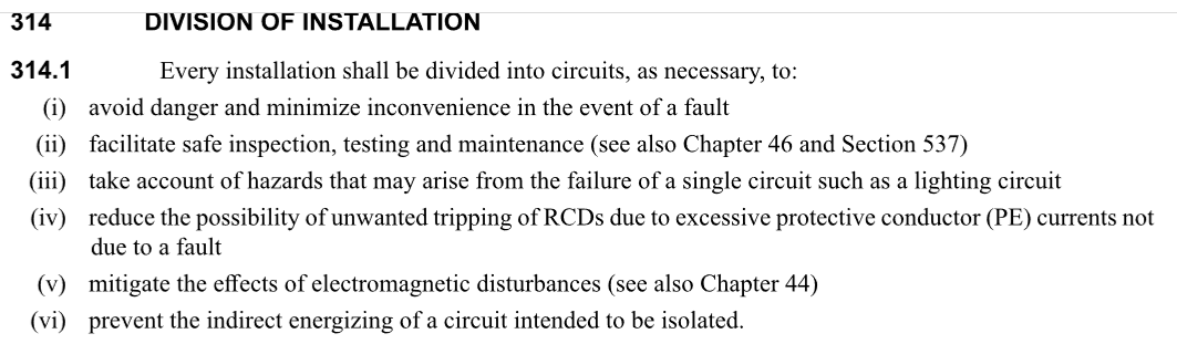

It's 314.2(iii) which is usually the bit which has the widest range of interpretations, and readers are only asked to "take account of hazards that may arise from the failure of a single circuit such as a lighting circuit" - and you'd probably be hard-pressed to find two people who assessed "hazards that may arise" in the same way and/or "took them into account" in the same way!
I posted the full regulation. There is no 314.2 (iii)!
No mars bar this time, you lose.
Apologies. Although I followed you in writing 314.2, I was actually talking about 314 in general (which is all about "Division of Installation") - and that led to my typo, since what I was referring to was actually 314.1(iii) - which, at least here, seems to be the most hotly debated (argued about) part of 314.
It's quite clear to me.

314.1 (iii) such as a lighting circuit.
Just an example, there are many others which could be listed..
(i)..minimise inconvenience.
It's very inconvenient, if your fridge, or freezer circuit develops a fault, when that circuit is a shared one which includes much of the house. For the normal householder, it becomes a very real problem, if the circuit will not reset, and they have to wait a week to get an electrician to attend, and just hope they have the skills to find the issue.
