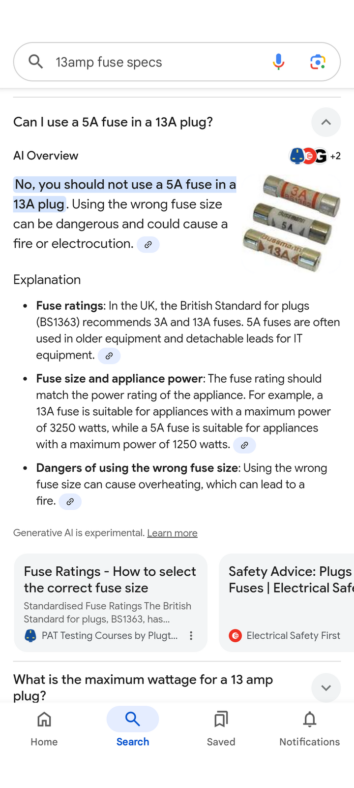

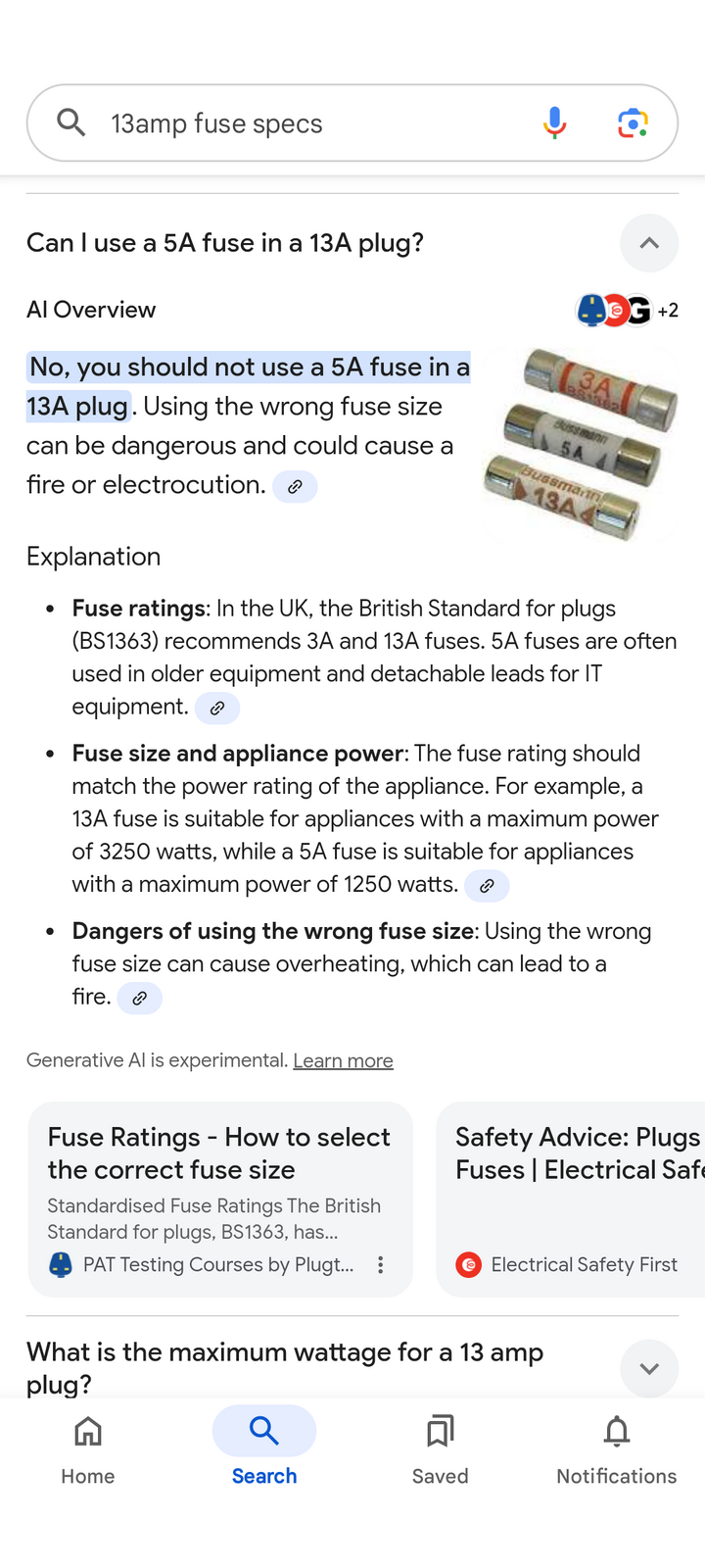

One of the responses to the "Strange Socket In Hospital" thread prompted me to search for the specs of 13 amp fuses.
One of the suggested questions was
"Can I use a 5A fuse in a 13A plug?"
With the AI Overview saying it is dangerous to use a lower ampage fuse.
Does anyone know how accurate the AI response is?
"No, you should not use a 5A fuse in a 13A plug. Using the wrong fuse size can be dangerous
No, you should not use a 5A fuse in a 13A plug. Using the wrong fuse size can be dangerous and could cause a fire or electrocution."

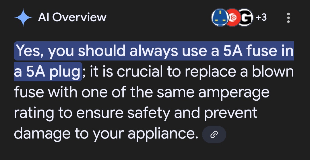

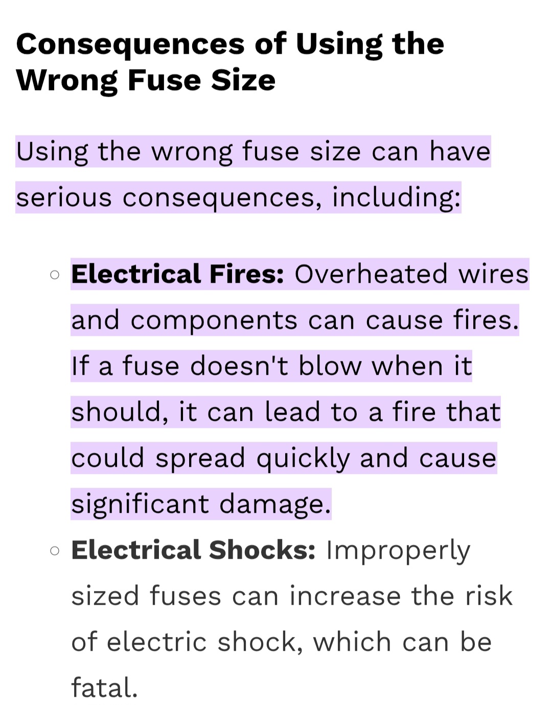

Using the wrong size fuse can be dangerous, but so can taking notice of AI answers like you shared.
The fuse should be the correct size for the appliance and the flex supplying it whether that be 2, 3, 5, 7, 10 or 13 amps.
If you click on the chain icons within the answer, it takes you to the webpage, and highlights the text that it gains it's citation from i.e.
The AI has interpreted your question as literally using a fuse that is the wrong size (it's 5A when it should be 13A) - as its sources don't differentiate the fact that a lower size fuse may be safer, the AI can't make that judgement.
