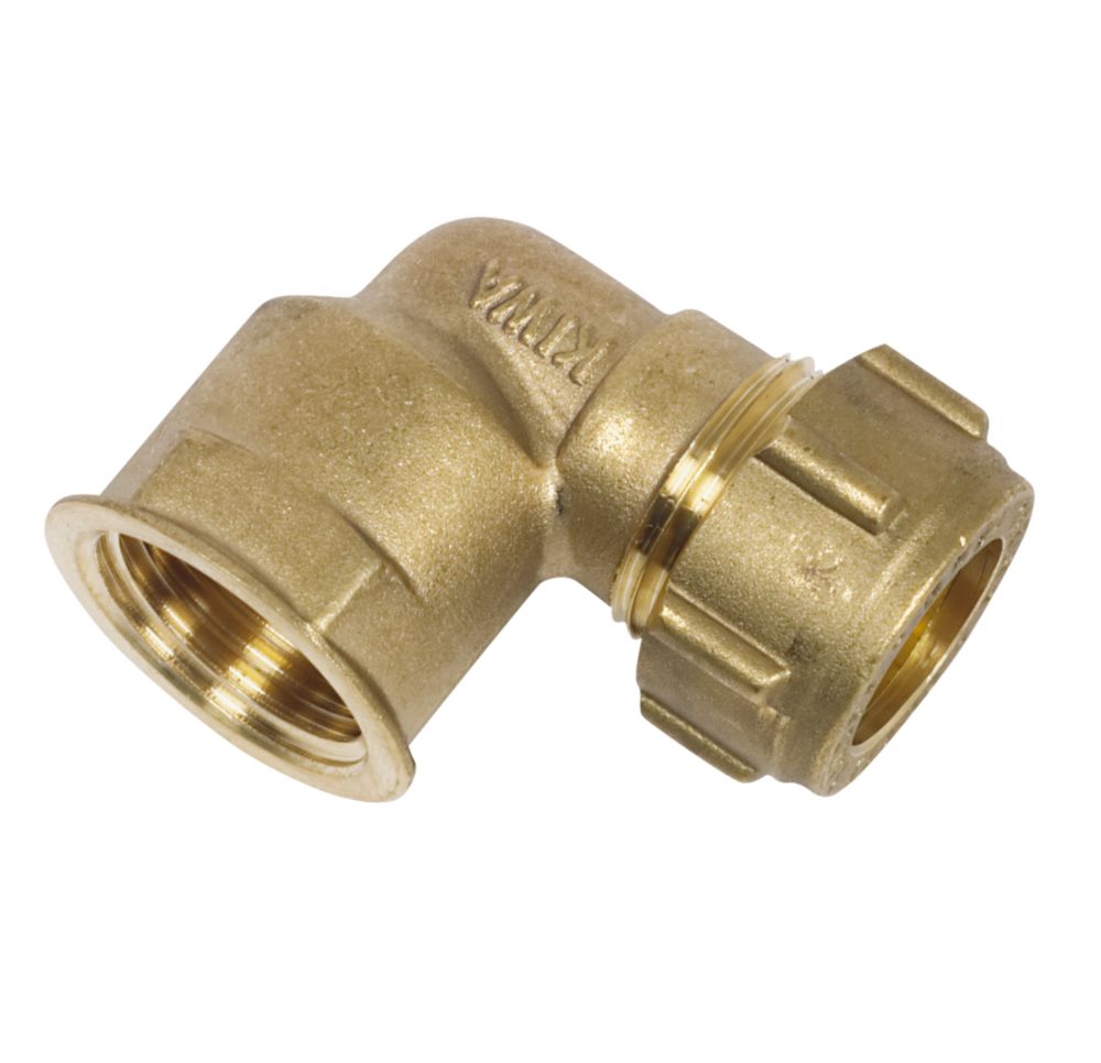

Anyone know if a nut splitter will chop through a 15mm valve nut (the old ribbed variety**) without damaging the copper pipe?
(** like the one on the right here).
