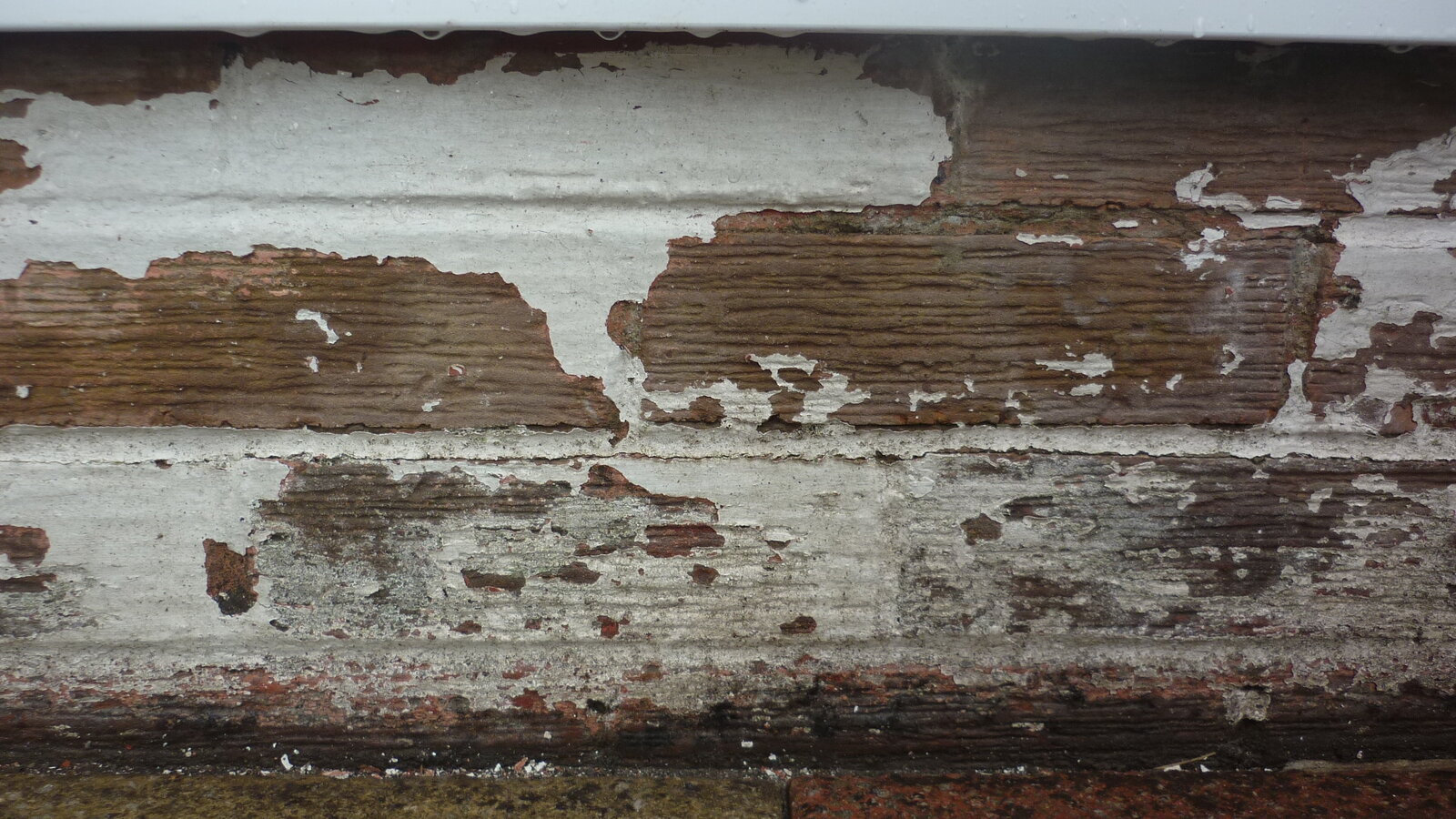

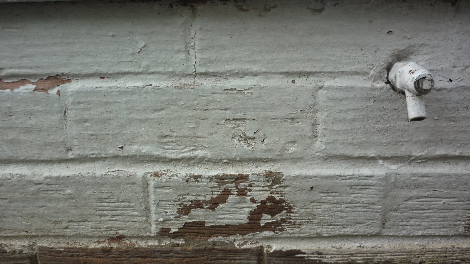

Sincere apologies to everyone for the delay in replying. Have been 'working all the hours' since the attached photos. Thanks are due to Wayners for the detailed reply. The white-painted bricks are between the bottom edge of the roughcasting and the slabs/borders.
1) The white paint is an eyesore. I have scraped and wire-brushed it but it's still stuck to the brickwork. See pics.

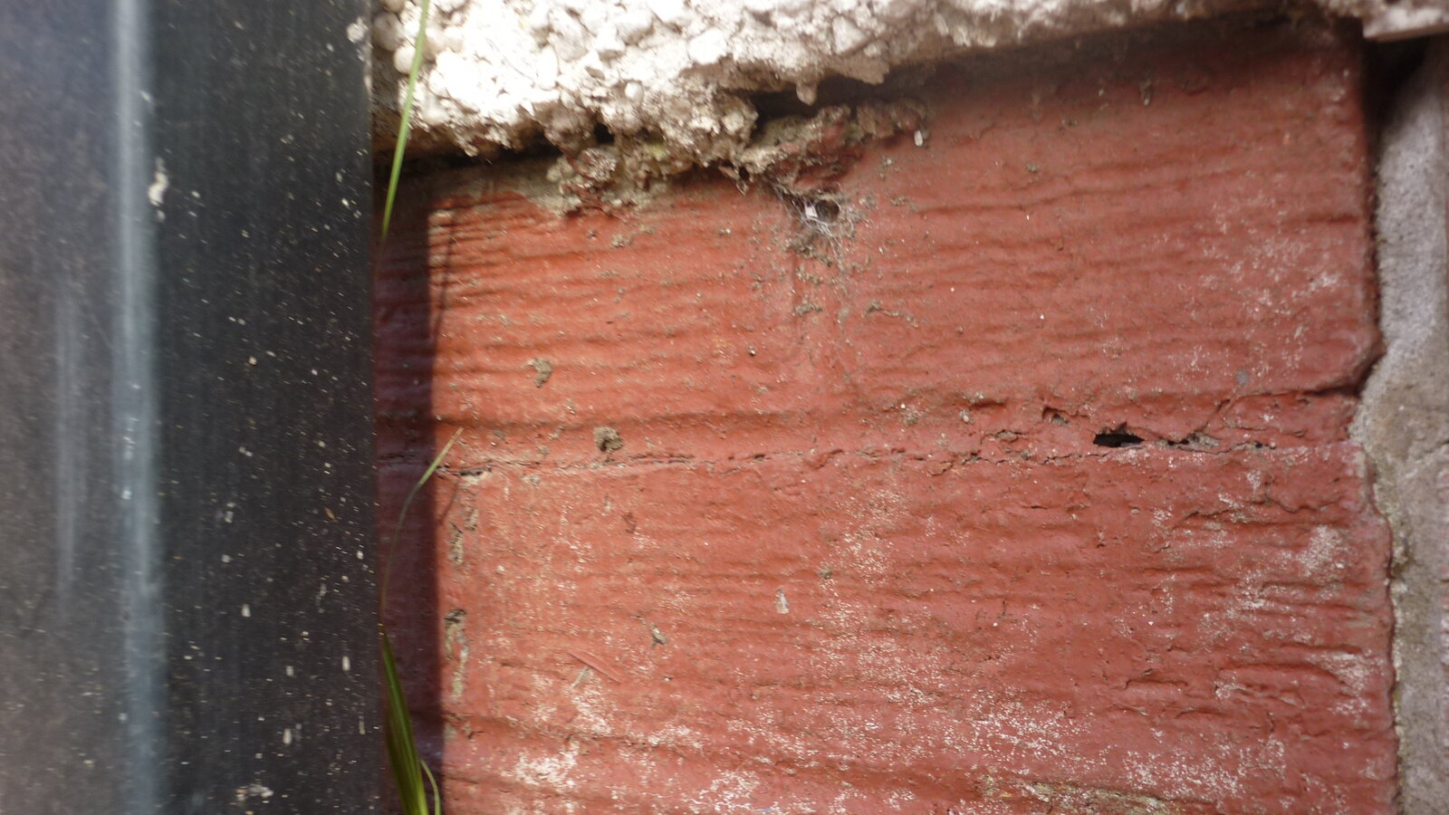

4) Can anyone suggest the shade to use to match to my neighbour's red-painted bricks (retired, doesn't know the paint that was used - see pic).

I have looked very closely for the DPC. As far as I can see, the DPC is located at soil/slab level, below the white-painted brickwork. IMO, it should never have been painted at all but the previous owner couldn't 'leave alone'. Now there is flaking/peeling/dirty white paintwork below the roughcasting.
Once the DPC has been firmly established, I'd clean/scrape off as much paint/coating below the DPC as possible and then if still looking tatty, coat with a bitumen-based product such as Synthaprufe and then allow ample drying time before painting to match the rest of the wall. If you have some fine dry sand, blinding the still wet final coat of Synthaprufe will give added key for the paint when fully set and dry.
Unfortunately, decorating below the DPC will all too often lead to future troubles. My house is pebble dashed and painted down to the DPC and then an angle-drip was installed (by me) before smooth plain render applied below the drip, which is not decorated.
Is the white paint an eyesore because you don't like the colour or because of its condition?
What I'm thinking is if you paint it red, the old paint could still flake off and you will get white flecks.
Whether is an eyesore or not, standard external paint should not be used below the DPC on an untreated wall.
Thank you very much Scally-Ho, accelerator, and Wayners, and apologies for the delay in replying (have been working non-stop). I will ask for a second opinion on the level of the DPC before proceeding. Also, that's a good point about the (new) red paint flaking off and old white paint showing through - I will give this some further thought.
