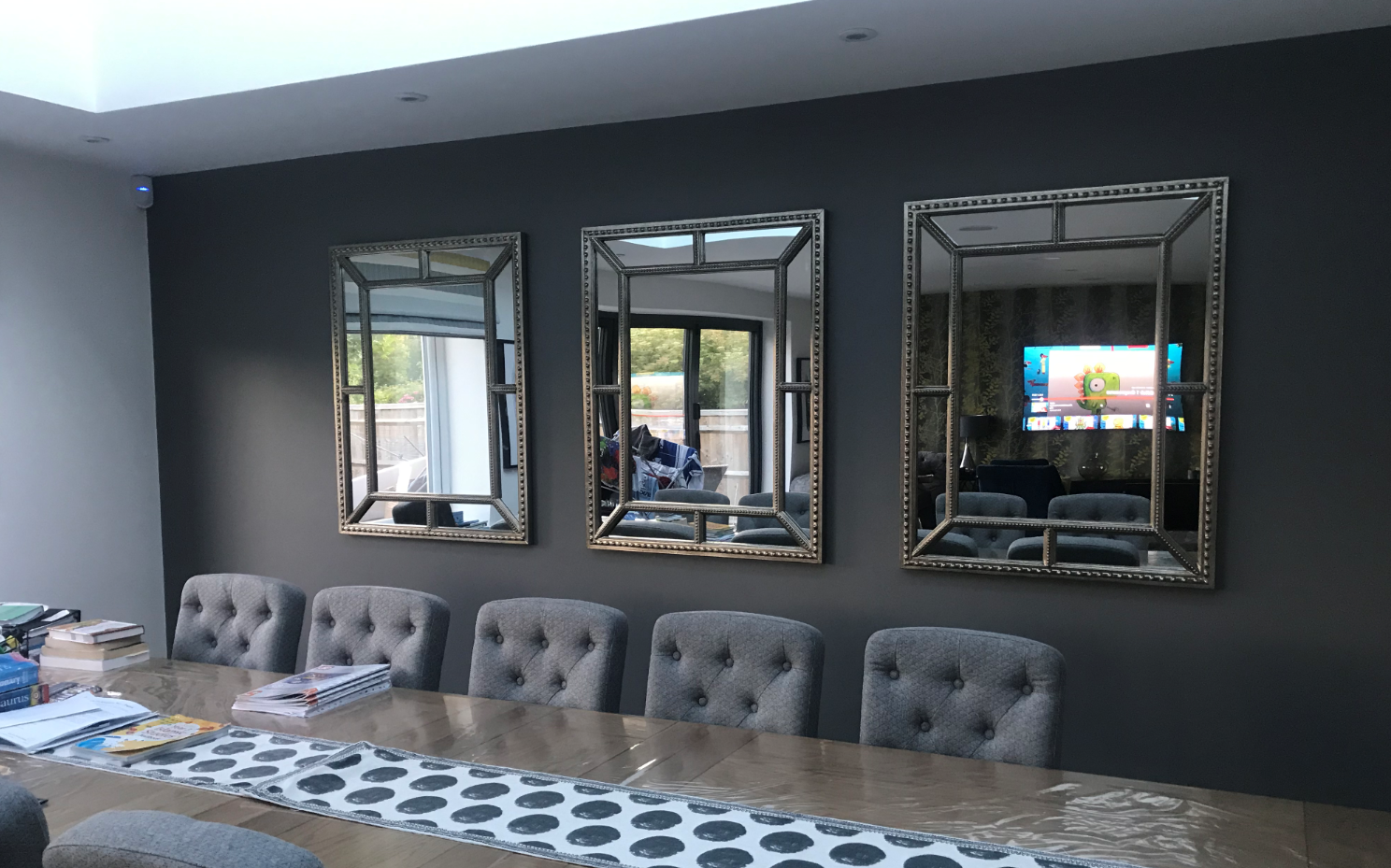

I have a wall with 25mm cellotex backed plasterboards dot and dabbed on to a wall constructed from concrete blocks. I want to hang a mirror on this. The mirror weighs 10kg.

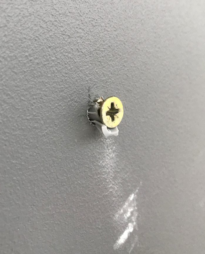

UPDATE: I tried the method of drilling a hole through the insulated boards and then the concrete block. I then hammered a rawlplug home before screwing a 70mm screw into this. I found that the screw had some flex on the plaster end. Probably because I hammered a rawl plug through and the outer flange of his may have widened the hole.
I initially resorted to packing this by squeezing some bits of a cut rawlplug in this void:

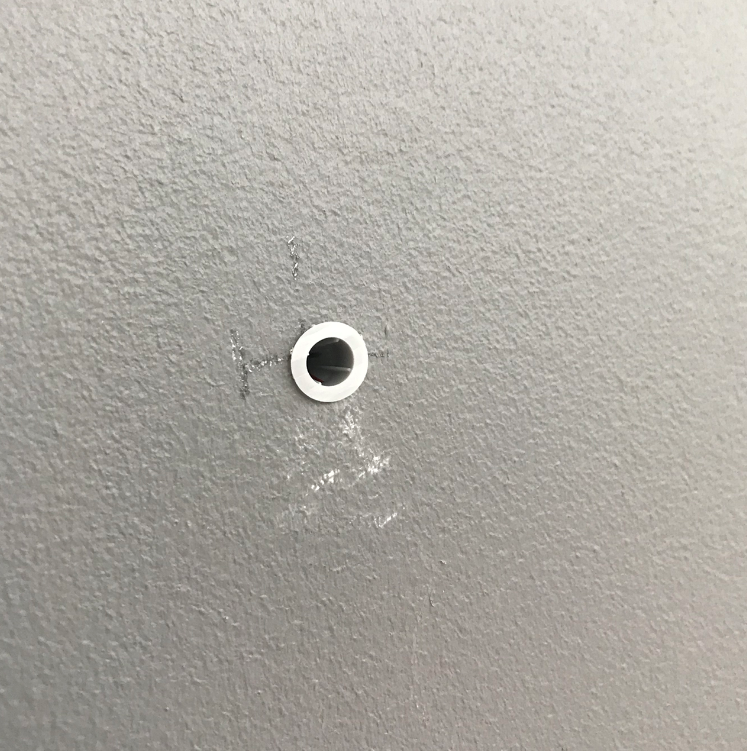

I then cut the bottom of a second rawlplug and pushed this into the plasterboard. The screw went through this and then the rawlplug that was hammered home into the block. This provided a nice snug fit for the screw:
and my finished project:
Thanks for all the advice.
