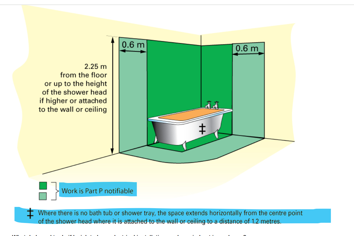

I'm looking at getting a bathroom cabinet with a demister and internal shaving socket that's rated IP44. I know it's all notifiable but I don't want to waste money on a powered one if I can't use it.
It would be in a 1.8m square wetroom, no screen, no shower tray, just tiles. I think in those circumstances, that Zone 0 and Zone 1 both extend as a 1.2m radius from the source - presumably the shower head - with Zone 0 up to 10cm from the ground, and Zone 1 between 10 and 225cm.
The cabinet is 50cm wide and would be on the same wall as the shower head, its right hand edge being approximately 1m away from the shower head. I've read that IP44 can be used in Zone 1 (although IP65 is recommended). If so, then I think it's okay, but out of interest, if it wasn't, would the entire cabinet have to be outside the zone, just the cable inlet point, or something else.

I think it's fair to say that the 'zoning' rules only apply to electrical items (switches, sockets, equipment etc.) - so I don't think that a structure which happened to house/contain them would be of any relevance. However, others may disagree!

It it is within a 'Zone', then it would be notifiable. Were it not within a zone, it would only be notifiable if it were a 'new circuit' (rather thn an 'extension' of an existing one).
Thanks. So just so I'm understand correctly, extensions of existing circuits are not notifiable, but new circuits are i.e. ones that have a new connection to the CU. But because it's in a Zone, the Zone rules apply.
Looking at this, Competent Person Scheme am I reading it right ? That if an addition to a circuit is beyond 1.2m radius, then it isn't notifiable? So if the shaving socket inside the cabinet is on the right hand side of the cabinet, it would be notifiable because it's within 1.2m of the shower head, but if it was on the left hand side, it would be beyond 1.2m and therefore not notifiable?! Or do you also look at the light/demister positions?
I read that when doing mother's wet room, the problem was the shower head was not fixed. Asked building inspector, and he said 1.2 meters from where the head could be held. So with a 1-meter-long hose, that 2.2 meters. So in your case, the whole of wet room is zone 1.
