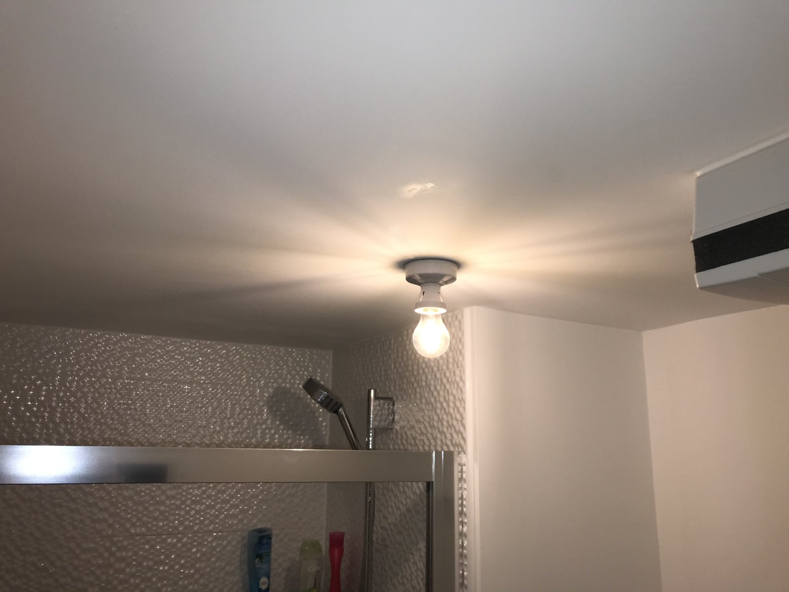

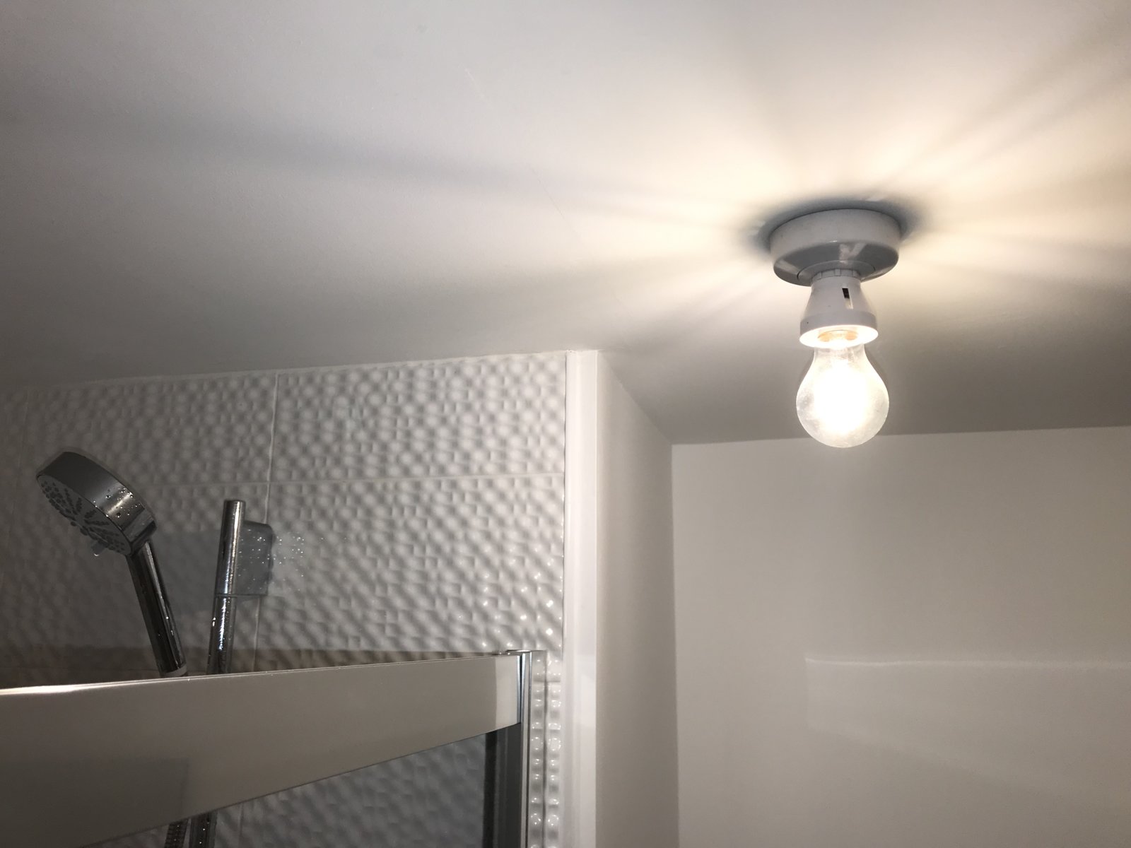

As title really, just wondering what bathroom zone this light fitting would be in?
998D7AEA-D996-4D22-8FB0-B24D6C14AB96.jpeg 13C5BD8C-4354-48DC-833B-AE5DF6D502C9.jpeg
Id say it’s less than 300mm from edge of shower.
Asking as my dad reckons its zone 2, and should be an IP44 light fitting. I say it’s no zone, as per this diagram:
Though how high is the ceiling.
The regs now seem a bit vague about zone 2 lighting but 701.512.2 states ipx4 for zone 2.
There used to be an exemption for skirted lampholders though.
Is the key- the special zones stop level with the highest of either fixed shower head/water outlet or 2250 above floor level (which seems silly to me, would make more sense if it was 2250 above highest bit of shower tray/shallowest end of bath but there we go). That ceiling looks lowish to me.....

For information only it's most likely in zone 2, where a minimum of IPX4 is required, that fitting will easily meet that requirement.
