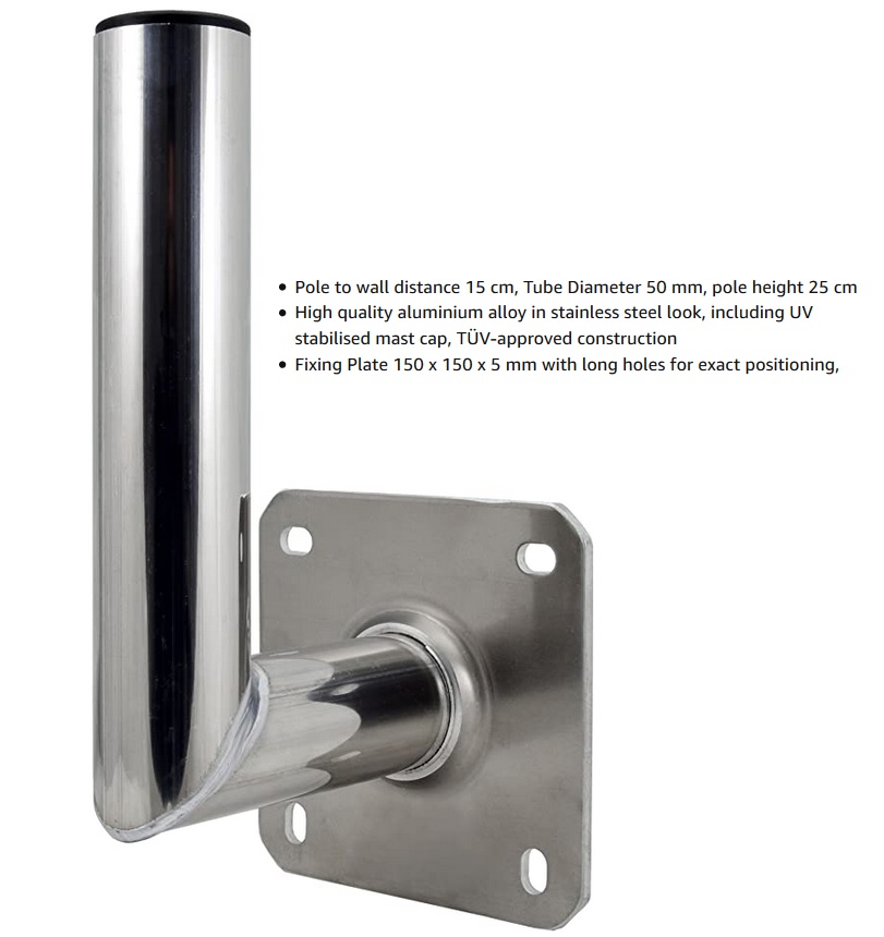

    Hi. When my wood-clad house was built, the builder put a block of wood behind a section of it so that a satellite dish could be put up. Said dish has rusted away so I'm starting from scratch and trying to be as corrosion-proof as possible. The bracket I want to put up is in the pic. The cladding is 2cm thick, the block of wood behind it 4.25cm.
    The original bracket was fixed with M8, 50cm hex-heads. But is that the best choice? The holes in the new bracket are 10mm and the M8 head only 12/13mm. I reckon I could maybe use a bigger head and longer thread...
    My thanks for any advice offered

    8mm screws or bolts are perfectly adequate for this - you could use 10mm but you'd have to be spot on with your drilling.
    How about stainless washers under the bolt heads?

    Thanks John. I was thinking of plastic/nylon washers, actually. I've been told that if you put stainless and aluminium together, you'll still get corrosion where they touch. Seems odd to a layman like myself but the world is full of weirdness...

    It's not that odd. Any two dissimilar metals plus moisture create an electro-chemical cell, leading to electrolytic corrosion.

    You can use stainless and aluminium together with no problem.....by the time corrosion sets in as an issue we'll all be long gone.
    There's a good chance the alloy bracket will be anodised, and aluminium oxide is remarkably stable anyway.

    Hi again. I've borrowed my mate's cordless drill (I've never used one before) but he doesn't have the attachment that allows you to drill in a hexhead coach screw. Once I've drilled the pilot holes, will it be simple enough to put the coach screws in with a socket wrench? Many thanks.

    Sure, a socket and ratchet bar will be just fine.

    Aluminium and stainless steel together especially in coastal regions results in severe galvanic corrosion, I seriously doubt it would survive long.
    https://www.wired.com/2011/06/shipbuilder-blames-navy-as-brand-new-warship-disintegrates/

    Awash with salt water, I’d agree completely but in real life, I’d doubt it.
    Road signs around here last quite well!

    Depends where you are I guess, here on the west coast it's a no no, due to the salty conditions.
