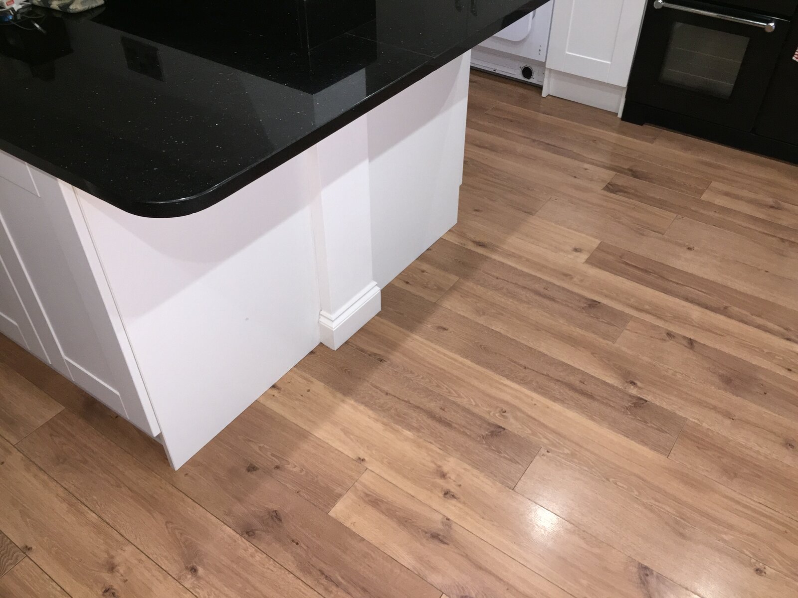

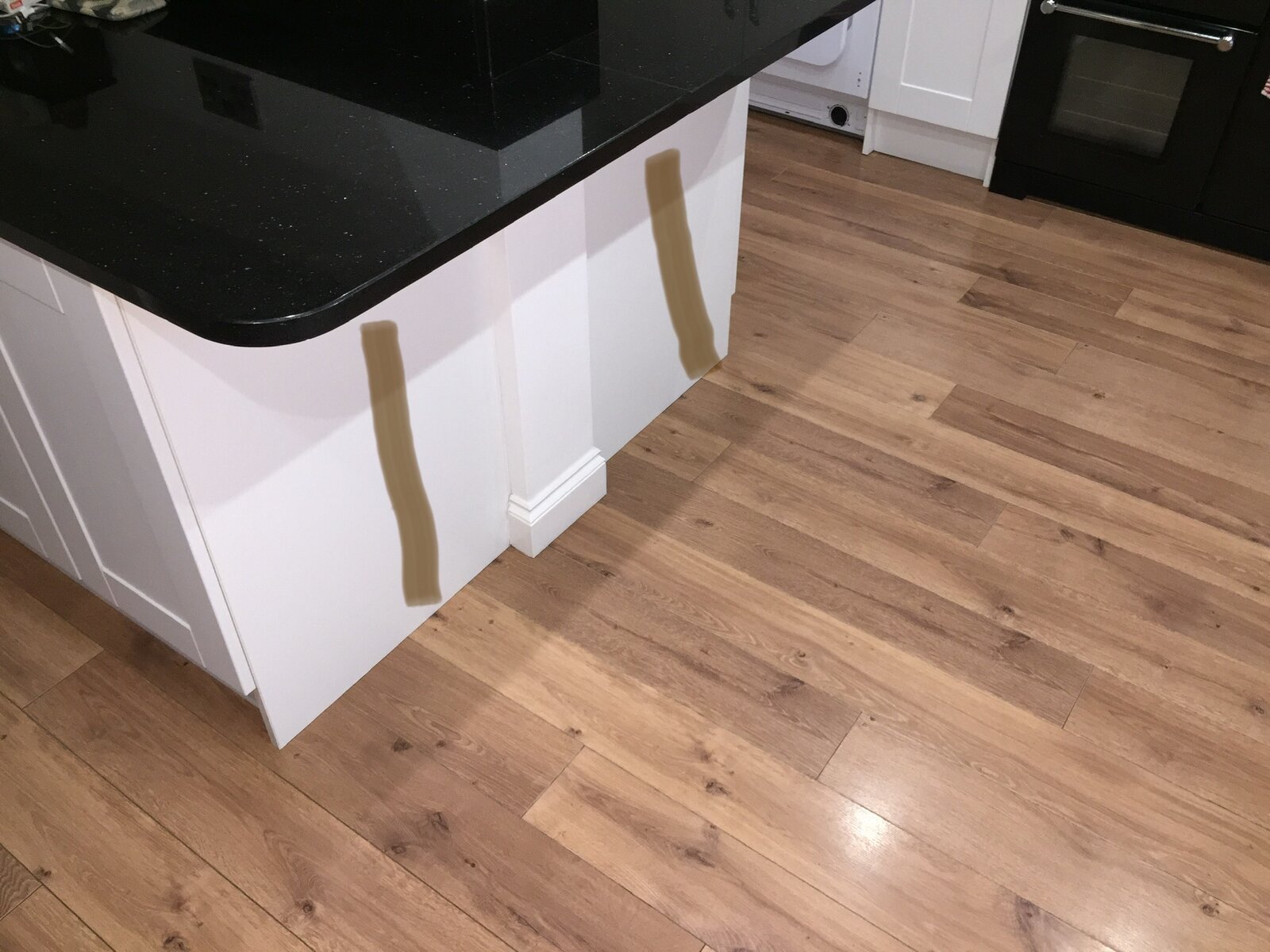

Yeah i’m not too sure how it’ll go either but worth a try. In a nutshell my kitchen is 11mx5 and all I have is a 300mmx1800 designer radiator and an plinth heater, i’ll be using the flexi’s from the plinth heater into copper pipe for the new radiator. I did want a mini stud wall built up and hang the radiator on that but due to Covid this is difficult atm so going the DIY route for now.
Below is a picture of where it’ll go, as it’ll be a 1200mm radiator it’ll be on both cabinets so the load will be spread (at least in my mind)

Ok, weight distribution wise you will probably be ok.

Personally, I wouldn't want to fit a radiator onto the side of a kitchen cabinet which may or may not be replaced 5 years (or less) down the line. If nothing else I'd be concerned about how well the cabinet was fixed to the wall.
What I have seen done is a blockwork pygmy wall built at one end of a run of kitchen units, which was pretty solid. An alternative that I've built on jobs in the past a couple of times was a timber studwork pygmy wall which was built around a couple of flanged steel posts (which were resin-anchored to the concrete floor) and faced off with 12mm plywood skinned with plasterboard. Looks like a conventional wall, can be put in faster, will carry a heavy rad as well

Just wondering... but would it be possible to use some end panels (with edging) and packing out, to span the width and height of the brackets and screw them to the ends of the units AND the wall? The down side is that you will push the radiator up to 36mm(18+18mm) away from the end of the units.
I hope that makes sense.
Out of interest, how far past the units does the wall jut out?

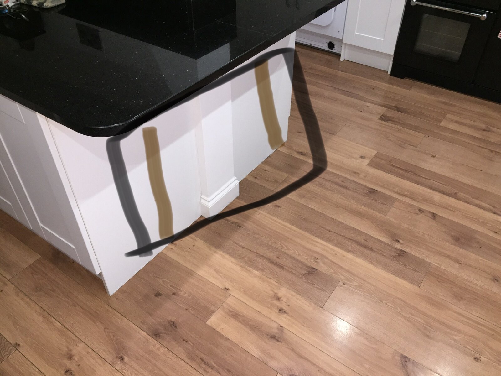

Yeah I understand but not sure how that would benefit me (may not be fully understanding you).
I’ll be using the 2x4 battens which will go from the floor to the top of the cabinets on both sides, well to be honest i’ll be doubling up, so one batten each side will be screwed from inside the cabinet to the batten, then another batten screwed on that so I can bring it out closer to the room rather than close to the unit.
Thinking of the weight now might be prudent not to have 2 battens screwed together as that might put more strain because of center of gravity.
The mini wall sticks out 4cm from the side of the unit
I see no issue with the weight or force, you might just want to strengthen the cabinet using some brackets between top rail and cabinet side.
I would also consider pulling the plinth off then putting some 4 x 2 on edge underneath the cabinet side and wedged up - so the weight is transferred directly to the floor not on the cabinet side to bottom screws or dowels.

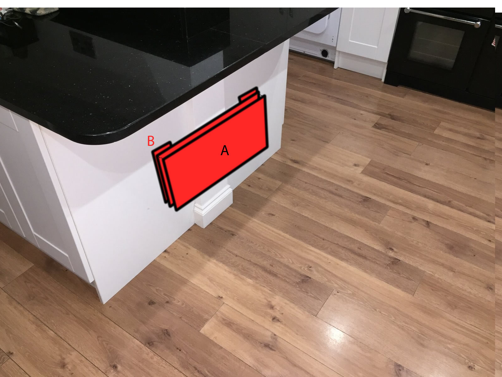

Oh.. I thought the batons were going to be inside the cabinets.
With regards to your second image. I am recommending that you pick up a new end panel and cut it so that it spans the width of your two brown lines (rad brackets). Lets call that part A. That end panel would be then screwed to the ends of the two units, however, because the wall juts out by 4 cm, your newly cut panel will be 4 cm away from the cabinets and require you to pack them out using off cuts from the rest of your newly purchased end panel. Two strips of end panel either side of the wall (parts B) plus 6mm packing pieces behind the cut to size part.
The advantage of the above is that you will then be able to screw the A/B combo from the inside of the cabinets (no visible screws when looking at A) and you will be able to screw through part A into the end of the wall (unfortunately two visible screws). You will now be distributing the weight/load of the rad throughout the cabinets and the wall.
When looked at from the side, yes you will see the A/B panel but it will be the same colour as the end of the units.
