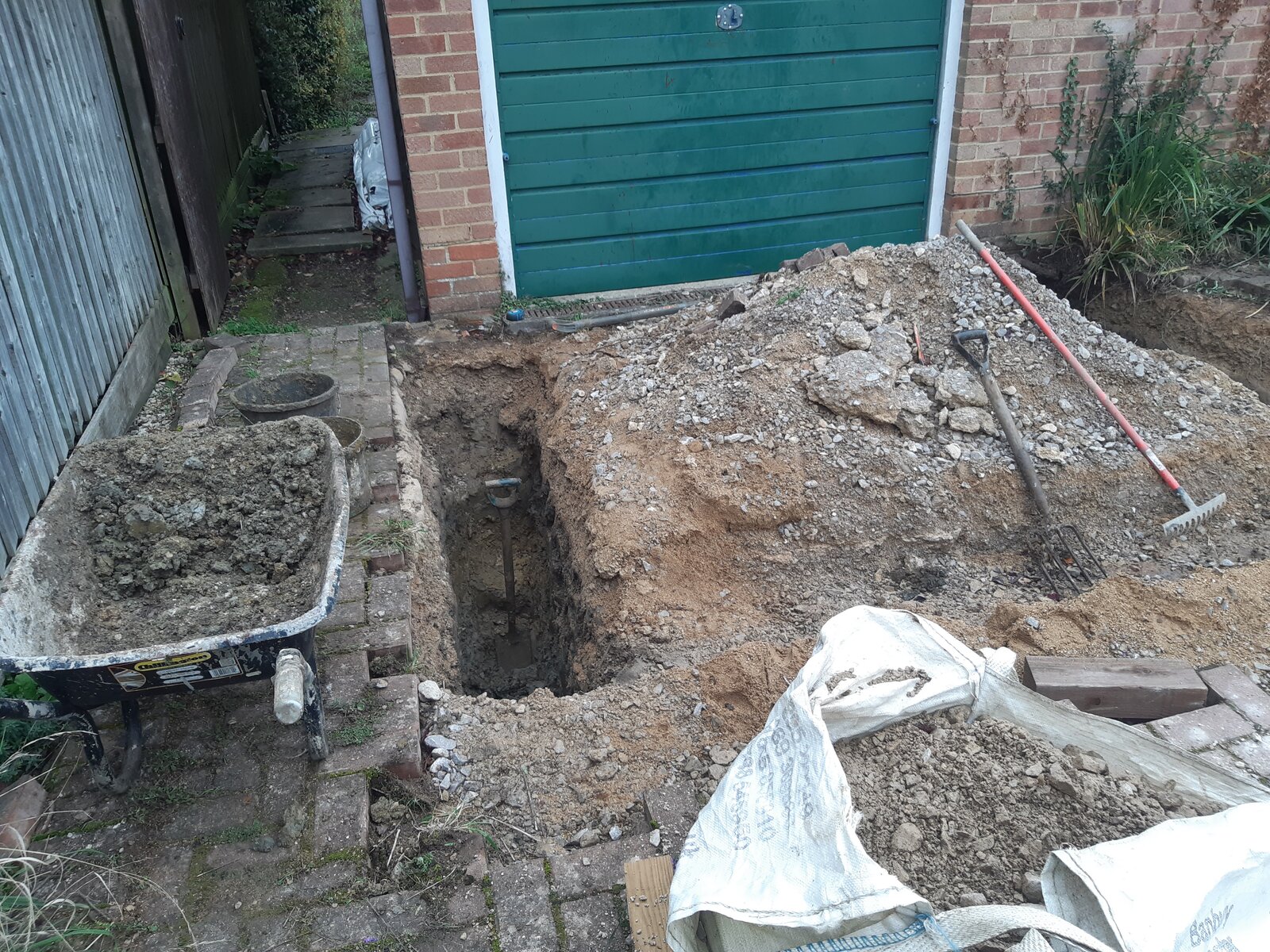

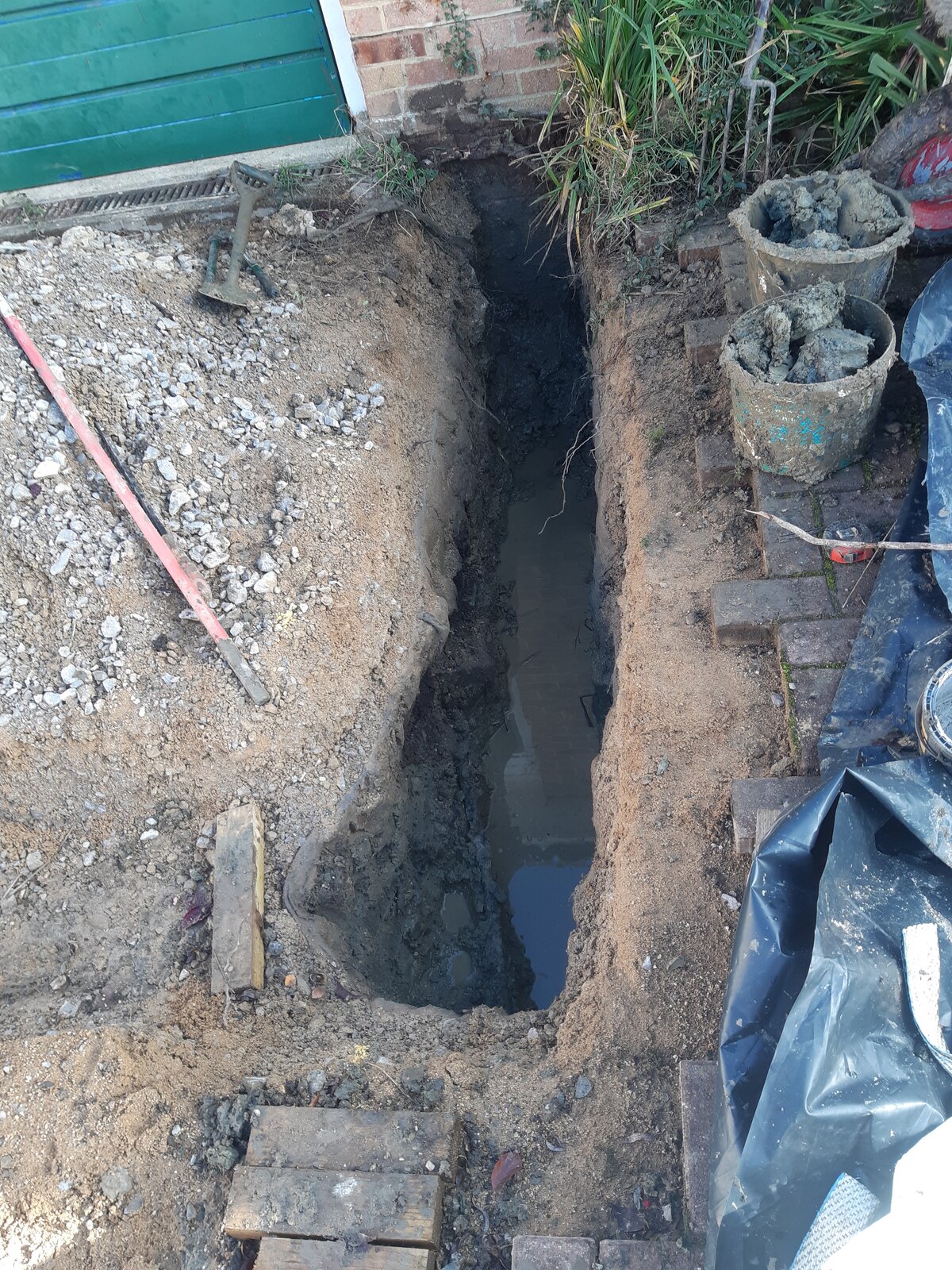

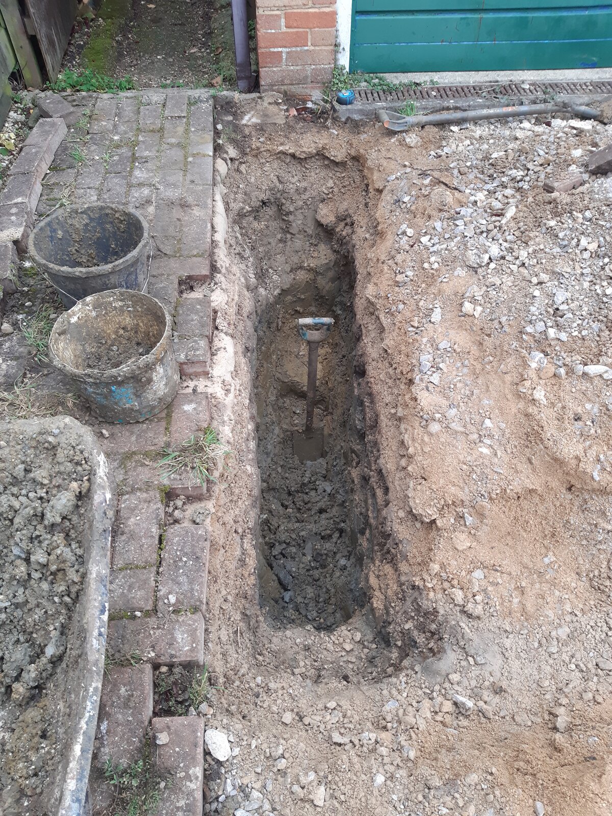

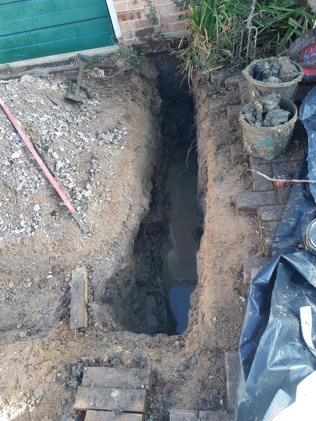

OK so we called them and they said they'd be there Monday. I dug the trench dug by hand as I didn't want the weight of the digger to mess up the block paving.
Does the trench sides need to be smooth? Slicing the mud off the sides makes me want a kebab

Sides should be more or less vertical and straight, with a consistent minimum width throughout. The bottom level, flat and not soft.
Thanks Woody. Unfortunately the trench keeps filling up with water so it's hard to get the bottom dry. I have some hard-core I could tamp into the bottom of the trench?
They need to check the depth, so adding anything is counter productive
