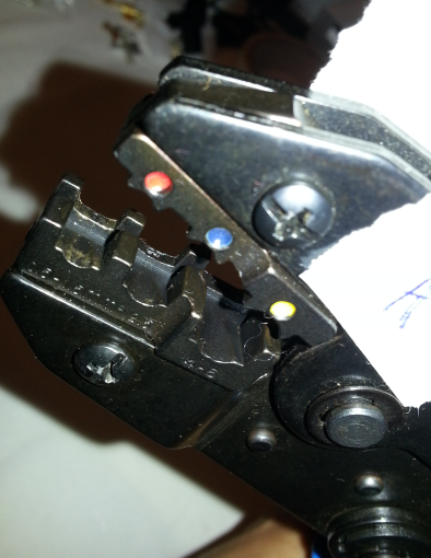

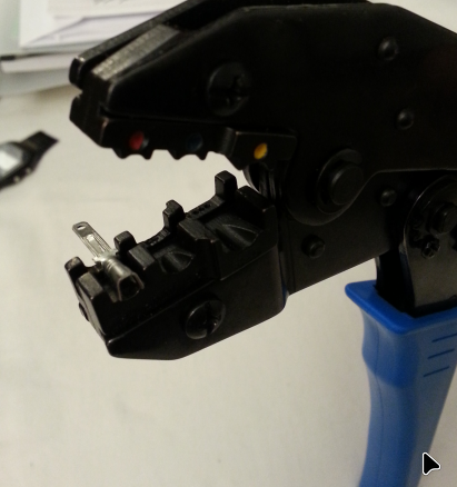

This is going to sound dafter than my usual questions. I bought these years ago, no instructions as far as I recall, and now i'm in a spot of automotive bother and need to use them in anger pronto.

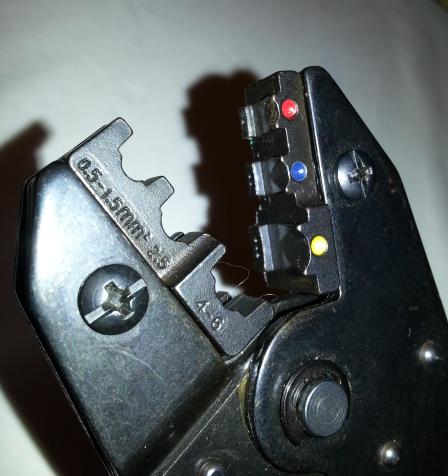

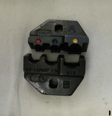

Pretty bog standard pair of ratcheting crimp tool. Let's call them side A,...showing the profile:
little grooves on both bottom
and top jaws

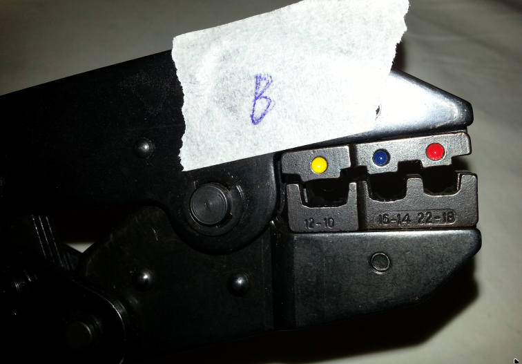

And side B
where the jaws are flat, but there's a little groove running close to this side.
Now from the youtube vids I've seen the tooth needs to go into the smooth side of the terminal connector. All of the terminals I have, whether bullet/spade/ring/whatever, all have the same set of prongs on the back- so the ones that go around the wire's insulation are taller than those which go around the exposed wire.

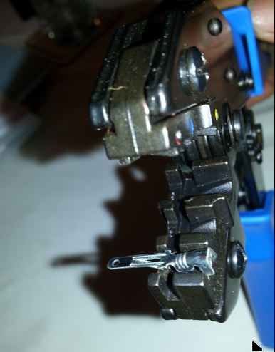

Now my best guess so far is this positioning (side A is on the right hand side of the image), with the view that the open prongs should face down on the groove so that it folds inwards.

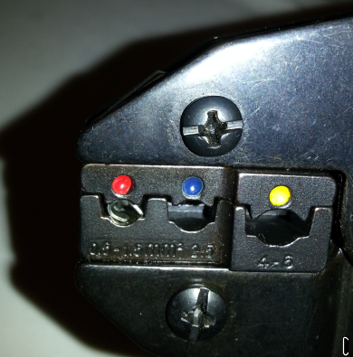

But that then results in two things happening every time i've done it. Firstly it's uneven:
Then the only prongs which are affected are the ones that go around the insulation. The ones that go around the wire itself are barely touched because of the shorter length.
Would be grateful for thoughts or doodles on the obvious thing that i'm not doing, or a pointer to a vid where they do it up close with this kind of crimping tool.
As above, you have the wrong crimping tool.
You need something like this one
I am not necessarily recommending the above though. That type simultaneously crimps both the wire and the insulation.
I found a German one on ebay for about £20, elsewhere it was about £40. A professional one (with replaceable dies) will set you back a lot more.
I don't have a lot of experience of crimping, but the type that crimps the insolation strikes me as being far more secure than using cheap insulated crimps with a diy crimper.
I haven't found the colour coded terminals very reliable. The plastic insulation is thick and hard and I don't find the connection is strong. It may slip out of position while working.
I rather favour a plain metal connector with the light cover in thin rubbery plastic that you can slide down the wire after crimping.
Thanks very much everyone that's very helpful. It didn't occur to me that the dies are specific to the type of crimp, but now I type it aloud is sounds like common sense....doh.
I think i'll need to do both insulated and non-insulated, as one end is spades going into a multi-terminal connector so non-insulated (at least insulated would be more of a faff to get in and out), and then at the other going for butt connector to join an ignition switch.
That said the dies in this come out, do you think I could just buy replacement dies? There isn't a name or serial number on the pliers but it doesn't look like a tight fit, they just locate on the screw holes. Or is that just a recipe for more paper weights.
