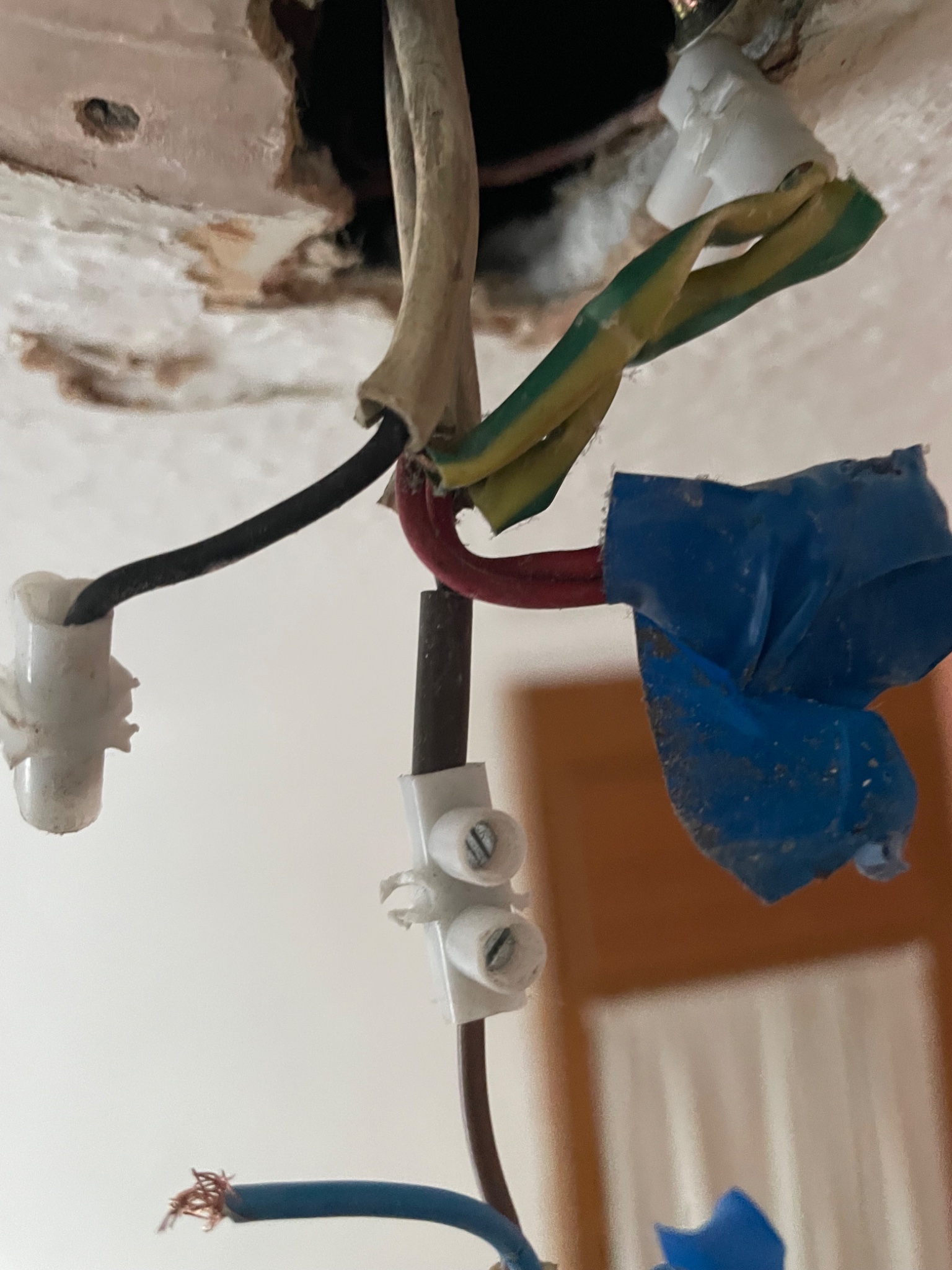

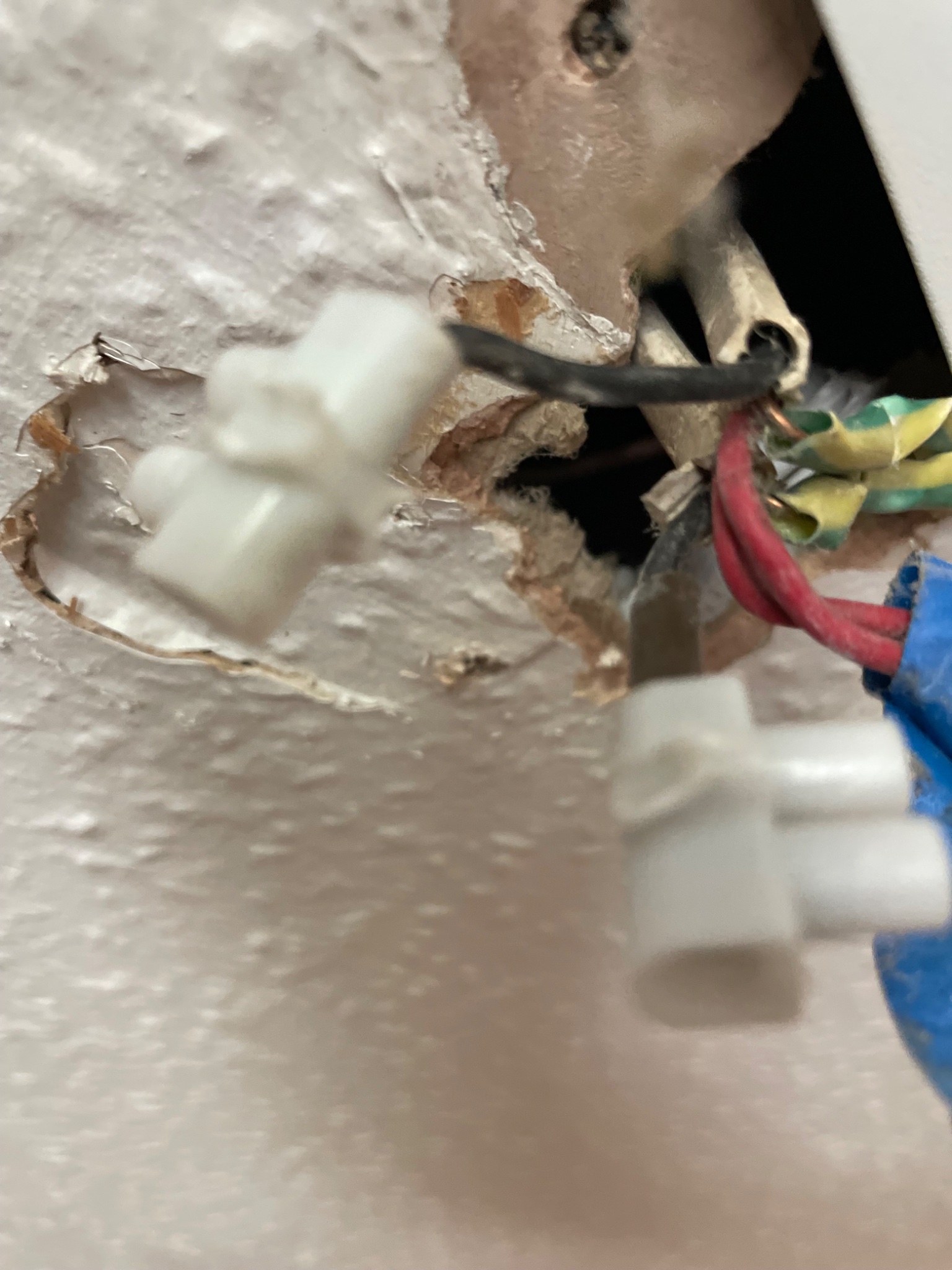

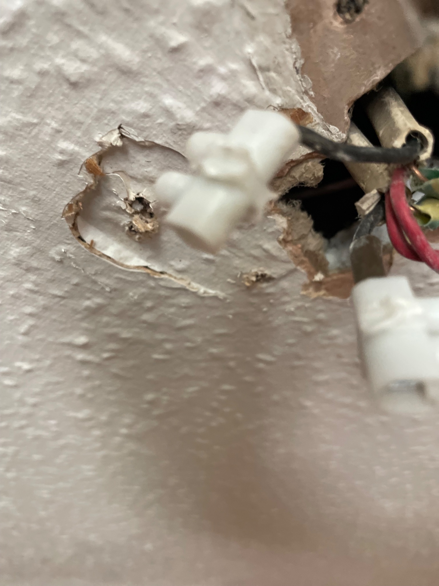

Hi everyone, I need some help fitting a new fan/light fixture to the ceiling. The fixture requires a live and neutral connection. In the ceiling where I currently have a standard light pendant connected, the wires available are the following. There is a black wire, there is a brown wire (but it seems to have previously been black but now has a short piece of brown cabling attached to it) and there is also a red wire which has been taped. There is also an earth connection (already connected to something, so isn’t available).
My question is this, is the black neutral and the new brown cable, live? If I connected these to their respective slots on the new light-fan fixture, will it work?

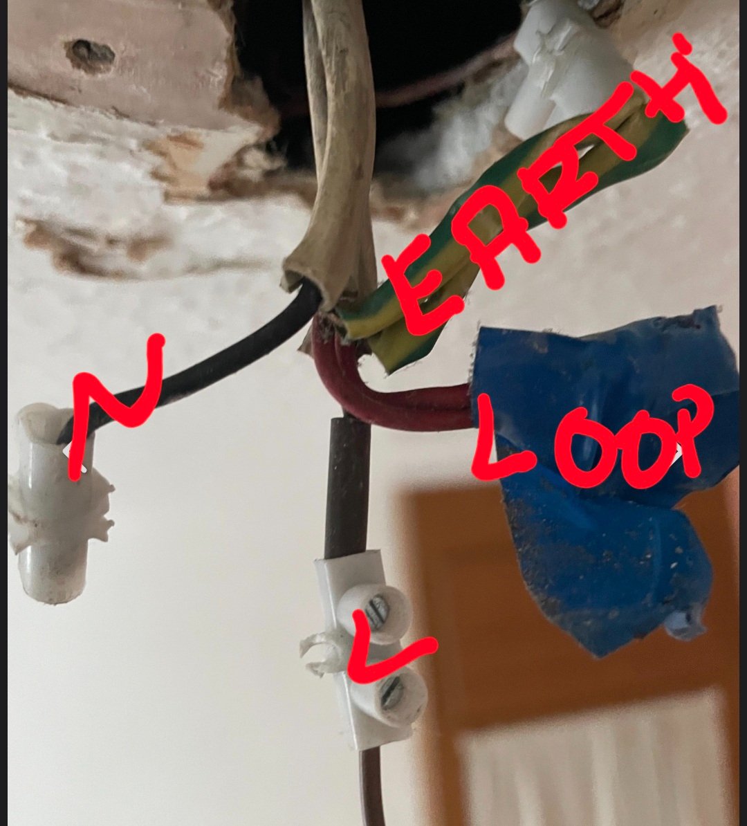

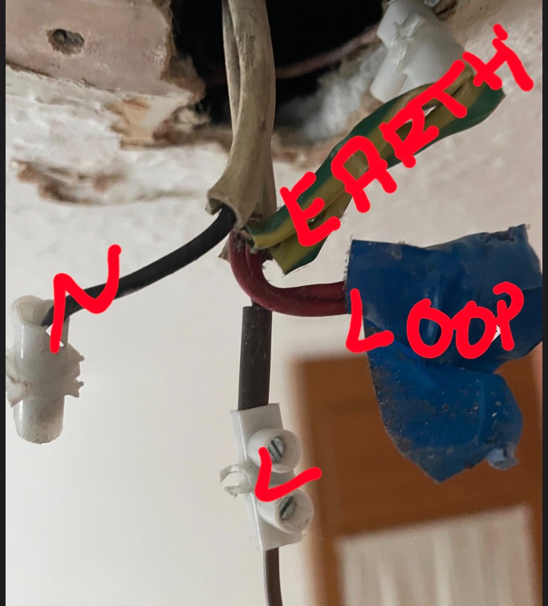

The loop stays in the connector block as it is and don’t forget the earth.
posted at same time as pete01
loop in Live and neutral and earth from some other light fixing or CU
then the next wire is
Live down to switch and live back from switch - Black with the brown sleeving on
then the black with no sleeving is the neutral
SO how will the new light fitting work - WILL it be controlled by the light switch at all

Also how is the beam above the cables - ceiling board - a fan will need a good fixing onto the beam and not just onto the ceiling board
Thanks guys for the quick response. I just connect the cable you labelled L to the live slot on the new fan/light and the N to the neutral slot. Is this right? I am not a complete novice with electrics but want to make sure from others who are electricians or have a lot of experience with electrics.

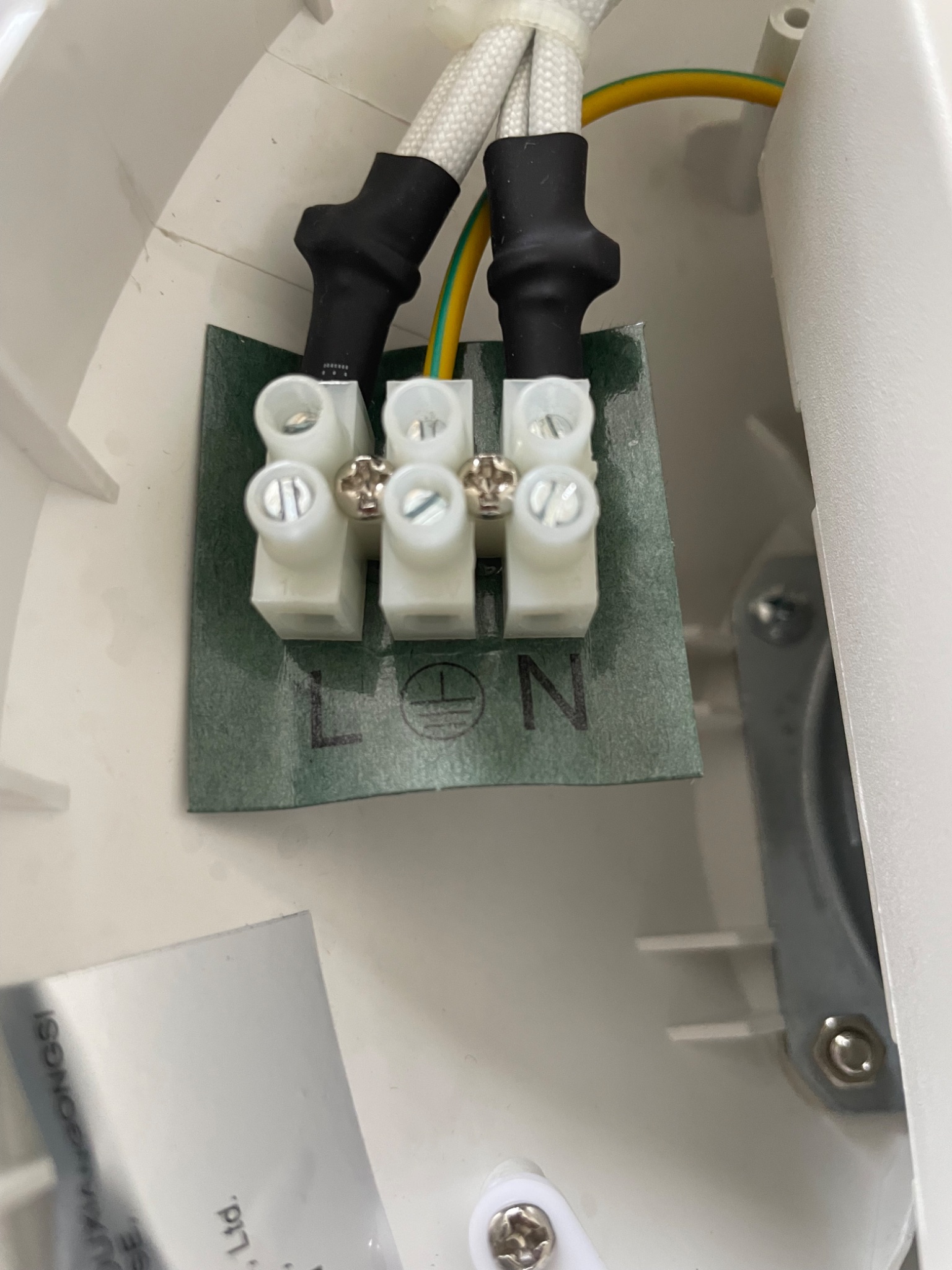

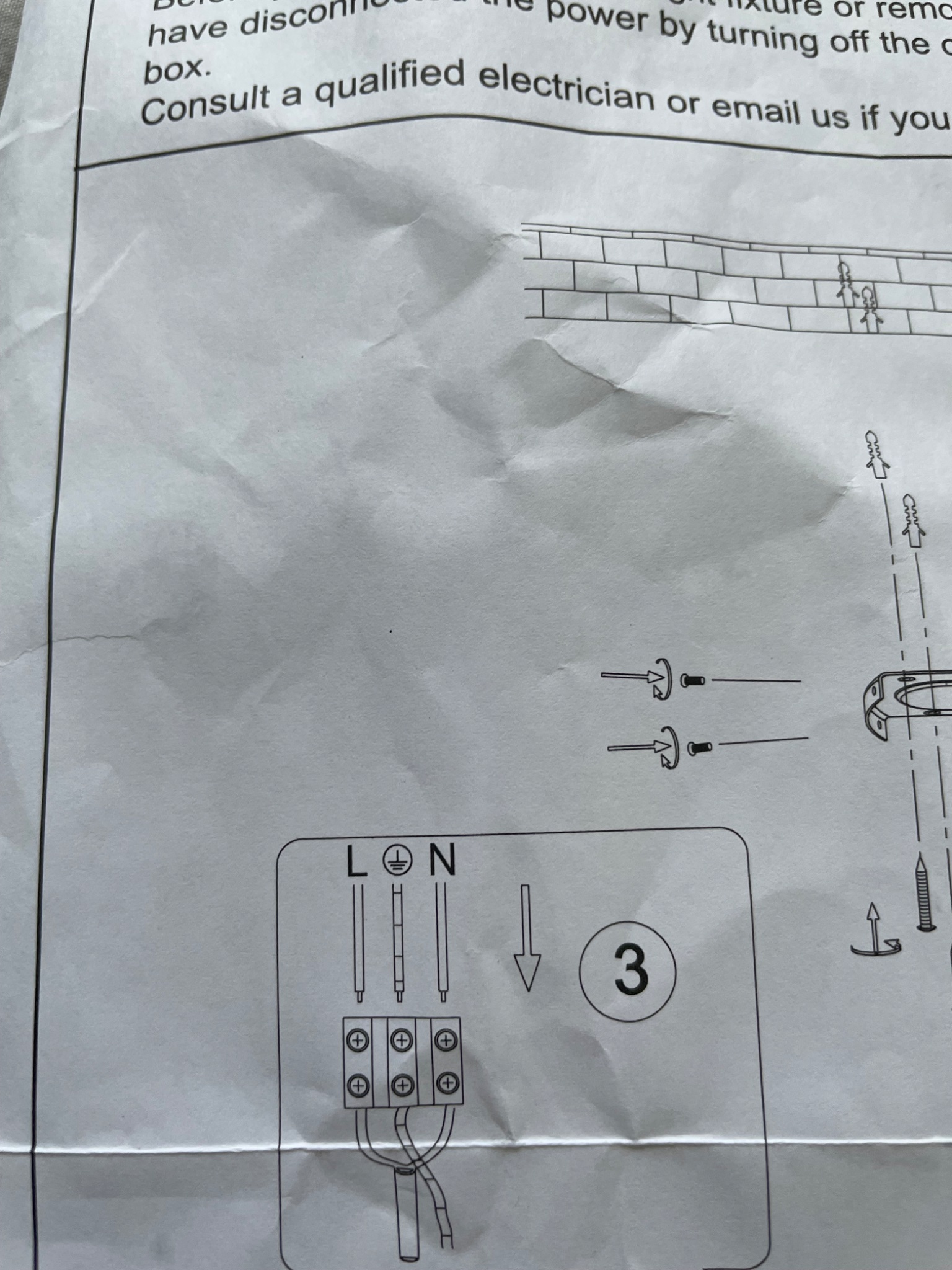

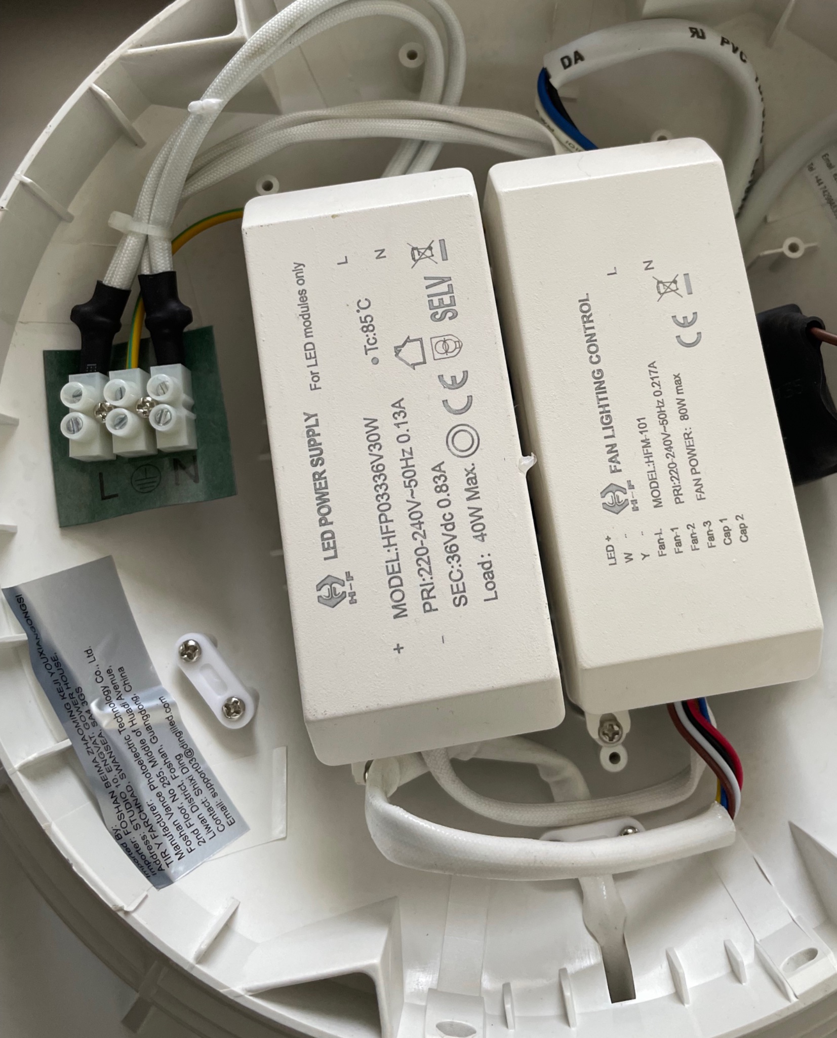

Here is a pic of the connections on the new fixture. According to the instructions supplied with it, I think it requires a live, neutral and earth connection.
The only problems is, the earth connection (the yellow and green multi coloured) in the ceiling seem to be tied up. It’s maybe connected to something else. I am not fully sure as I didn't try to move this wire around)
Pic 2 is the instruction diagram
Pic 3 are the other connections on the fan/light to give a complete overview of all connections.

Do I need to connect earth to the fan/light fixture or just live and neutral? Are all three required?
how will it be switched on/off does it have pull cords or remote
I imagine the wall switch. There is a supplied remote with it as well. The remote has an on off switch as well as well as controls for fan speed and light brightness

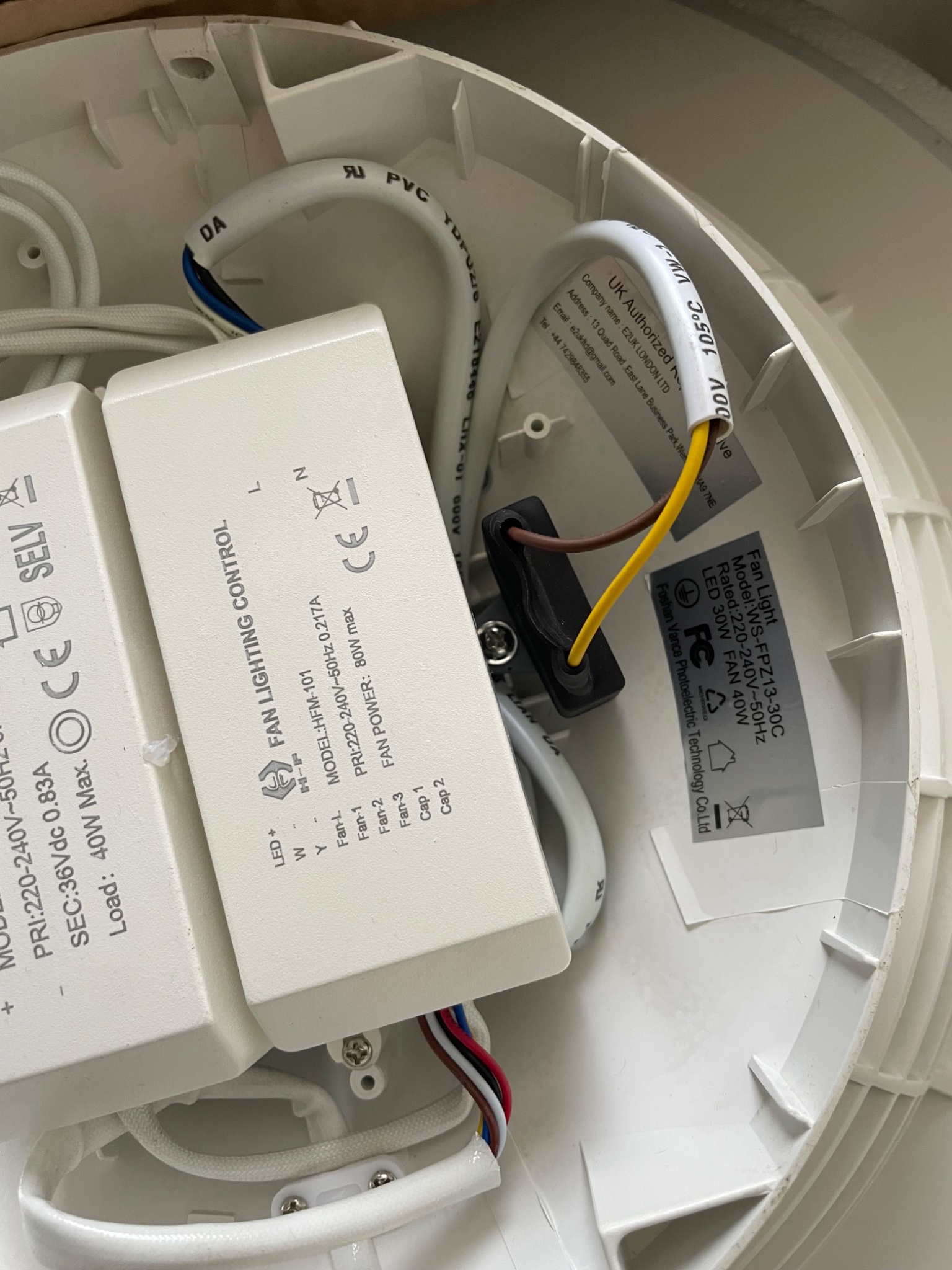

Depends on how you want it to run , can be connected to the live and be ON all the time and controlled from the remote OR only work if the light switch is operated - although when light switch is on - i guess you will be able to just turn off from the remote control
So LIVE to the loop Or the black with brown sleeving , personally i would prefer a physical switch to switch OFF completely
yes Earth will be needed as it actually has a wire on the earth and not just connected to the metal work, i guess needed for the motor
Here is a pic of the entire electronics inside the fixture. By the way, the current light is a standard pendant. Only the live and neutral were connected to it.
I think it will be better if the wall switch needs to be on before the remote is used. I want to obviously be able to on and off using the remote. But it should be on at the wall first. If the wall is off, it shouldn’t be turned on with just remote. If this is the case, do I need to connect all three (live, neutral and earth)?
Yes ,
Live to the Black brown wire -
Neutral to the black wire
Earth to yellow/green sleeved wire
And fixed onto a beam NOT just the ceiling board - so how was the pendant fixed to ceiling ?
You could box up those connectors into the ceiling void and run a 3 way cable down to the fitting -
