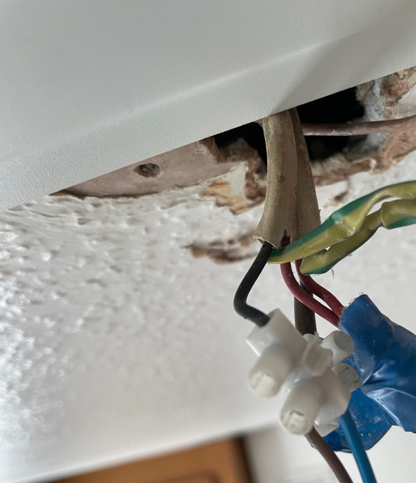

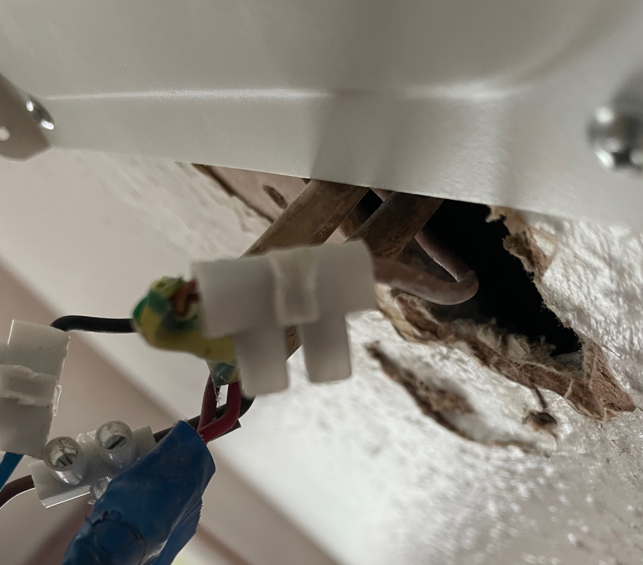

Yes, connector blocks. The earth one you saw from the ceiling has both connectors on the block already occupied. I pulled it out a bit from the ceiling and what I see is the earth wire going into it at one end and a red one at the other.
that maybe a problem , although electric does not know what colour wire is and its up to the installation to use the guidance standard - then a red wire connected to the earths would need investigating , maybe a photo would help - maybe thats NOT an earth at all , but used for something else and miss sleeved
Here is a pic of the earth wire. You can see one end is the green and yellow and at the other end is a brown cable (sorry not red as I had mistakenly stated earlier). In any case, both ends of the connector block are occupied.

And here is a clear pic of all the wires in the ceiling together. The blue and the brown wires at the bottom of the pic belong to the light pendant.
Do I simply connect it as the old pendant is currently i.e. just the live and neutral?
Should I try and see by connecting just the live and neutral? It’s not going to damage the electrics of the house is it?
yes, to use the switch to provide the power
But it does need an earth , for safety - and that Red wire connected to the earth leads ,needs investigating as to why its connected to earth and what it actually does
It’s actually brown (not red) connected to the earth, but that’s probably not the point. So you don’t recommend I connect the new fixture (exactly as the old pendant)? I reconnected the old pendant back with live and neutral and it works fine.
I decided to hold off from connecting the new fixture for now as I wanted confirmation that it will be fine connecting it like the pendant
Can you not work out where the single brown goes? is there a metal box in the ceiling and they've just used what the had(brown wire) maybe?
