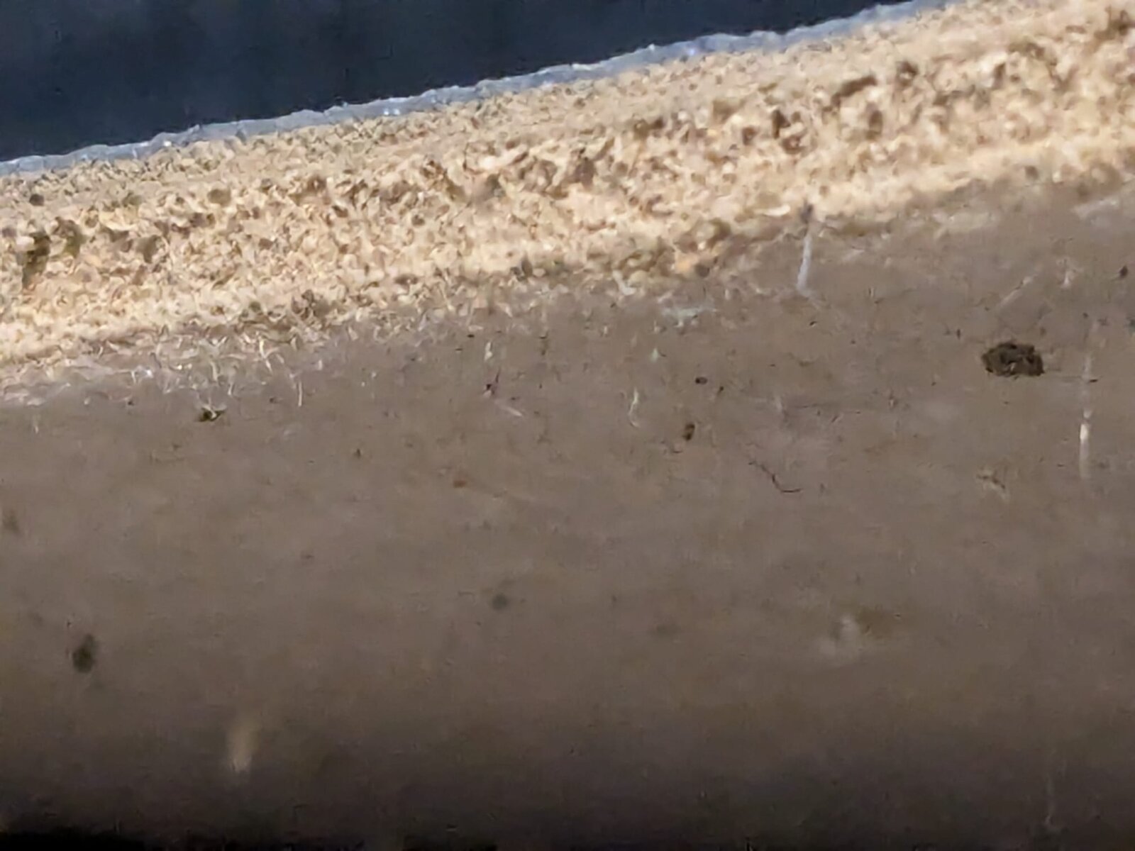

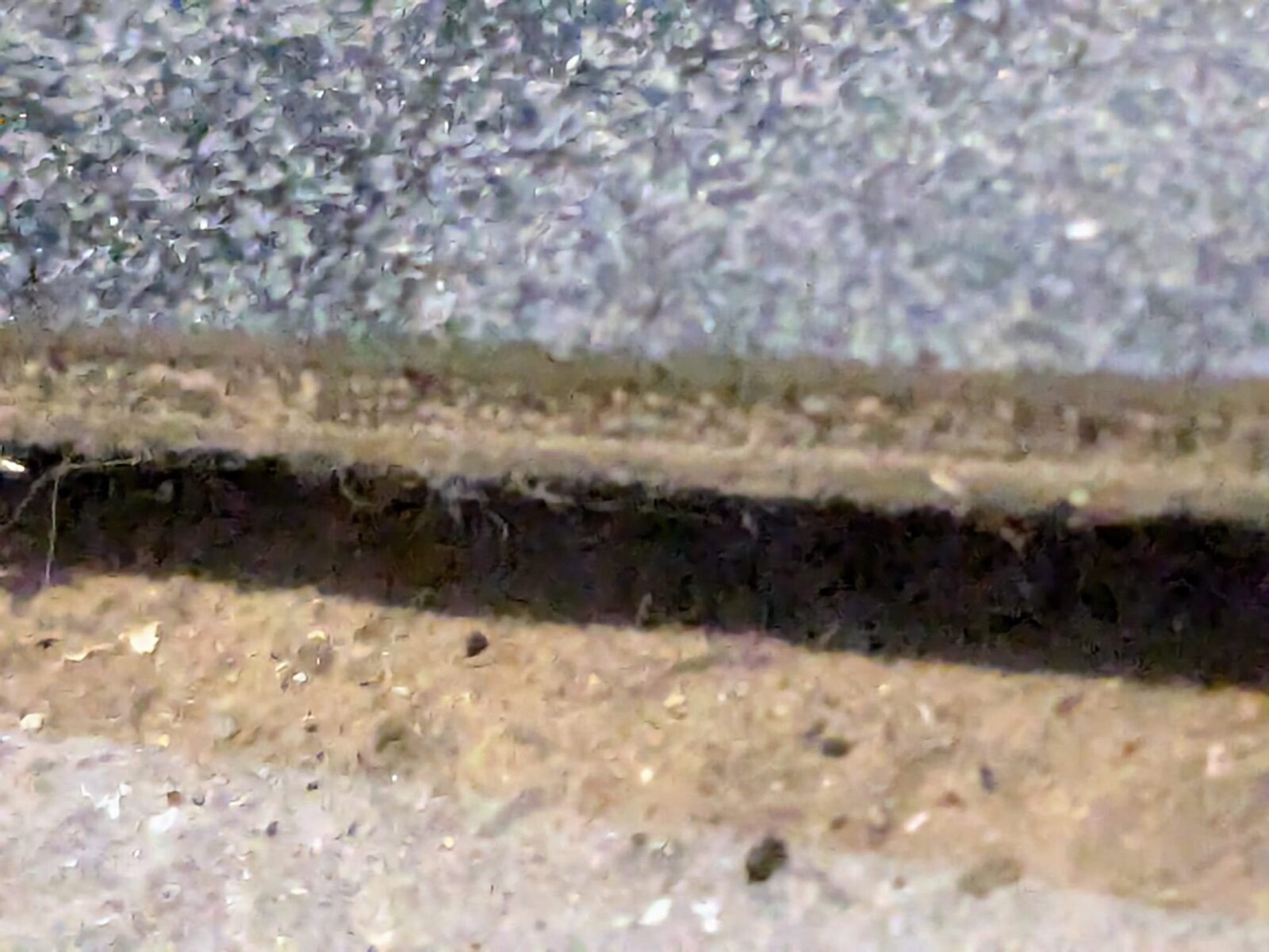

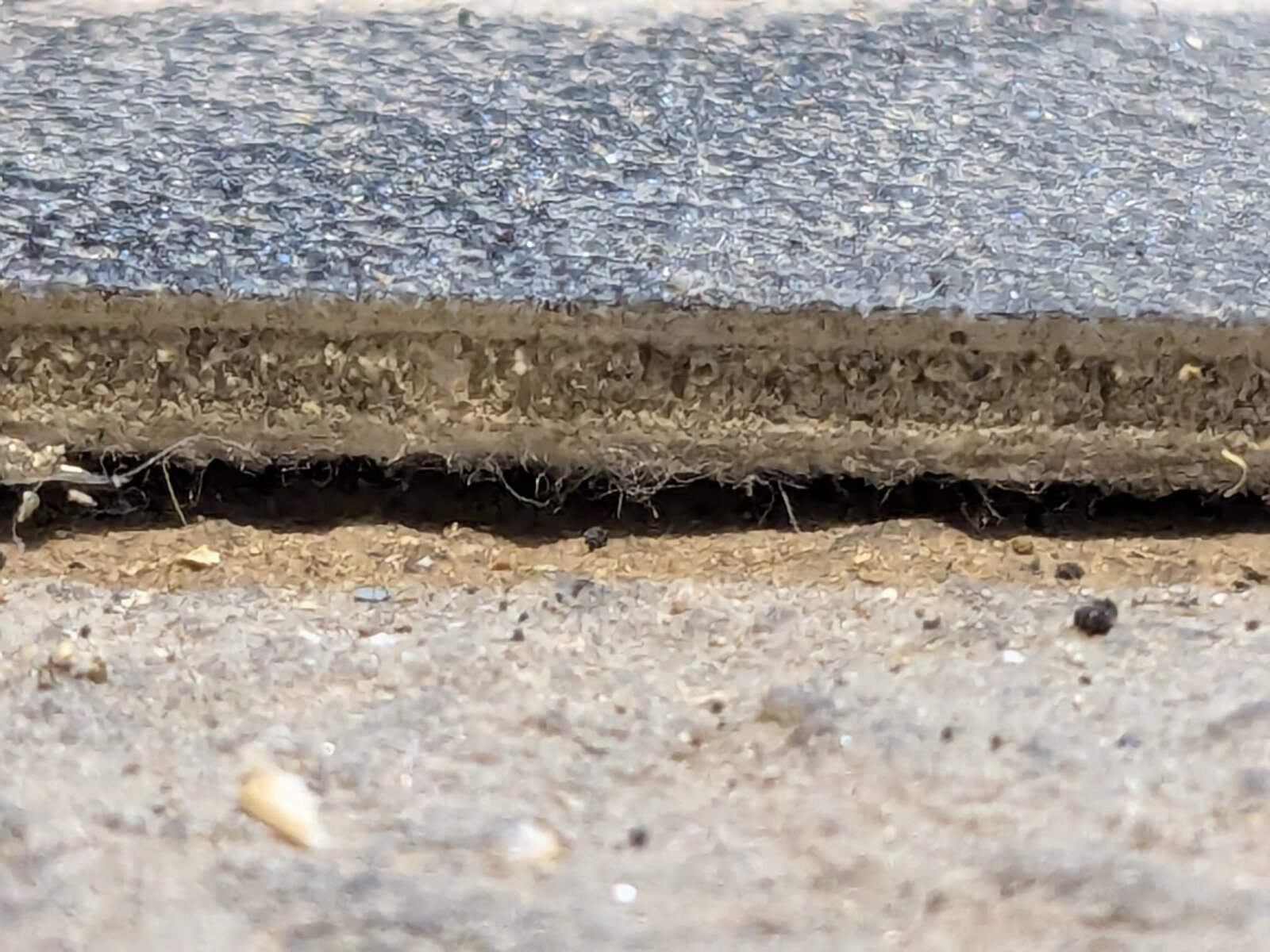

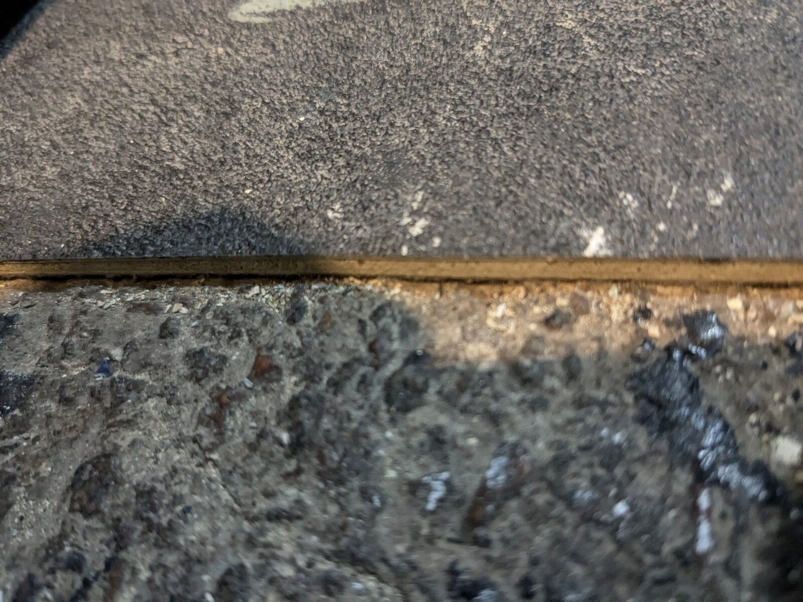

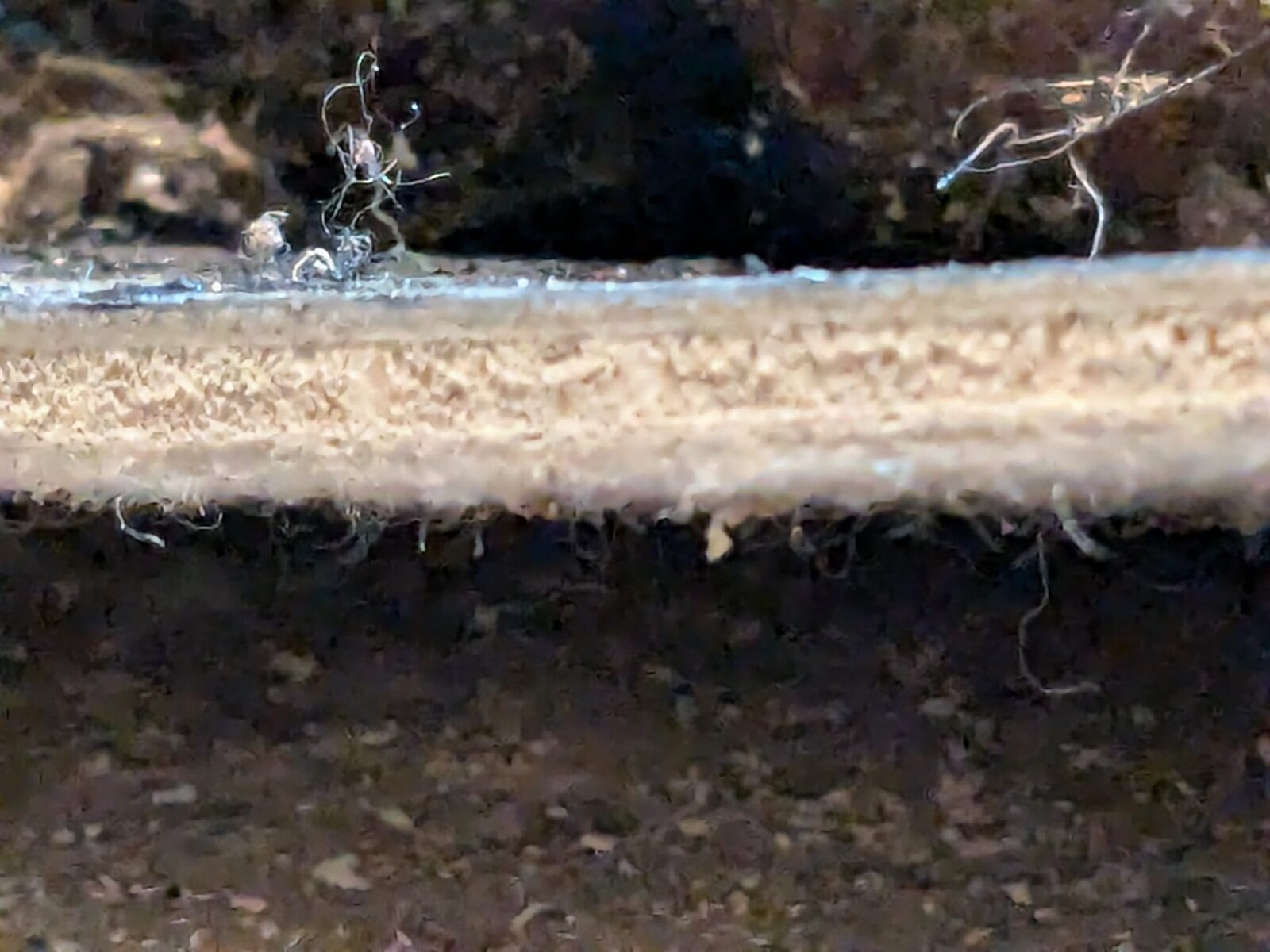

How can i know if the floor is vinyl ? Here are some pictures i took, i found an edge of it in the tool closet that isnt fastened down so ive photographed it in ultra closeup from as many angles as i could. The flooring is a few mm thick, hard to judge or measure but definitely thinner than 1cm, probably 5mm or less

But you are applying your experience to the assumption that this floor is vinyl, as far as i can tell that isnt true, its some sort of soft foam/fabric?

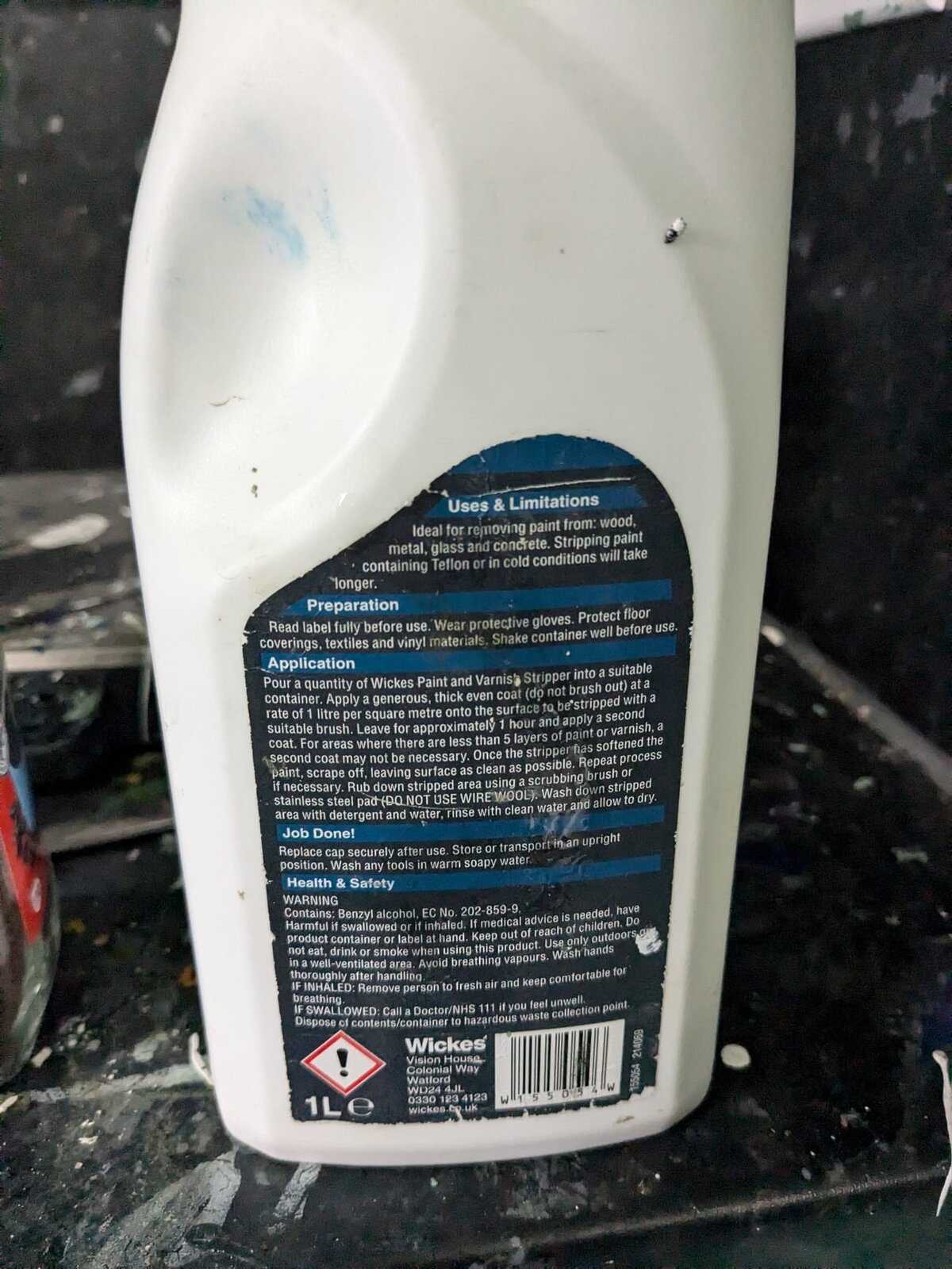

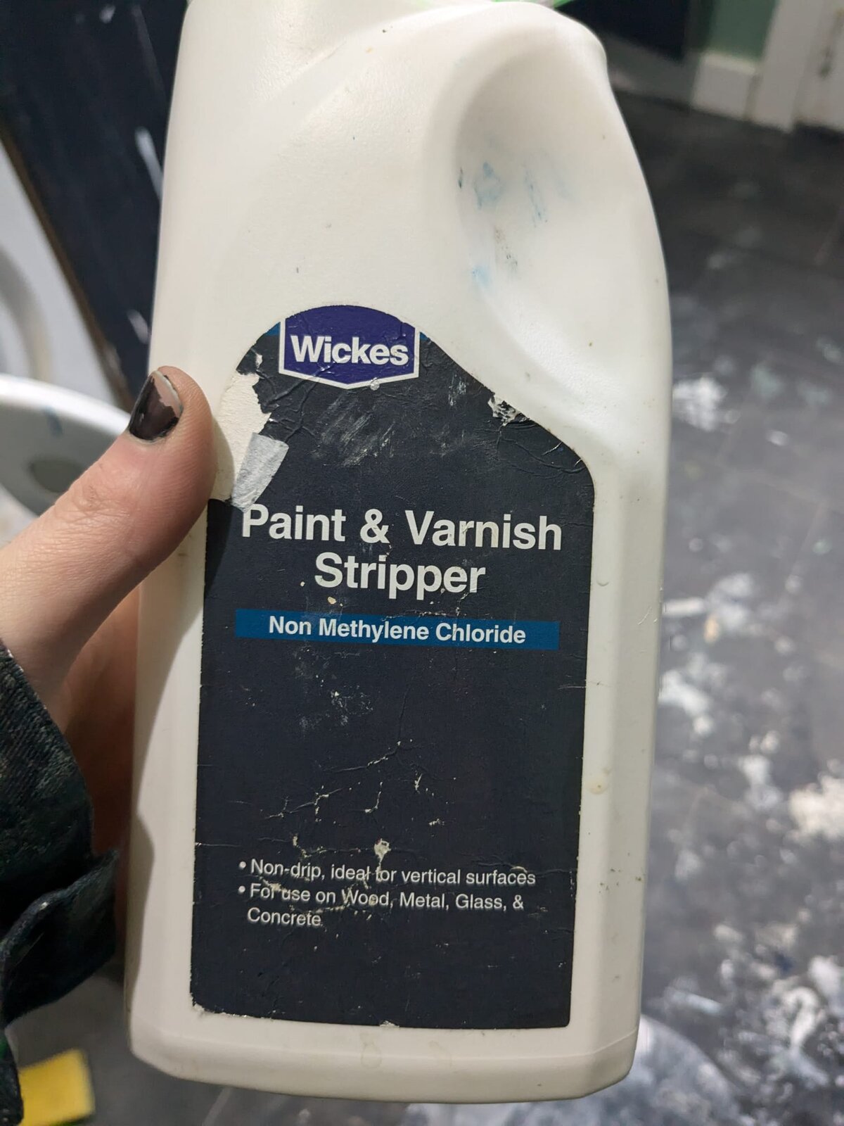

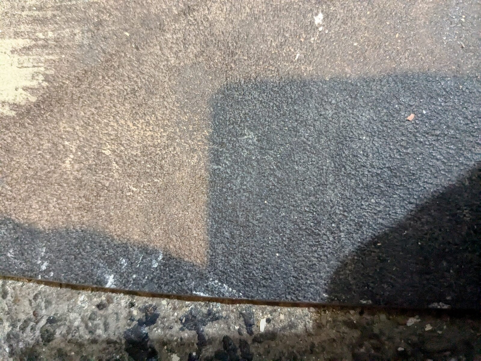

Well the time has come to actually do this cleaning, and since you weren't listening to me, i decided not to listen to you either. I'm glad i did!
I went ahead with experimentation on a test patch. White spirit does nothing to either the paint or the floor, ditto for acetone, and most normal cleaning chemicals. But i found something that DOES work! Plain old paint stripper from wickes.
This softens the top millimetre or so of paint, which easily sorts out all the glossy white parts. The glossy black does come off but much less, it will take several coats. But its getting all the paint off and causing no damage to the flooring, i've tested it overnight and the floor underneath is fine
Maybe this wouldn't have worked on a vinyl floor. And maybe my floor isnt vinyl, like i tried to tell you repeatedly, idk.
I feel that you really jumped the gun a lot here JohnD, and if i had followed your advice i would have been stuck with a permanantly stained floor, or a big bill for replacing it, when cleaning it is perfectly feasible!
