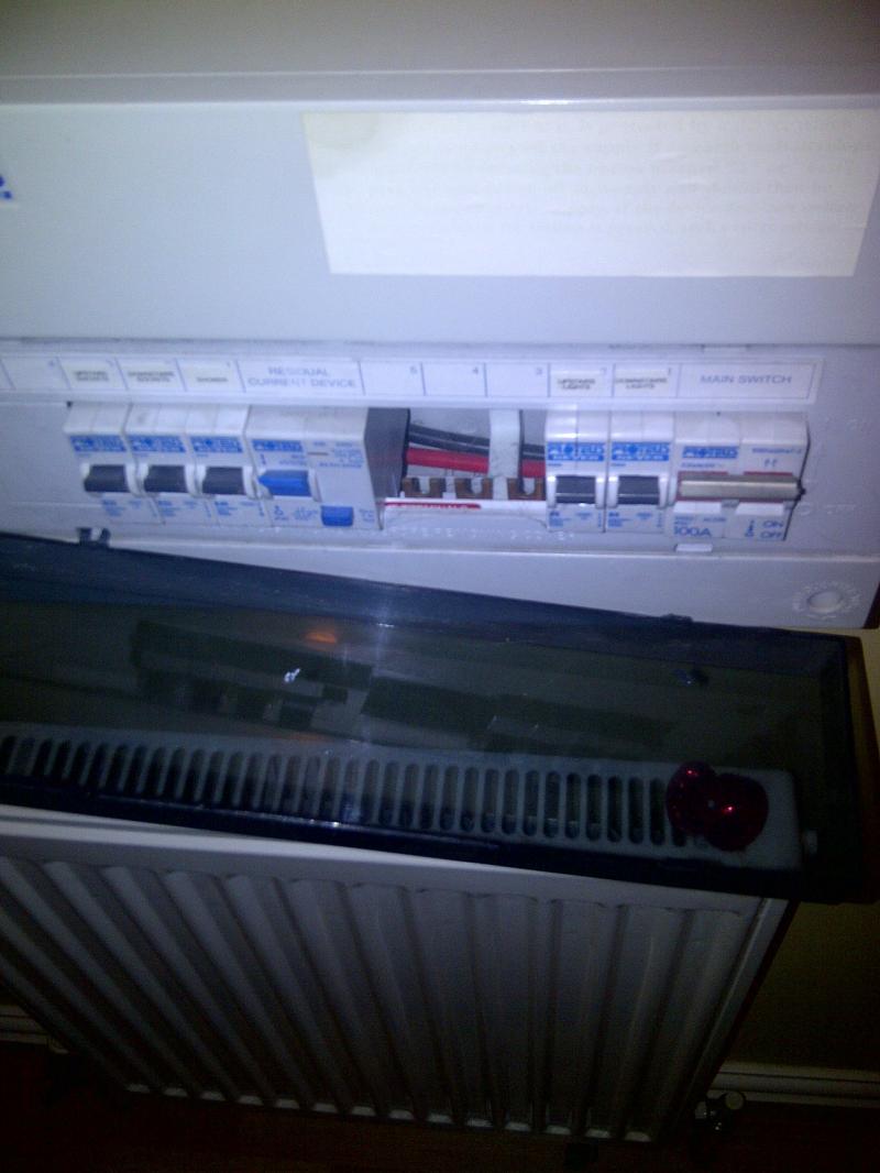

I went to visit my daughter and 4 year old granddaughter at their new rented property yesterday and was surprised to see the consumer situated about 3 feet from the floor just above the radiator in the entrance hall. My first thought was to think how easily accessible it was to my granddaughter. To my horror I then noticed there was a large gap inbetween the breakers. Surely this isn't acceptable in a rented property. I told my daughter to ring the estate agents first thing this morning and their response was that they wanted her to get an official report from an electrician before they would contact the landlord.
Surely it is their responsibiltiy to sort this out, and quickly. It is a perfect height for my granddaughter to easily pull down the cover and put her fingers inside.

412.2.2.3 Where a lid or door in an insulating enclosure can be opened without the use of a tool or key, all conductive parts which are accessible if the lid or door is open shall be behind an insulating barrier (providing a degree of protection not less than IPXXB or IP2X) preventing persons from coming unintentionally into contact with those conductive parts. This insulating barrier shall be removable only by the use of a tool or key.
Often the blank plates for one make of consumer unit are used on another. There are distribution units where the tags for the MCB's can be isolated with a slide switch. In which case snap in place blanks can be used as if removed there are still no live parts. Reasonably sure the one you show is not that type. With the type where it is not isolated then the blanks have to be the type where whole cover is removed and they are inserted at an angle and then straightened before the cover is replaced so can't be removed with fingers you need a screwdriver.
I have failed installations many times where wrong type are fitted and with good nails they can be removed.
I am sure you now know the dangers and you will get rectified make sure correct type are fitted.
The position is more of a problem.

It is not easy to prove that the heat from the heater has not been taken into account but it would seem likely it has not. So likely either heater or consumer unit will need moving. Clearly you would like to see consumer unit moved.
It is common to see consumer units under stairs and in other low positions and I can't think of any rule that says they must be out of reach of small children.

The real issue here is that the CU has not been blanked off and the live busbar is exposed, it is sometimes unavoidable to keep CUs out of the reach of children but as this is a let property, I would expect that some provisions were made against this.
