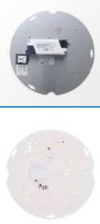

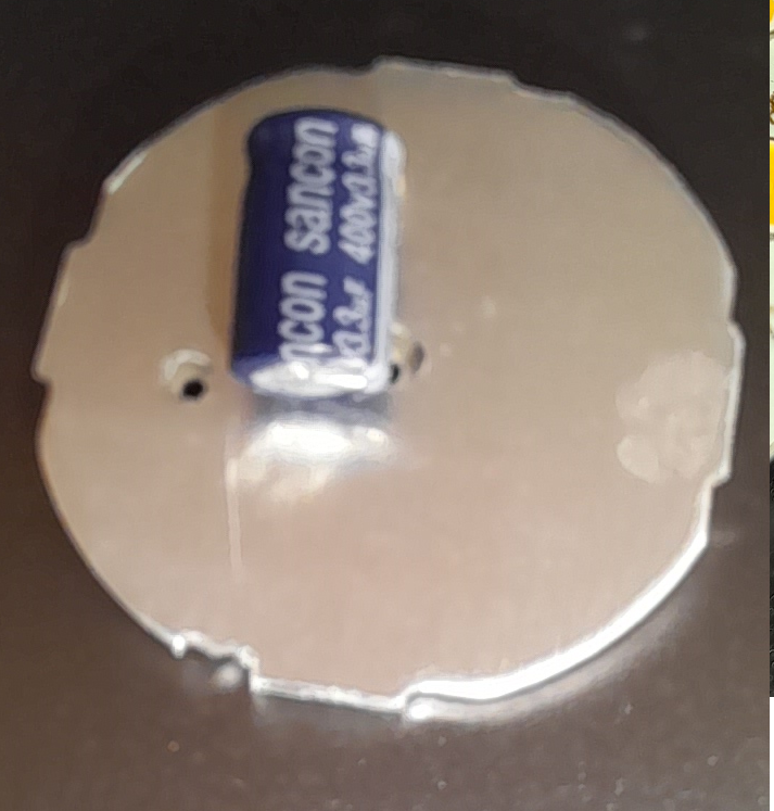

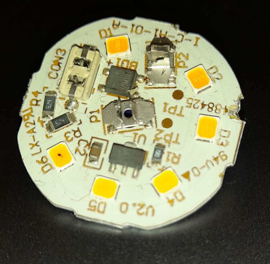

I have found same as @JohnW2 cheap seem to last longer and stock does not seem to reduce IMGP0859-60.jpg I have traditionally kept a stock of bulbs. Integral lamps is asking for problems, hard enough to find a bulb with same colour temperature never mind complete lamp. The life expectancy of a fluorescent with an electronic ballast is about the same as an LED, you can get LED replacements for the 2D lamp, and if you want fitting to match, only way it to have some lamp where you can replace the internals, nothing has really changed when we moved from fluorescent to LED, you can still buy the internals without the case 1713942664596.pngif you don't want to do that, then you have to live with the problem of getting matching cases. Even with minimal components one will get failures, this lamp bulb inner2.pngbulb inner1.png with the LED's I can see the chip has failed
and the chips are likely from same manufacturers even if the bulb or fitting is not, and the capacitor 1713943298569.png is electrolytic so has a finite life, it will at some point fail, there have always been bulbs which have lasted longer than the rest,
