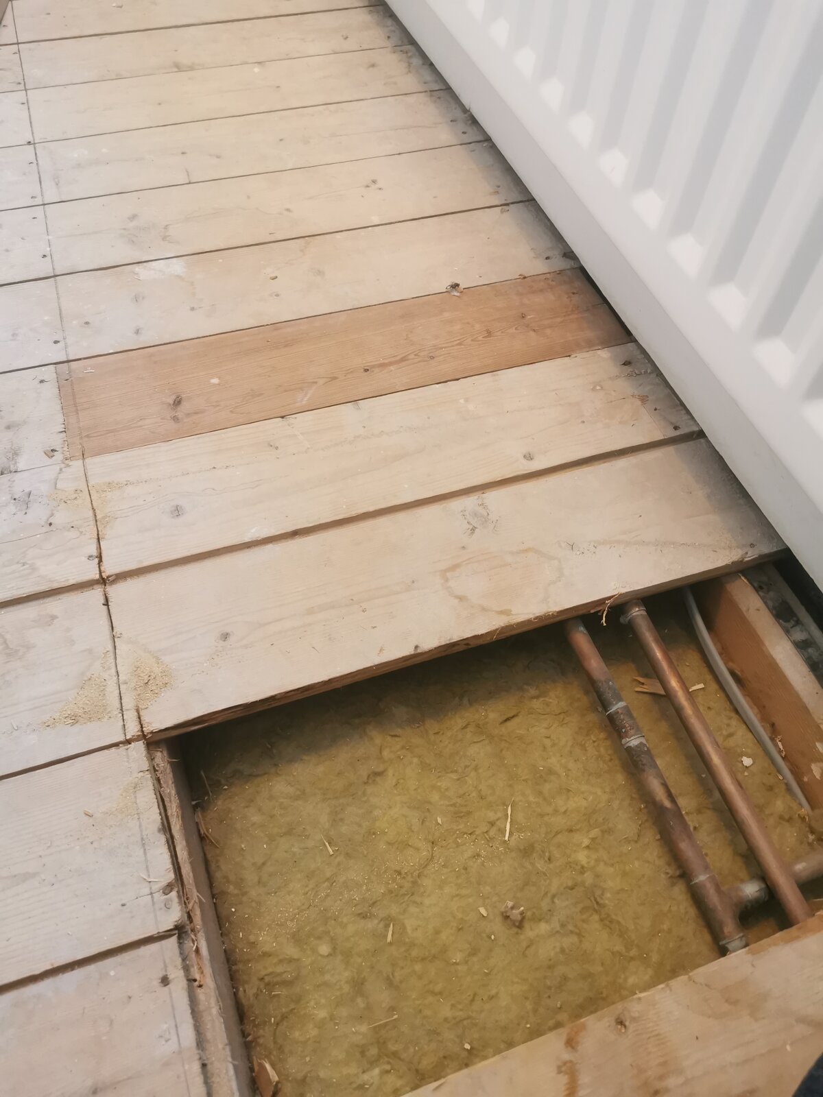

Hi all,
So who needs DIY bodges when a pro is willing to do the following and take money for it.

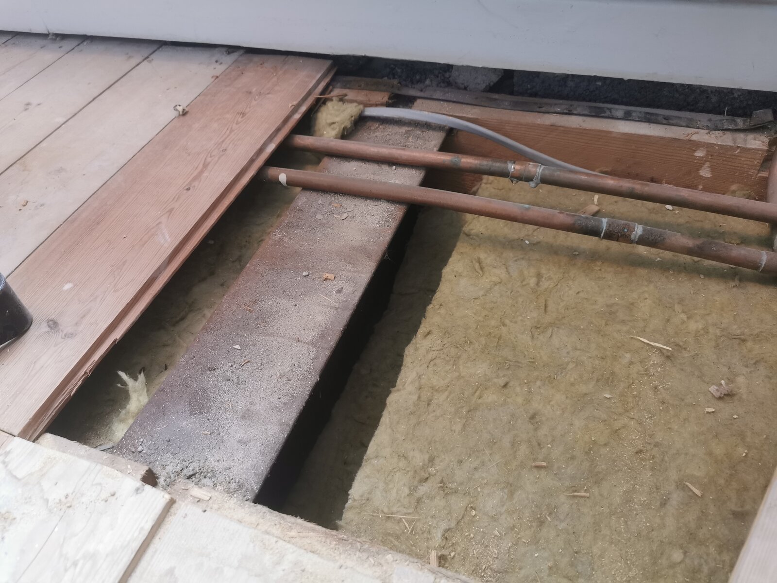

So for a bit of background, ever since we moved into this house the floor in the front bedroom has been horribly creaky, after taking up the old carpet there was an obvious crown in the floor boards, having decided to replace the flooring, today I've been cutting up some of the old floor boards to allow me to work out where the plumbing runs, it turns out when the new radiator was fitted in the room the plumber employed to do it has ran the pipes straight over a steel thats under the floor and then nailed the floor boards straight over the pipes causing the crown in the floorboards.
I know the previous owner was an older lady who spent decent money on the houses upkeep so this will be the work of a professional who appears to have no pride in doing a proper job.
I now need to decide if I want to drill a couple of holes in the steel to pass the pipework through which will likely mean consulting a se and finding out the total span of the steel or find another way of routing them around the steel, anyone any ideas that isn't surface mounted?

TBH, if that beam was cored with 2 holes, for that size of pipework and it was central to the beam, I would be very surprised if it would compromise it's integrity to any degree.
The best bodge I can think of would be to route 10mm out of the board for the pipes, shim either side of the pipes and fix board with shim through the steel with metal self tappers (pilot drill a 4mm hole first though, the steel is thick even at the edges).
Wouldn't be the first time I've hole sawed through an I-Beam for pipework, good quality bi-metal hole saw with a good drill and lubrication will make short work of it. Just make sure the holes/pipe is protected against rubbing damage.
What about re routing the pipes to the right, under that wall through the wooden joist, along the underside of the wall and then pop back in the other side of the metal beam?

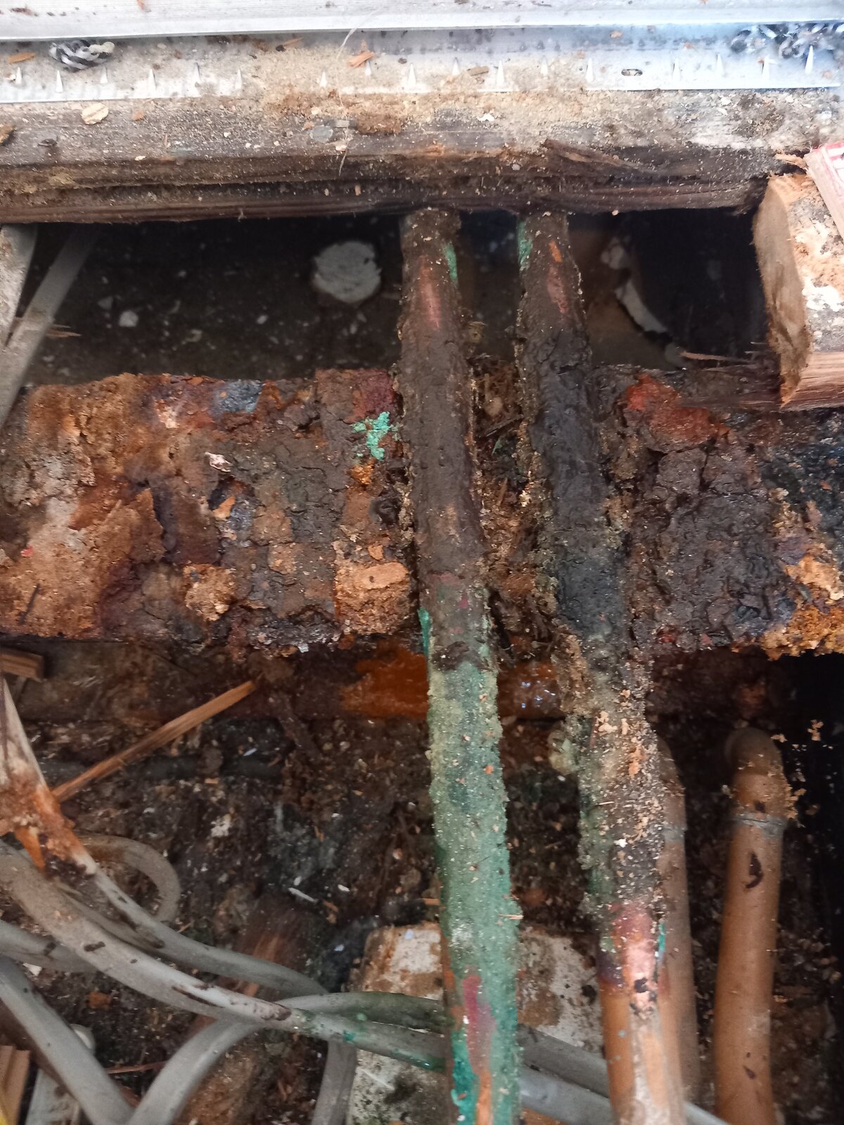

The old bi metallic corrosion - copper/steel
The one in my photo pipes were put in around early 80`s the pic was took earlier this year when the damp patch started to show on the ceiling .
But we were fixing leaks like that on same estate from early 90`s so that one lasted well
