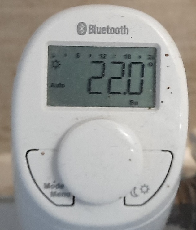

I looked at this report on use of TRVs and it showed
so why not simply write it in degree's C to start with? I will guess I know the answer, in that 3 for example does not mean 20ºC but a range of 17ºC to 23ºC between fully open and fully closed. Mine
do show degrees C, and can also be programmed with varying temperatures through the week.
However, I have seen the settings on TRV heads set at max, where a wall thermostat has turned off the boiler, and someone thinks turning up the TRV will get room warmer even when the boiler is not running.
Yes, read the books, and the instructions with a boiler, and so much conflicting information may as well through in the bin. Now in my 70s, and still finding I was wrong in the way I thought central heating works. The pictures seem to make it so easy
all seems to make sense, then one finds the errors. The first is what turns on the central heating to start with.

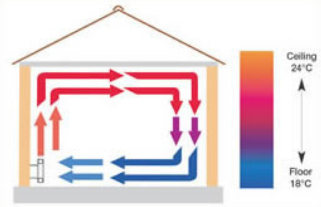

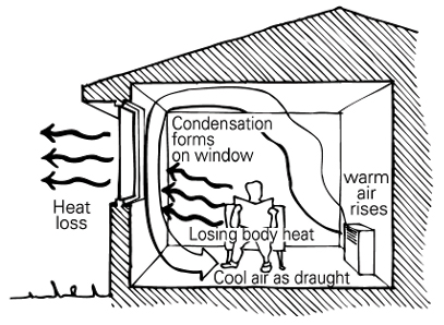

So we put a sensor (thermostat) somewhere in the house to tell the heating to come on. For the moment forget which room, just consider where in the room. So the book says on the wall opposite to the radiator, and I can confirm 90º to radiator does not work, it needs to be in the air flow. So picture number 2 shows the problem, sticking a thermostat on the window will not work. So we look at picture number 1, at the radiator seems A1, it may need setting low, as the return air has already cooled, but that is only once the heating is running.

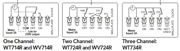

why have three channels? The TRV will be programmed, so rooms will only heat up when required, with two channels, if working a mains powered motorised valve, (TRVs are motorised valves when fitted with electronic heads) I can see need for more than one, the EPH I think system can work with up to 9, one thermostat set as master, the other as slaves, but with a few exceptions, like my house it is either TRV or mains powered control, not both. My house has a main house and flat, so yes, two independent controls. This must be rare, we, and I would guess many others, assign our rooms to different use, so office and craft room used in the day, and two bedrooms used overnight, so splitting up/downstairs would not work, same applies with children doing homework.
So central heating install must be flexible, easy to move TRV head between rooms, but to change which rooms a mains powered motorised valve serves is much harder.
So who designs the central heating fitted to homes? Why *12345 on a TRV head, and why mains powered motorised valves for other than controlling domestic hot water independent of central heating, and even then, in summer using a central heating boiler to heat DHW can work out rather expensive.

all seems to make sense, then one finds the errors. The first is what turns on the central heating to start with.So we put a sensor (thermostat) somewhere in the house to tell the heating to come on. For the moment forget which room, just consider where in the room. So the book says on the wall opposite to the radiator, and I can confirm 90º to radiator does not work, it needs to be in the air flow. So picture number 2 shows the problem, sticking a thermostat on the window will not work. So we look at picture number 1, at the radiator seems A1, it may need setting low, as the return air has already cooled, but that is only once the heating is running.
