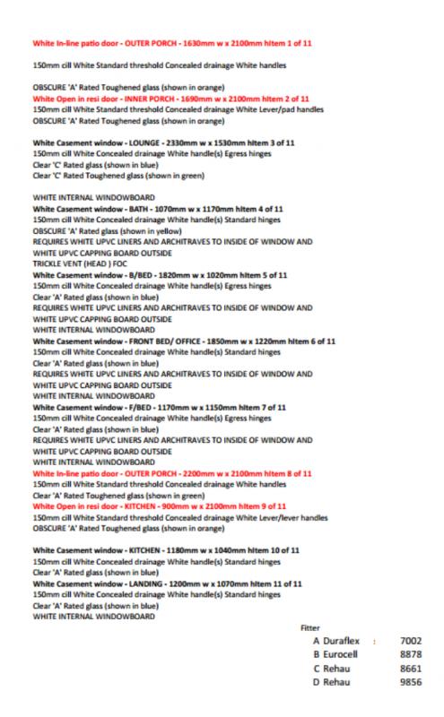

Why would quotes for the same job be so different? My son told me that he has such from four installers, and that the work asked from each is identical. The range is around £2900. As he lives in the affluent South-east I would not prices to be the lowest. So uou can see what son wants done see image below that includes the various quotes. In each case profile is 70mm

I would question any company that offers 'A Rated Obscure Glass'

Thanks for post. He avoided the nationals on purpose, so I meant the four he'd had quotes for. It's those differences that bug me.

The last part of Dh Frames is correct...you can not have an 'a ' rated obscure glass. For any frame that has its glass in it to be classed as A rated would have to include Diamant Glass ( low Iron ...optically clearer than std glass ) , and Low e Glass ( usually Planitherm Softcoast ..designed to keep the heat in.) In the case of an obscure glass , you must be missing one of those two glasses, and I am hoping it will be the Diamant glass, as Low e glass is a must!
There are other points to bear in mind wit A Rated frames .... anything added to the frame , such as Frame extenders ( commonly called Add-on ) , Trickle vents or Frame joiners means ' technically ' generally will NOT be A rated , as it has never been tested in those scenerios
Also whys the Lounge ' C ' rated and all the rest are 'A' ??

I see there are profiles S706, Thermo and Edge that the installers use. Is there actually much difference between them in performance for price differential? Has anyone idea by what % one is dearer than the others?
Egde and s706 are standard profiles on offer from Rehau, to joe public the edge system will be slightly dearer by approx 10%. The Thermo system is again the edge and s706 system but an added foam section is then added to the profile, this then brings the u value down to 0.8-0.9 when used with the appropriate glazing. So say??!!
