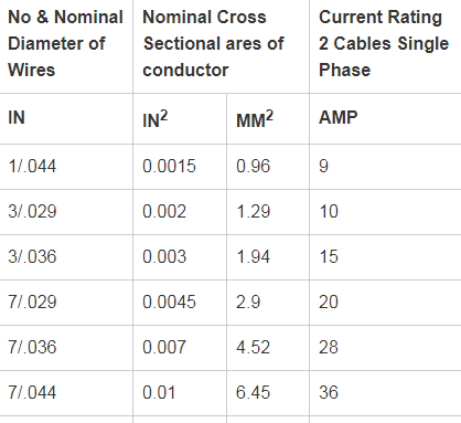

I was wrong earlier about 7/029 being used for old 30 amp ring circuits, it seems 3/0.36 was adequate for ring circuits.
I think 7/0.036 was required with 30A BS3036 fuse:
