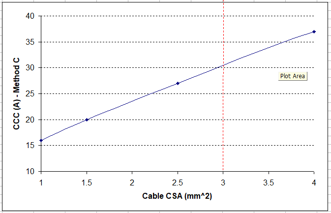

Do you mean because you think that a 30A radial would then have been possible - hence no need for a ring?
If so, I'm not so sure. Looking at today's CCC figures (Table 4D5), interpolation indicates that Method C 3mm² would probably have a CCC (assuming an MCB) of fractionally over 30A ...
However, in the days of BS3036 fuses, that would presumably have translated to around 21.75A - hence a 3mm² radial presumably could have been only 20A (or 21A !) ... or have I got that wrong?

7/0.029 is about 2.95mm² and all the charts indicated 23-25A IIRC.
Well,, that's not a million miles away from the 21.75A (with a BS 3036 fuse) that I arrived at (for 3.0mm²) on the basis of present-day figures and regs - and the point remains that such cable would not be adequate for a 30A radial.
[by the way, my calculation indicates that 7/0.029 is about 2.983 mm², so even closer to 3.0 mm² than you suggest]
