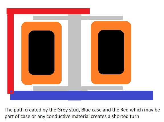

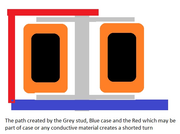

People in the past have mentioned the Rs ones should not be used as they will get shorted turns being in the metal casing, but with the supplied neoprene gaskets i am not sure it is a problem and they have seemed ok, if you have a void behind the light you can use any electronic transformer
https://uk.rs-online.com/web/p/prod...VrrvtCh0EcQmPEAYYAyABEgJm-vD_BwE&gclsrc=aw.ds
The problem is when a single turn is created when the ends of the fixing stud are both in contact with metal.
Ok thanks, in that fitting, to hold it in, theres just a big washer and a bolt that screws into the back plate, so i reuse that, it does not touch the front plate, also there made of that sort of cast alley metal, that, corrodes and goes grey and the paint flakes off, if that makes a difference.
