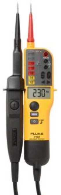

I was using my 2 pole tester on a light switch and intrigued by why the following is happening.

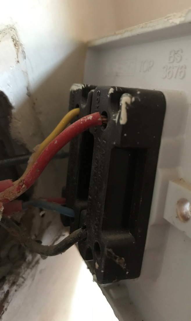

Here's the light switch in question:
It's the left switch I was investigating.
The closest cables relate to the switch in question:
The light illuminates with the operation of this switch. When the light is off, I get 50 AC on these wires and when I switch it on, I get no reading.
Is this expected?
Assuming you are measuring voltage difference between the two terminals on the switch
One probe on Live and the other on Switched Live
The Switched Live is connected via the lamp to Neutral
With the switch OFF the lamp will pull the Switched Live towards the Neutral potential. A filament lamp is low impedance and will pull Switched Live hard to Neutral potential. An electronic lamp is higher impedance and will not pull Switched Live to Neutral as hard as a filament lamp.
The voltage on the Switched Live will depend on the impedance of the lamp and the impedance of the test instrument.
The light illuminates with the operation of this switch. When the light is off, I get 50 AC on these wires and when I switch it on, I get no reading. Is this expected?
If you mean you are measuring the voltage across the switch then, yes, you would expect to measure a potential difference across it when the switch was 'off', but no voltage when it was 'on' (shorting out your test instrument).
Were it a high impedance tester, you would expect to see ~230V across the switch when it was 'off'. If the tester is deliberately 'low impedance', you would see less voltage, since the 230V would then be 'shared' between your tester and the load (light).
