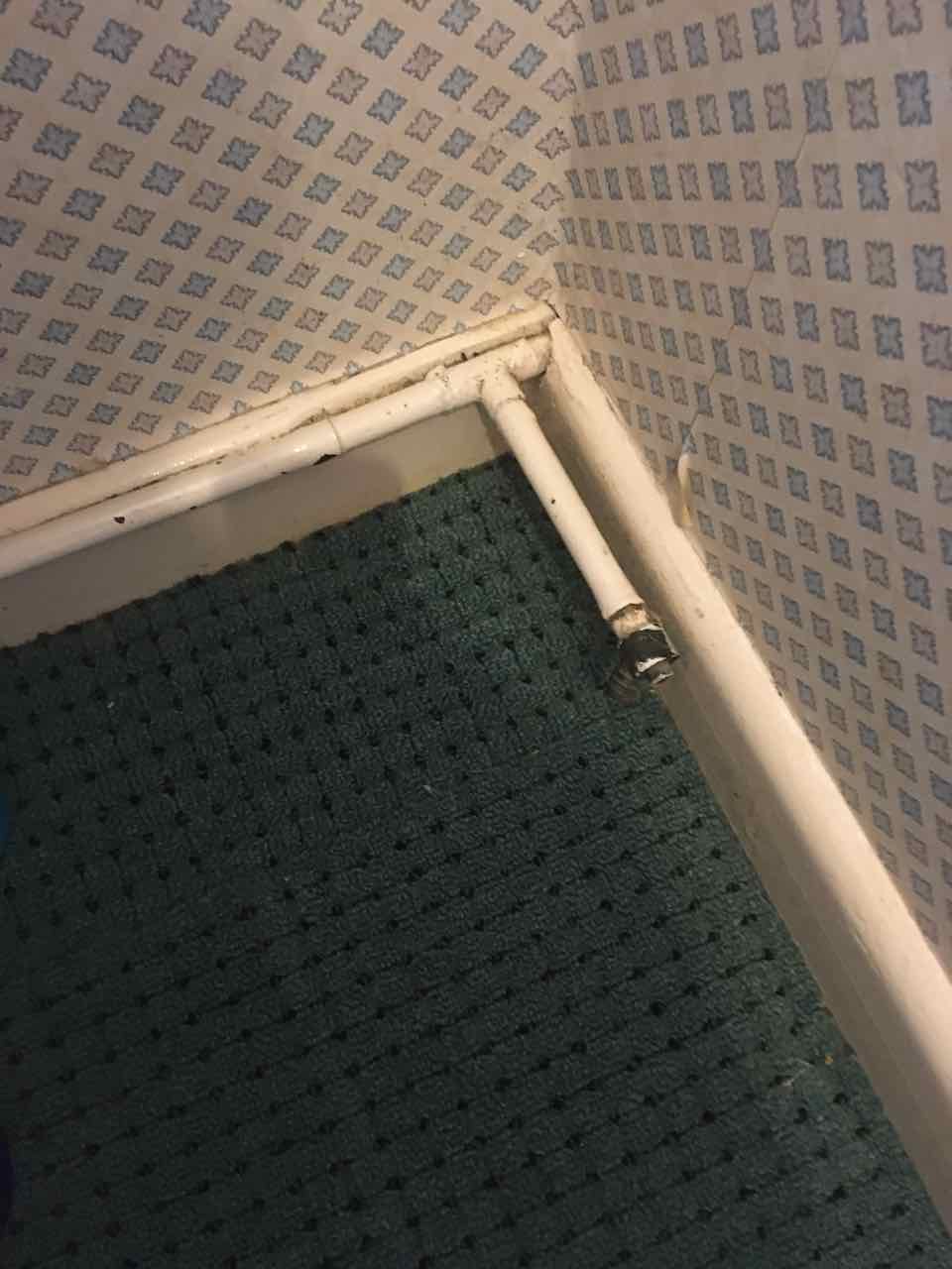

Hi
I'm planning to update our small toilet area , had some really expensive quotes just to replace floor and tile
So i plan to have a go myself
We have a piece of pipe with a drain tap on, Not sure why it has a drain , its on the main water supply to the cistern - see image
why would we have a drain on a mains water supply
I want to cut the pipework back to the "T" and block off
so we have a clear space on the floor, possible build a cupboard or just leave clear
Best way to do that? given the paint all over the pipework, would i need a blow torch to remove the paint and then use a compression stop end
the pipe goes into a old cavity wall before an extension was added

brilliant thanks, will do that
It maybe the pipework is from the tank, but i thought all the water in the bungalow was off the mains, but i should check that out, would that be a reason ?

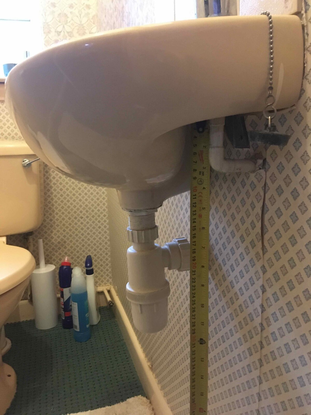

i will also be cutting the pipework to the sink taps and replacing the taps
I will probably put some isolators in the loft as there is not much room under the sink
It is perhaps a low point in the system, mains or cistern fed, and put there just to allow a complete drain down.
Pipe cutters are ideal and may also take off some paint when used.
Drain offs are usually to drain at the lowest point in the system, if it’s on a mains supply, after the stopcock then this should be left in, but maybe take it further back. As for using a pipe cutter/slice, these are fine and quick, be careful not to tramline, and be sure to deburr the ends.
Before cutting ensure the tank supplying the pipe is empty. Just turning the main stop cock OFF is not enough if the pipe is fed from a tank.
