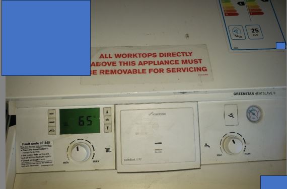

The boiler has 2 displays one for hot water (tap) temperature the other for radiator temperature. The outlet temperature on both can be adjusted separately.

The boiler has 2 separate controls for heating radiator and heating hot water. Not confusing anything.
Separate controls but no display for hot water ?, so how are you assessing that temp ?
The same display is used for bot hot water and for radiator temperature, the readings switch between both. So if you turn up the radiator temp by 1 setting the display will show rad temp then if you immediately change the hot water temp the display will show hot water temp.
Have you confirmed the hot water temp with a thermometer ?
Nope. The boiler manual backs what I have said.
