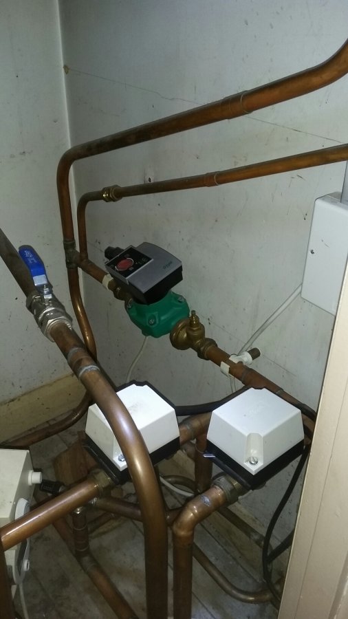

Thank you all for taking an interest. I'll try and answer all the questions in turn:
doggit: I have raised the issue with another staff member of the installers but in the short time they attend the system is working albeit only slowly heating up the house. It seems to be a problem no one wants to own! Thanks for the instructions on use of menu's
Jackthom: Pump set to max flow. The E setting? "constant head "
AGAS: Have now checked D.00 setting and it is set at 30. The "Slimwallet" handle is a response to many years ago asking a simple query about an AV system on an AV forum and someone kindly spec ing a system for about £14.5K as the minumum acceptable for a decent sound and picture!
Muggles: NOt a huge house by anymeans. I don't know the old boiler rating but it could certainly pump out the heat. Rads could get very hot quite quickly. System size 13 rads with 11 in use as two bedrooms out of use. Right hand pipe out of boiler is much hotter than the left hand. Flushing was with external machine with separate pump. I didn't monitor rad temperatutre whilst it was running.
Here are some temp results from today from the boiler menu system:
6.30 a.m. System on Hall thermostat set to 21degC Boiler Outlet Temp set to 82DegC
Inlet d41 Flow d40
6.48 a.m. 51degC
7.06 a.m 32 degC 60degC
7.14 a.m. 34 61
7.25a.m 37 63
7.41a.m. 39 65
8.09 a.m. 41 67
8.40 a.m. 42 69
10.08 a.m. 41 67 (Hall temp now 18degC Lounge 18degC )
13.53 p.m. 42 69 (Hall temp now 19 degC Lounge 19degC )
The system has been on continuously. So after 7 hours still not up to temp.
I do keep thinking that flow must be an issue! BTW the house has been extended twice to my knowledge so I assume the pipe runs are quite tortuous.
Any more thoughts would be appreciated.
