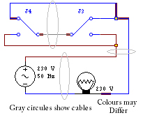

I reckon (But I'm happy to be corrected anecdotally) that in the 50's this was to only way it was ever done. Even with 3C&E one would expect to see a connecter (often a wire nut) behind the wooden patress.There's ALWAYS been more than one method of two way switching...
The so-called old school method relates to that very common wiring diagram with the main feed in the first common, and the live to the light in the second common. That kind of diagram always ends up in text books and even on this forum - yet in reality it's seldom done like that, especially now.
In my home I have both methods, I'm happy to say; all wired by me.Personally I would wire this way View attachment 245251 but nothing wrong with the other method.
I don't doubt you. As I said, there are umpteen ways in which it could theoretically be done, so I would be surprised if others had not been used. However, in terms of my personal experience ...Alternative 2 way switch wiring methods have been going on at least 70 years, if not considerably longer.
... and it's the only way I ever saw it done in the 60s and probably most/all of the 70s. I obviously must have missed out on seeing examples of the 'alternative methods'.I reckon (But I'm happy to be corrected anecdotally) that in the 50's this was to only way it was ever done.
Afaict there are really only 3 ways of achiving two way switching with a pair of SPDT switches. Of course there are umpteen wiring layouts to achive those 3. Two of those 3 ways are still considered acceptable, one of them is considered a very bad idea.I don't doubt you. As I said, there are umpteen ways in which it could theoretically be done
That just about sums it up, as you say there are a selection of ways of achieving them but the final result is those three.Afaict there are really only 3 ways of achiving two way switching with a pair of SPDT switches. Of course there are umpteen wiring layouts to achive those 3. Two of those 3 ways are still considered acceptable, one of them is considered a very bad idea.
1. Feed to the com of one switch, two strappers between the L1/L2 of the switches and load to the common of the other switch.
2. All 3 terminals on the switches connected together, feed and load to L1/L2.
3. Live and neutral to the L1 and L2 of the switches, load connected between the COM terminals. This is a bad idea because it can leave the load live when off and because it risks pulling an arc between live and neutral.
Agreed. I was including the 'wiring layouts' in my 'umpteen' - but, even then, was perhaps a bit of an OTT word to use. Probably the most important of the variants of 'wiring layout' is, with your (1) [what I call the 'old-fashioned' method] the question of whether the neutral travels with the strippers (ideally in the same 3C cable) or whether it is supplied totally separately to the load 'at the other end'.Afaict there are really only 3 ways of achiving two way switching with a pair of SPDT switches. Of course there are umpteen wiring layouts to achive those 3. Two of those 3 ways are still considered acceptable, one of them is considered a very bad idea.
I'd like to travel with the strippers pleaseAgreed. I was including the 'wiring layouts' in my 'umpteen' - but, even then, was perhaps a bit of an OTT word to use. Probably the most important of the variants of 'wiring layout' is, with your (1) [what I call the 'old-fashioned' method] the question of whether the neutral travels with the strippers (ideally in the same 3C cable) or whether it is supplied totally separately to the load 'at the other end'.
I have personally never come across your (3) other than in discussions in this forum, but it clearly is 'a bad idea', being even worse than just 'switching (only) the neutral'.
