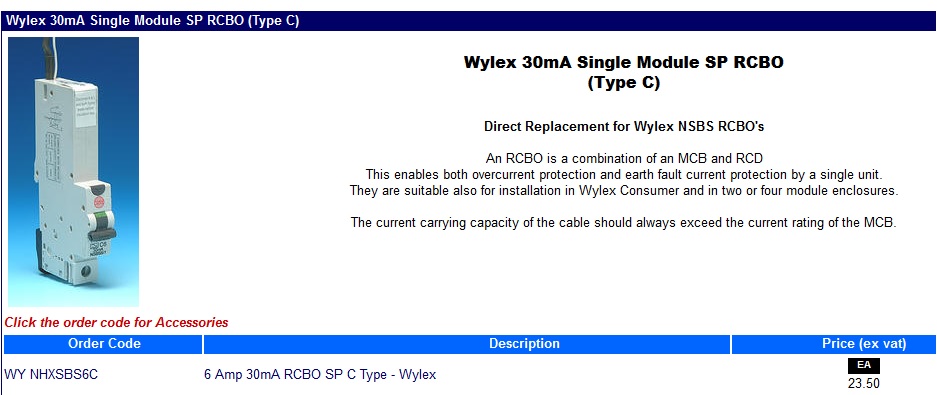

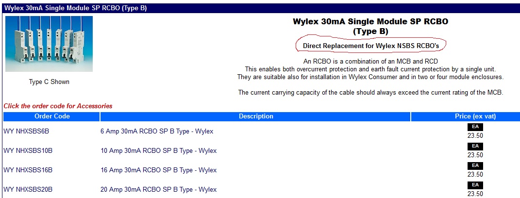

Ah - light dawns. I put all my trust in the almighty CU god and now I see it is not infallible. So I have three lighting circuits without RCD protection. To do the job properly I now need 3 RCBOs to replace the 3 MCBs on the right of the CU. Can anybody please point me in the direction of a supplier of NSB type RCBOs that are interchangable with the MCBs? The cables are <50mm where they enter the switches - so the inspector is right!

I note the suggestion about how expensive RCBOs are but I am more concerned to get the right type. I have found these (see photo) at TLC but they offer a type C or a type B. My wife thinks the CU is about 15 years old.
Anybody know which type I should go for? If C is later than B then its probably type B?

As flameport has told you, you want the same Type as now - i.e. B6. For your "education", Types "B" and "C" (for both MCBs & RCBOs) are not to do with 'age' but, rather, to the operating characteristics - a Type B must trip 'immediately' when the current is 5 times the device's 'rating' (so 30A for a B6) and a Type C must trip 'immediately' with 10 times rated current (i.e. 60A for a C6). There is also a Type D (must trip at 20 times rated current).

Hi again John. Thanks for informing about the difference between type B and type C. I'll get the B6 RCBO to replace the NSB06 MCB.
