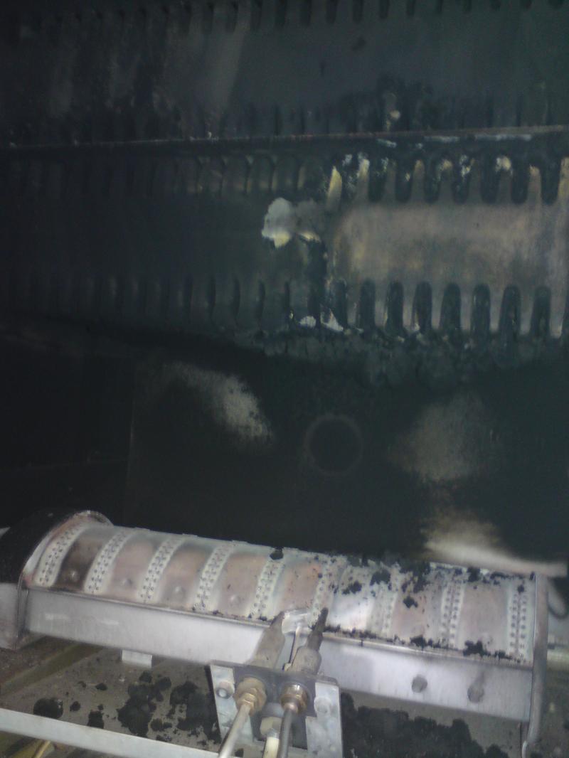

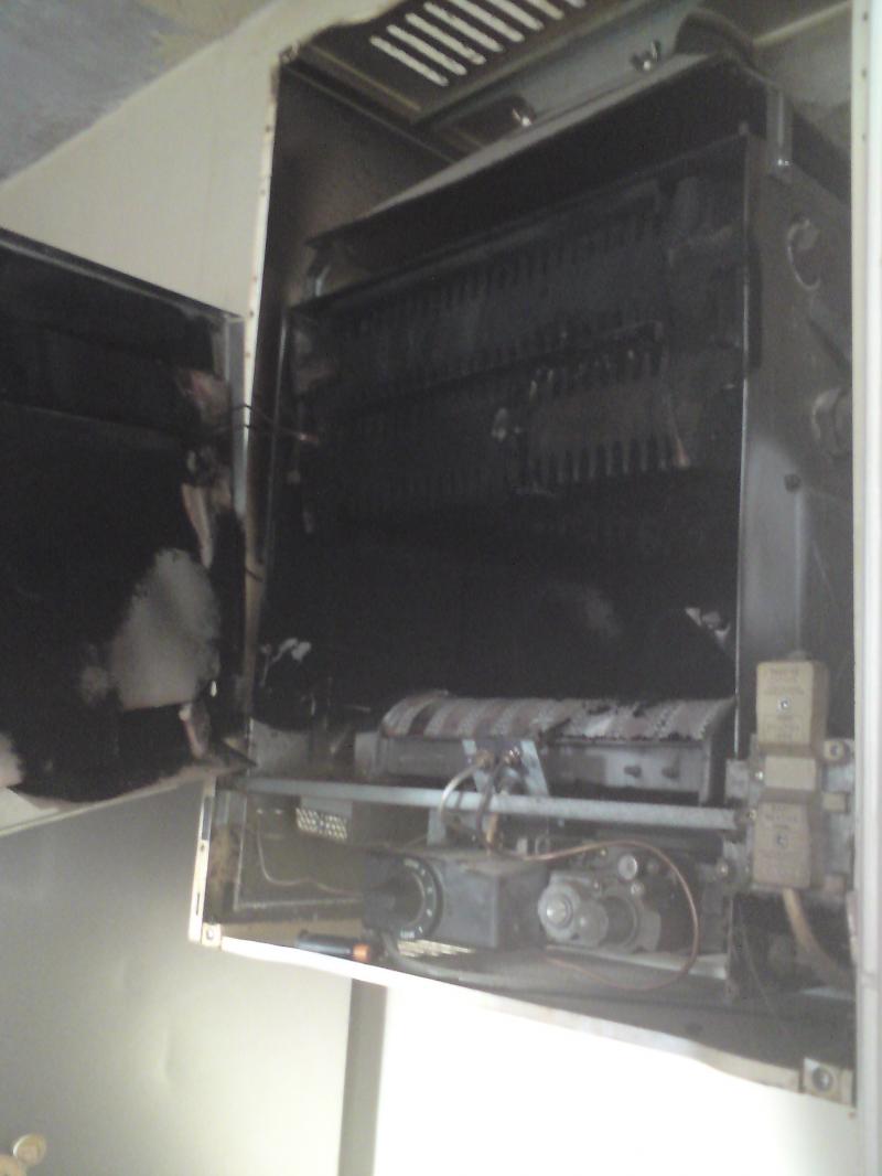

because this happens!! apparently it has been serviced every year, yet no paper work to prove it.
:shock:
Looks like an old Baxi WM open flued.Easy boiler to service so there's no excuse for that.
could you see what had caused it to soot so badly barkie. Poor pilot, flame picture, overgassed?
:roll: :roll: :roll: That aint been serviced in the last 12 months surely? If it has, how on earth has it managed to soot up?
I only de-soot on Saturday afternoons now as its a messy job and I cant work in any more properties after fixing a mess like that.
Mr. W.

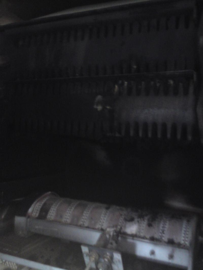

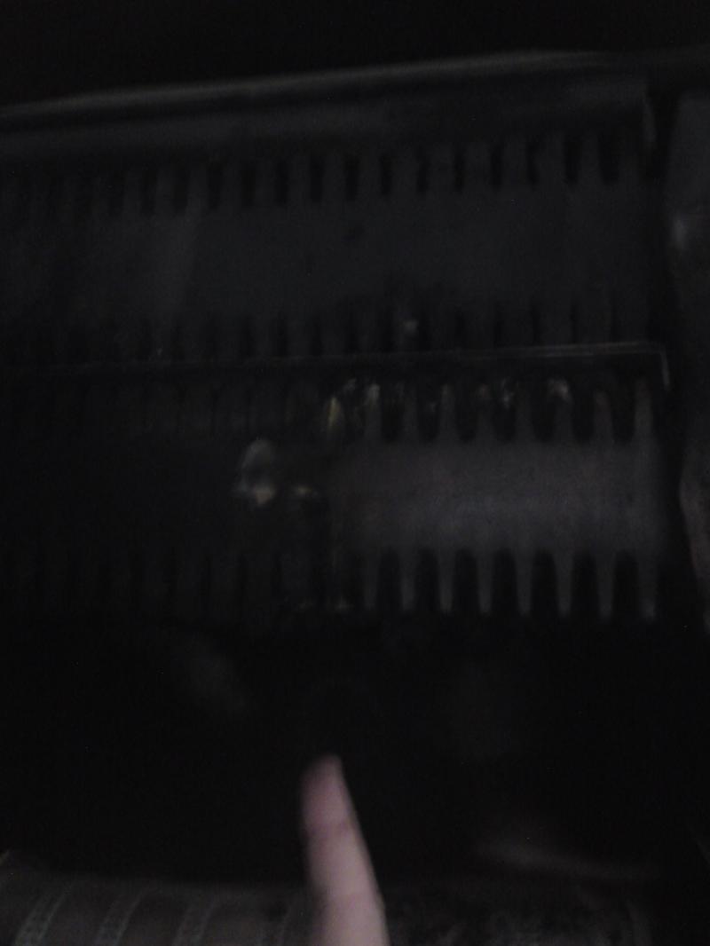

nope? got called out because the flame was becoming starved of air so was lifting all over the place it had melted the gas valve if you look at one pic you can see the spark switch has melted off :shock:. this was friends boiler in a council house capped it ID and told him to get the council out ASAP :shock: ps did a flue flow check just to illustrate the seriousness and all spilled into kitchen.
The wire mesh filter on the burner must have blocked to cause that. Cannot see 'over-gassed' causing that and a poor pilot light would have not sooted the whole heat ex.
