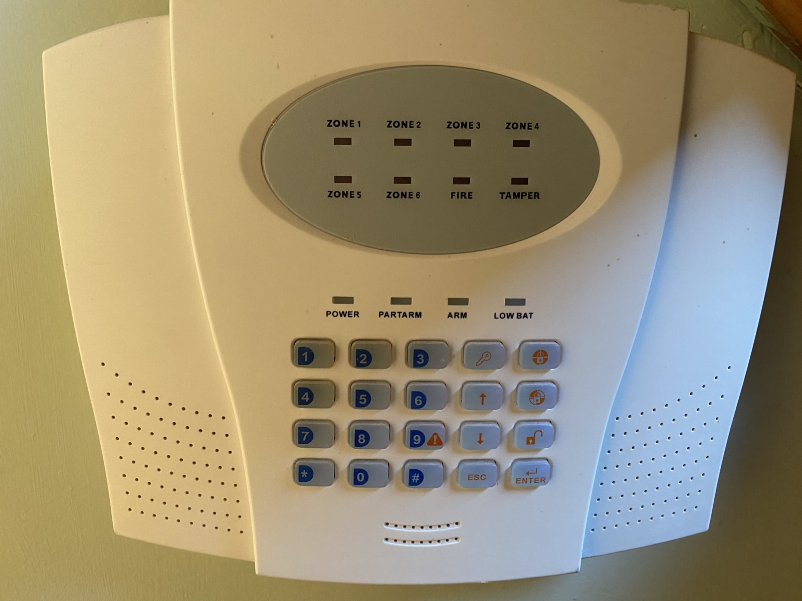

I have this old system installed about 10 years ago and have a problem with the Control Panel. Obviously Wickes have superseded this model and it's now obsolete with no replacement Control Panel for me to change for my faulty item. Very remote question, but is there another Control Panel model that is compatable with this system that I could use. Thanks in anticipation.

If memory serves me correct , Wickes wireless alarms were rebadged response alarms.
Might be worth throwing them an email or looking on eBay?
Here you go!

The problem is the Control Panel starts making a buzzing noise then it alarms. Switch off for an hour or so and reset and all's well for a couple of days and then off we go go again. I guess a component has failed in the internal circuitry, but not sure.

Could be the battery inside the control panel that is faulty and is causing the transformer to buzz ? Possibly.
When was the battery inside the control panel last replaced ?
Should be changed every 5 years or before if necessary.
Must admit the batteries are over 5 years old, but would this cause the alarm to semi tremble/nearly half activate and then go into full db alarm mode?
