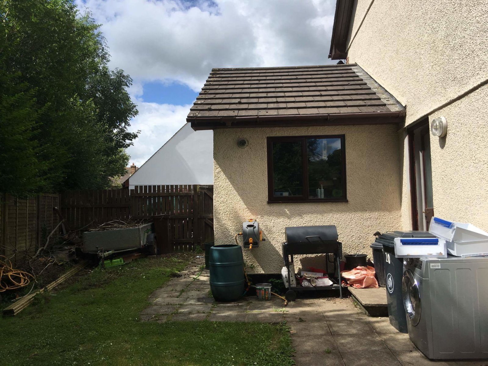

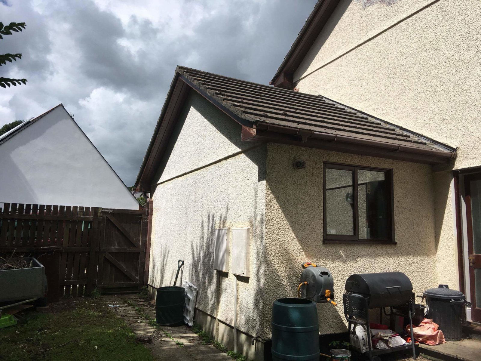

Looking to widen my existing attached single garage by around 9' and am looking to understand what's involved and a rough budgetary guide.
A couple of things to complicate my project include the existing services coming into the house on the garage side wall (water, gas and electric) and the presence of the mains sewerage and surface water pipes running the length of my garden alongside the garage.
I'd like to have the option to make the garage slightly longer as well (a decent sized car only just goes in with nothing else in the garage) but realise that would complicate things considerably and add massively to the cost - especially as you see my back door lurking just behind the existing garage.
Cheers

No, it's the main South West Water pipe that properties around connect to... Mine connects to the mains pipes further into my garden.
From what I can gather, they will grant build over rights but the foundations have to be done in a way they will approve.
so you will need foundations deeper than the sewer pipe and as you know a build over agreement
if you have trees, hedges and shrinkable clay soil that might influence foundation depth.
the garage extension is quite straightforward.
the services, water, gas, electric and fouls drains are an unfortunate complication and will add to the cost, especially if you have to involve the supplier.

I could be widely out but my super rough guess would be £15k
All those services and agreements could cost you £5k -included in above.

all the issues you have are below ground -maybe get groundworkers to do the founds and services -and do the superstructure yourself.
you will need to deal with your suppliers yourself anyway

I dont want to sound negative but I have a feeling most builders would look at all the complications and shudder in horror.
Jobs that involve utilities are a pain -they can be really really slow -and that makes organising a job like that difficult.
Just to add to it -it looks like a new soakaway might be needed.....
