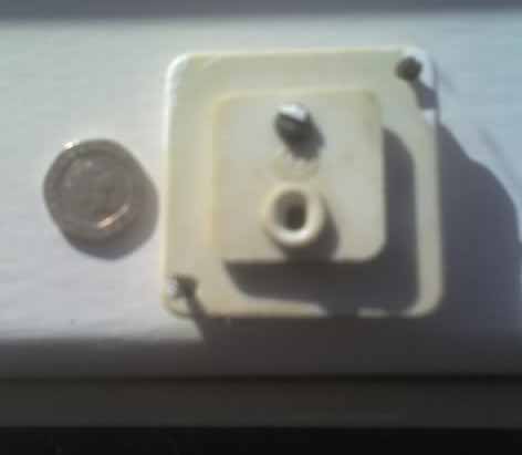

Hi - need your help please.

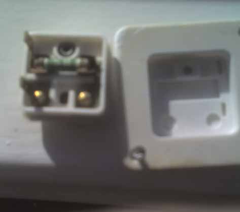

I'm renovating a 1960s house. I have discovered (now that I've got the carpets down :evil: ) that there is this wierd plastic thing on the wall. It is about 3 ins (sorry, 75mm) square, has an oval hole in it (like it could be a thermostat or something similar). On inspection, it contains a 1 amp fuse, and seems to be an inline fuse on some grey cable. The cable is part of the lighting circuit (goes dead when I break the MCB for the lights).
I haven't investigated further since I reall don't want to rip up the carpets. I'm faced with putting in a simple connection plate unless anyone's got any idea as to what this can be???
Many thanks !

Post a photo of it......

What height is it? could it be a connection point for an electric clock?
It is in the lounge/diner, above the door, and just below ceiling height.
It appears to come from under the floorboards on the landing.
Unfortunately I don't remember seeing this particular single core grey cable when I was under there, although there was a collection of 2.5mm ringmain and 1.5mm lighting stuff there (T&E).
try to lay your hands on a digital camera.
Clock connector is a good idea, probably more likely than a fan or a light. Position doesn't sound right for cable TV or fire alarm. Burglar alarm would normally be on ELV not mains voltage abd this would be an odd position for a panel.
I am assuming this is simply a domestic house, not a former office or commercial premises, so not an emergency exit lamp.
BTW - depending on how old and grand the house is - could it have been a Service Bell for the housekeeper or maid?
Nice idea John - but no coconut ! Boring old 3 bed end-of-terrace.
Burglar alarm was in the under-stairs cupboard, wiring to that all resolved and removed. Unlikely connector to electric clock because of position (lounge diner) and is an in-line fuse (on phase, so no neutral to connect to).
Appreciate your time on this guys, potentially a bit of a time waster for you though. Appreciate opinions on an FCU with a 1 amp fuse.......

Hoping to get the photos uploaded tonight.

thats an electric clock connector, the fuse dosn't in any way protect any fixed wiring so if you don't wan't an electric clock there it can be safely blanked off (with any wires feeding it placed in terminal block(
