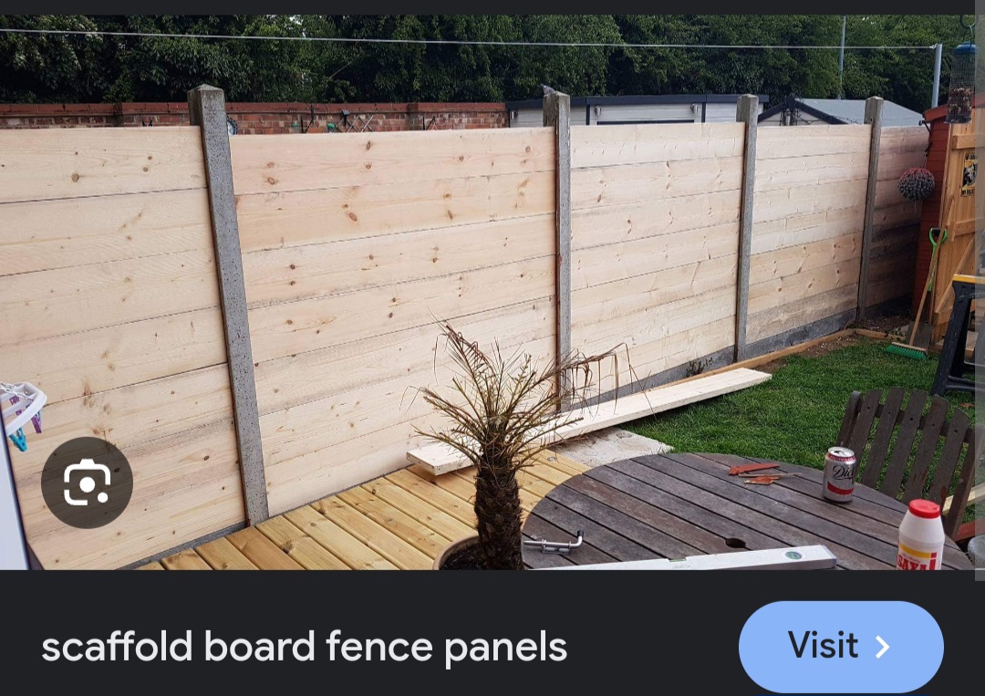

For clarity, I'm planning on building something like the picture below.
P. S any suggestions on how to stop the posts from rotting in the concrete?
Woops. Something like this
Seeing as wooden fence posts always rot in the end, and what you've pictured uses slotted concrete posts, buy some slotted concrete posts and keep the [somewhat hefty!] 5x5 for something else.
It's possible to get big metal spikes with a square socket on top for mounting fence posts. All the ones I've seen/used are heavy duty galvanised affairs and easy to use compared to digging holes and setting concrete, and also fairly easy to replace if they fail compared to concrete
That said the fences I've experienced with concrete set posts haven't normally seen issue of the part of the post that is in the concrete rotting, especially where some concrete has been placed in the hole first so the bottom of the post is encased entirely in concrete and the concrete ramped up toward the point it meets the post.. no, for those posts the point where they rot is around where the post meets the concrete, but that's accessible for regular maintenance with a preserving agent
Plastic fence posts exist btw, but I expect you'll get a lot of years service out of well kept wood, especially if you ensure the base of the posts is kept free of vegetation so the wood can dry out
