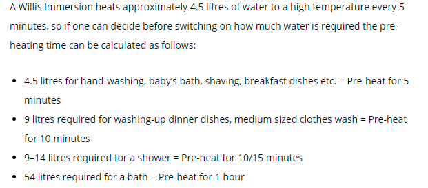

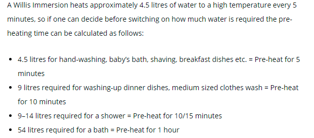

A Willis Immersion heats approximately 4.5 litres of water to a high temperature every 5 minutes, so if one can decide before switching on how much water is required the pre-heating time can be calculated as follows:
  • 4.5 litres for hand-washing, baby’s bath, shaving, breakfast dishes etc. = Pre-heat for 5 minutes
  • 9 litres required for washing-up dinner dishes, medium sized clothes wash = Pre-heat for 10 minutes
  • 9–14 litres required for a shower = Pre-heat for 10/15 minutes
  • 54 litres required for a bath = Pre-heat for 1 hour
That sounds about right to me. It says that the Willis heater has to be on for 1 hour to get 54 litres of hot water for a bath. To fully heat the 140 litres in my cylinder with a conventional 3 kW immersion (the 'bottom' one this time) takes around 2.5 hours - which would equate to about 58 minutes (remarkably close to "1 hour"!) for 54 litres.

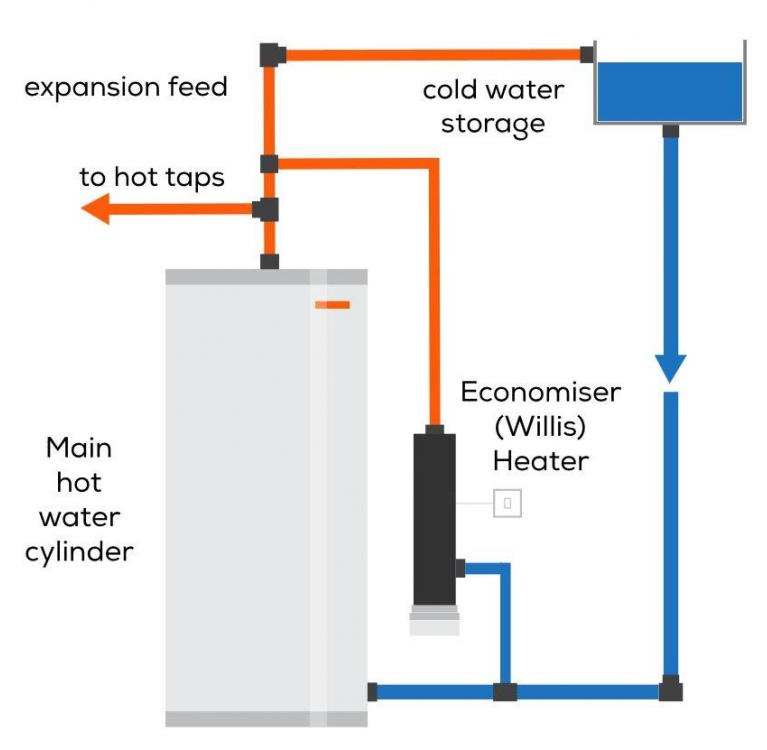

The Willis system is effectively a cold water tank and a "separate" hot water tank connected by an in line water heater. The volume of hot water in the hot tank increases as hot water from the in line water heater flow into the tank. This is hot water and not a warm mixture of hot and cold water.
In the Willis system the bottom of the hot tank is a thermocline layer on the top of the water in the cold tank. As volume of hot water increase and the volume of cold water decreases the thermocline layer moves down the cylinder.
For proper operation is essential that the hot water entering the top of the hot tank ( the top of the cylinder ) creates no stirring of the hot water in the cylinder as this would disrupt the thermocline.

The temperature at top of tank must be dependent on speed of flow, looking at the solar panel version the is a thermostat as the water joins the expansion pipe, there needs to be some control one would think to ensure flow rate matched the heat input.
I should think one could have an array of thermostats so you can select how much water, but what we need is an Irish man to say in real life how they work.
<a diagram>
I don't get that diagram at all - i.e. I cannot see how it could work.
If the pipework were of similar size for the connections to the cylinder and Wallis heater were the same, when you turned on a hot tap, you'd get a roughly 50:50 mixture of (cold) water from the cylinder and heated water from the Wallis.
More to the point, what you depict could not supply more hot water than (the small) volume contained in the Wallis heater (mixed with cold from the cylinder, as above), since there is no way that it would get from the heater into the cylinder.
The idea of the Wallis system is that the externally-heated water (however much one needs) is transferred to the top of the cylinder, but I can't see how what you show could achieve that. In fact, other than a small amount, very slowly, by conduction, I can't see how any heated water would/could get into the cylinder with what you depict.
