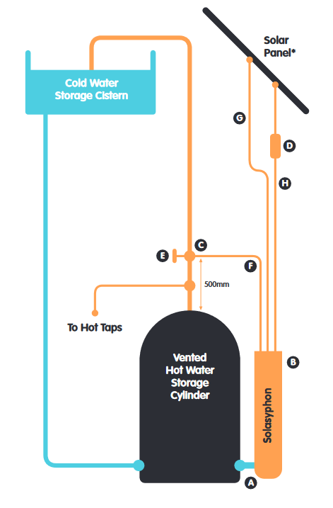

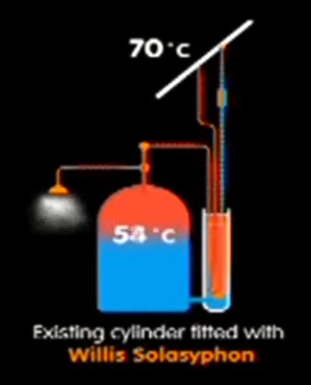

I have many times tried to find some one with the skill to fit the system, and have failed here in Wales. I look at the solar version
which would seems to show it does not need to be 3 kW all the time, however as to how it is all set up, not sure, using a 3 kW element powered from a iboost+ would seem to tick all the boxes, heating in fullness of time the whole tank, but giving hot water quickly, but how is the unit controlled?
My solar can produce 6 kW and the battery has a charge limit of 2 kW so being able to put some energy into the water is good, but at moment 366 watt only, drawing 97 watt from battery. OK winter so central heating running and I can't stop CH boiler from heating the DHW, so only needed in the summer.
It seems the Willis is also used to power under floor heating

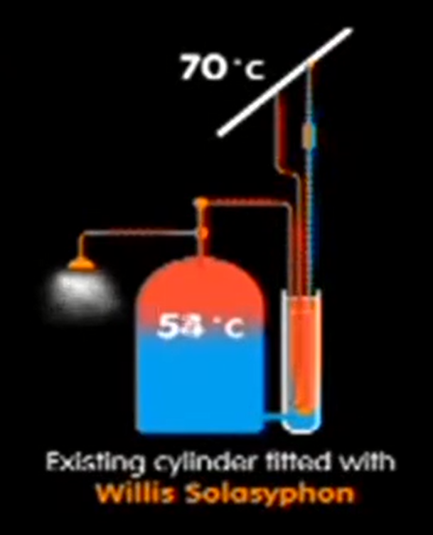

it is simply a small boiler. Watching youtube it shows a ¾ inch regulating valve at the bottom of the tank, so there seem to be two controls when input wattage is variable
there is a valve looking like a gate valve at the base 'A' (¾ inch regulating valve), and 'E' at top is called a temperature sensor, so it seems two methods to control flow when there is a variable input.
However likely better asking in plumbing section, would be interested in finding out more.
which would seems to show it does not need to be 3 kW all the time, however as to how it is all set up, not sure, using a 3 kW element powered from a iboost+ would seem to tick all the boxes, heating in fullness of time the whole tank, but giving hot water quickly, but how is the unit controlled?My solar can produce 6 kW and the battery has a charge limit of 2 kW so being able to put some energy into the water is good, but at moment 366 watt only, drawing 97 watt from battery. OK winter so central heating running and I can't stop CH boiler from heating the DHW, so only needed in the summer.

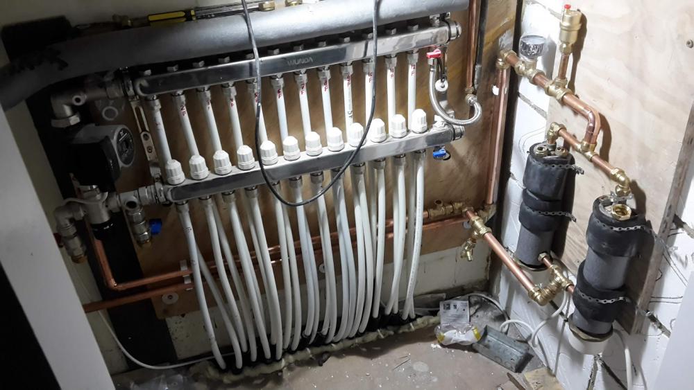

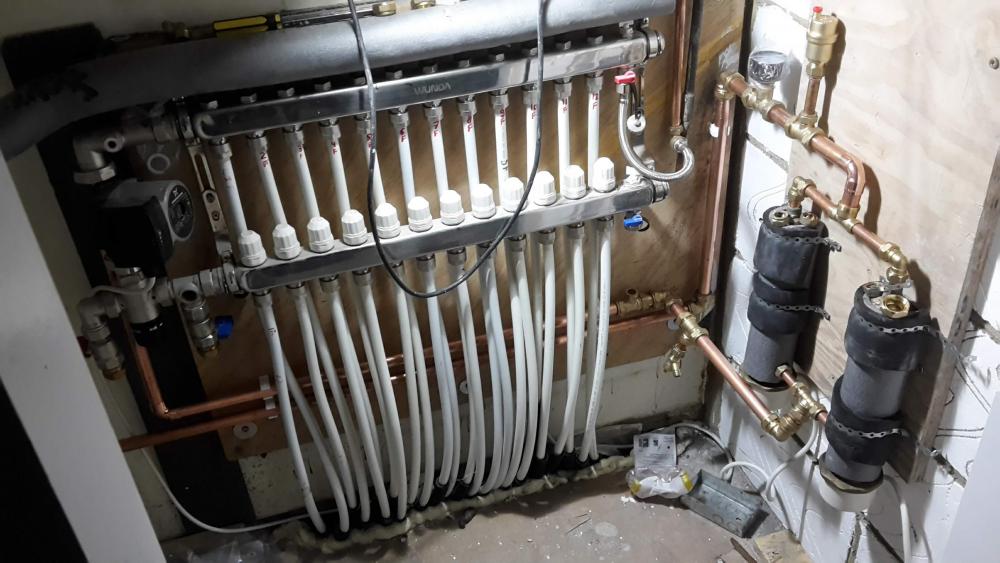

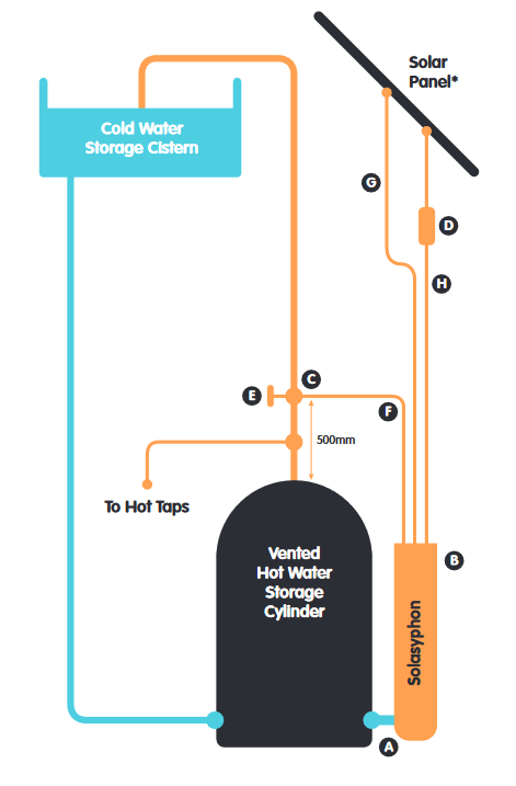

there is a valve looking like a gate valve at the base 'A' (¾ inch regulating valve), and 'E' at top is called a temperature sensor, so it seems two methods to control flow when there is a variable input.However likely better asking in plumbing section, would be interested in finding out more.
