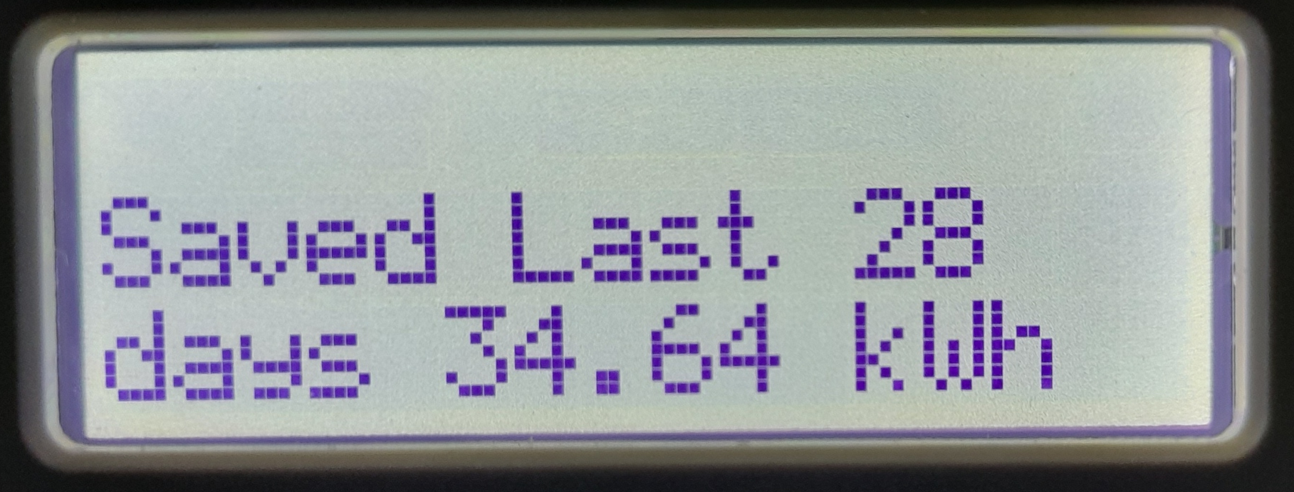

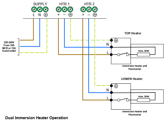

My controller (iboost+) is designed to be used if required with two immersion heaters, and will auto heat the top one first, until the thermostat turns it off, then it will start heating the bottom one.

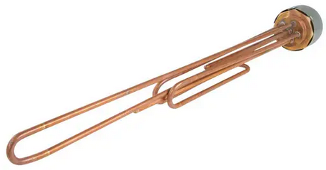

If one compares this to the Willis, the Willis is far cheaper. The iboost+ is nearly £300, that's without the cost of two immersion heaters. And for me a new tank which can take two immersion heaters or one of these
at £150 each. So the Willis system is cheaper it would seem?
Since I already have the iboost+ then the dual element would seem a good idea, but back to the whole idea, is it worth it. At the moment I use a single 27" immersion heater, summer
at 8.5p/kWh so £3 a month, so just not worth worrying about.
