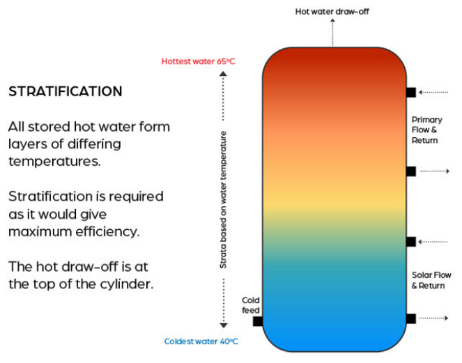

Is the system not just similar to a gravity fed hot water cylinder from a (solid fuel) back boiler?
I don't think so, remembering back to the side boiler in the Aga, it seemed to mix up the water, today we have a hot coil
so water does not mix anyway, but the Willis both electric and hot coil versions, the Heating is done in the external heat exchanger or immersion heater
and it puts water at a useable temperature into the top of the cylinder first, and as time goes by, the stratification layer goes further down the cylinder.
I know it works, but not sure how it works. I can find loads of pictures 1771610386536.pngshowing stratification and saying how to avoid it, but what we are looking at is how to control it. I think there has to be a stop tap
to control the speed the water transfers at, which is missing from diagrams I am finding. I have hunted and hunted for the Willis website, but it seems to have vanished.

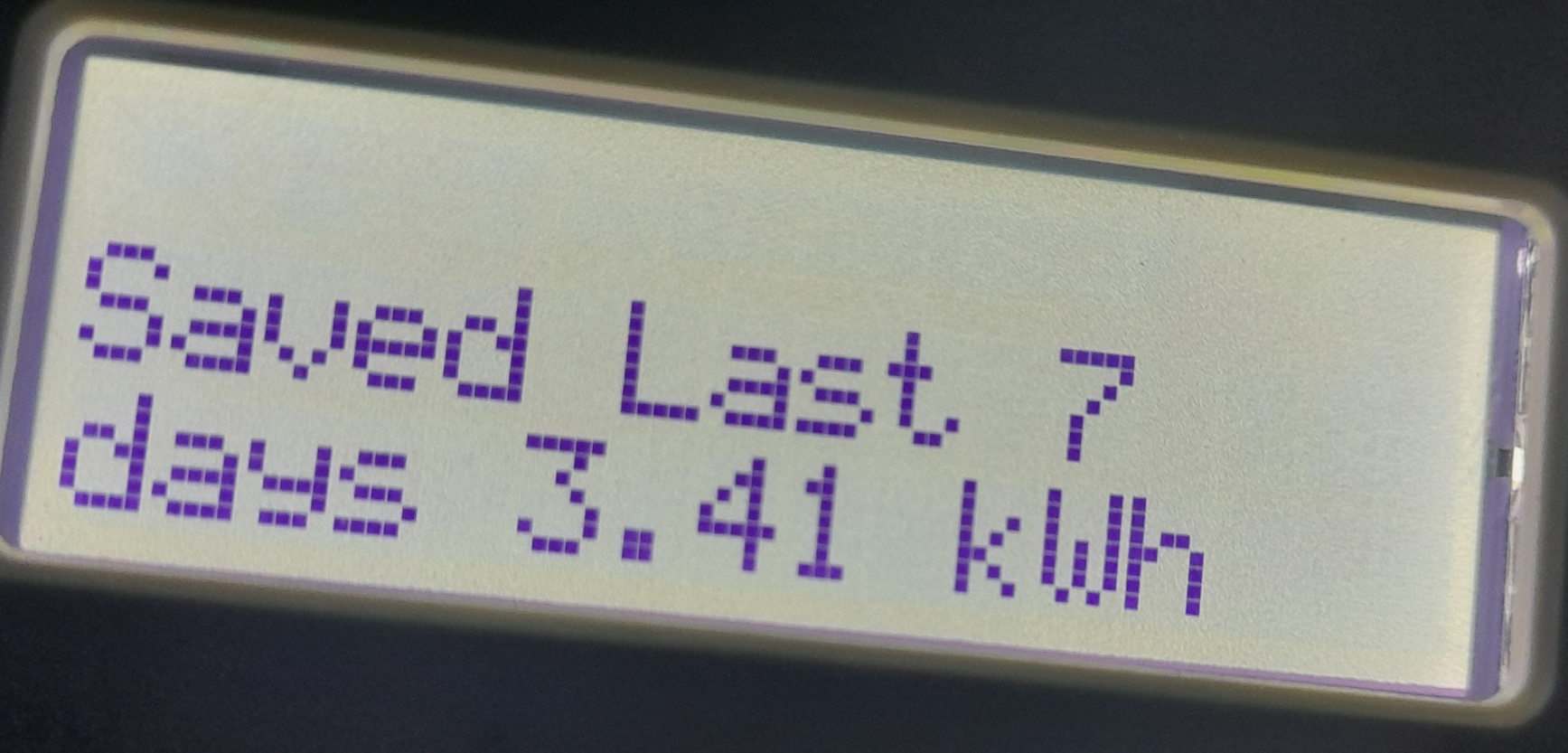

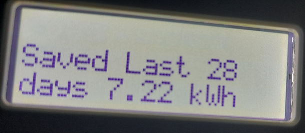

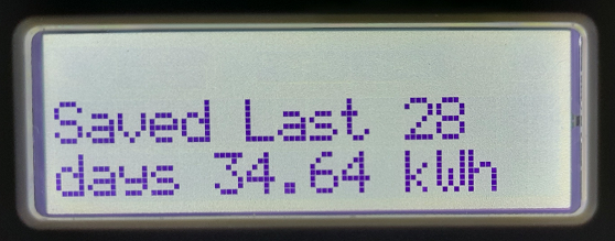

The voltage optimisation was very good with wire wound fluorescent lighting at reducing the power used, but not stopping them striking, with the replacement of the wire wound ballast with the electronic type the benefit evaporated. We did have auto transformers on our tower cranes which were 380 volts, when we were 415 volts, but with harmonisation when we all went to 400 volts, again no longer required, even auto transformer starters, have in the main been replaced with some form of inverter starter.
Some people do try cheating with them 1771677657938.png trying to defeat the over-voltage protection built into solar panel inverters, can't believe he told the world what he had done, doing it is one thing, but telling everyone that is something else.
But I look at my errors, and hind sight is good, I should have not fitted iboost+ as with the voltage optimisation, it was a good idea, when we got paid for export based on the size of the installation, not on what we actually exported, with feed in tariffs being reduced we may return to a time when they help, but even after March 12p/kWh for export and 8.5p/kWh for off-peak, still better heating DHW over night rather than using solar.
In winter my central heating boiler heats DHW, can't stop it. 1771679073798.png1771678865362.png so the immersion does very little, summer clearly not the same, 1771679257911.png as central heating not running, but at 12p/kWh lost payment, 87p and £4.16 for the month, any device to improve DHW would need to be rather cheap. We are looking at around £35 a year to heat DHW or less.
