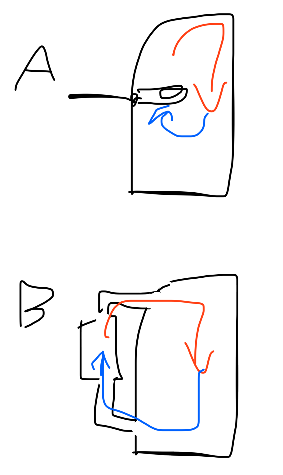

All your sitting here saying "in my mind, in theory, it doesn't work" isn't going to change the universe's willingness to demonstrate that it does work ...
That 'universe' seems to be fairly restricted to one small island.
... so perhaps you need to pour less scorn on those who understand it trying to help you do the same
From the very beginning of this thread which I started, and for the reason I started it, I have been asking people to help me understand their view - but, unfortunately, no-one has yet succeeded.
Not all cars have water pumps.
Very true.
Some just rely on the same principles here, to circulate water in order to redistribute heat
Indeed, but that's because things are such that the conditions for convection are satisfied. If the only source of heatwas being injected into the coolant above the bulk of the (cooler) coolant (and the radiator), it wouldn't work.
As I've said, I have no problem in agreeing that the Willis system will 'work' in eaxctly the same sense as would be achieved by a 'high up' immersion in a single cylinder - but, as things stand, that's all.
So what do you think is the difference - the absence of a connection between the bottoms of the two cylinders, perhaps? If so, why should that make any difference to anything?
Because that will put a complete end, to water rising out of the top of the small cylinder.
Have you never studied, a none-pumped heating system? They need both a flow, and a return pipe.
You seem to be back to talking about the Willis system, since there was no 'small cylinder' in the diagram I was asking you about.
However, as I've said repeatedly, convection will not result in "water rising out of the small cylinder (or anything else)". What it will result in is warmer water within the water already in the small cylinder (or anything else) (plus any connected pipework) re-distributing within the existing volume of water so as to be above any cooler water in that existing volume

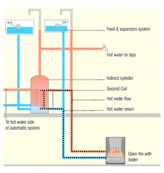

They do - but they presumably only work IF the source of heated water is connected to the cylinder below its top - since it would otherwise be difficult to see how any of the hot water would get into the cylinder, since that would require it to 'fall' through cooler/denser water (i.e. 'defy gravity'), wouldn't it?
Small cylinder, large cylinder - it makes zero difference.
Only if there is a route at the base, for the displaced cooler water, to replace it.
As I keep saying, convection requires no 'replacement' of any of the water. Give or take the need to address the issue of slight expansion due to heating, convection will take place in a 'sealed' cylinder/pipe/whatever if it is heated at the bottom.
Yes, it's getting confusing (at least for me). I recently came across a very similar diagram on-line as the one you posted, and don't really understand why water will flow through the coil if the the hot feed is at its top - so I'm thinking about that!
Thinking aloud (and remembering that it's probably over 60 years since I last lived in a house with such a system!) I would have thought that if one wants to directly heat water in a cylinder without a pump, one would have to have the 'hot water feed' connected to the bottom of the cylinder (or coil), with the return coming from the top - but your diagram (like the one I found) shows the opposite of that - so, again, I'm thinking :-)

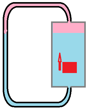

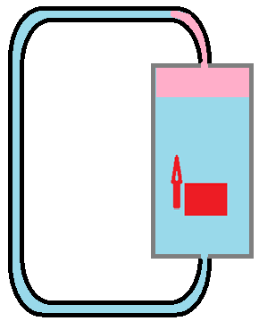

John are you comfortable with the fact that hot water rises to the top of cooler water. For example it's always the top of a radiator which heats first?
Following on from that are you comfortable with a vessel filled with water and a heat source - shown red and low down - the warmed water will rise to the top?
Following on, fitting a pipe loop from top to bottom the heated water will start to rise into the pipe
and subsequent heated water will continue to rise to the top and into the pipe
in the restricted space by the heater the natural flow of water due to heat is up
and there is little chance for recirculation down past the heater
as there is a modest flow permitted from top to bottom via the pipe
that is a much easier path meaning the heated water will quickly be flowing round the pipe and entering into the bottom of the vessel

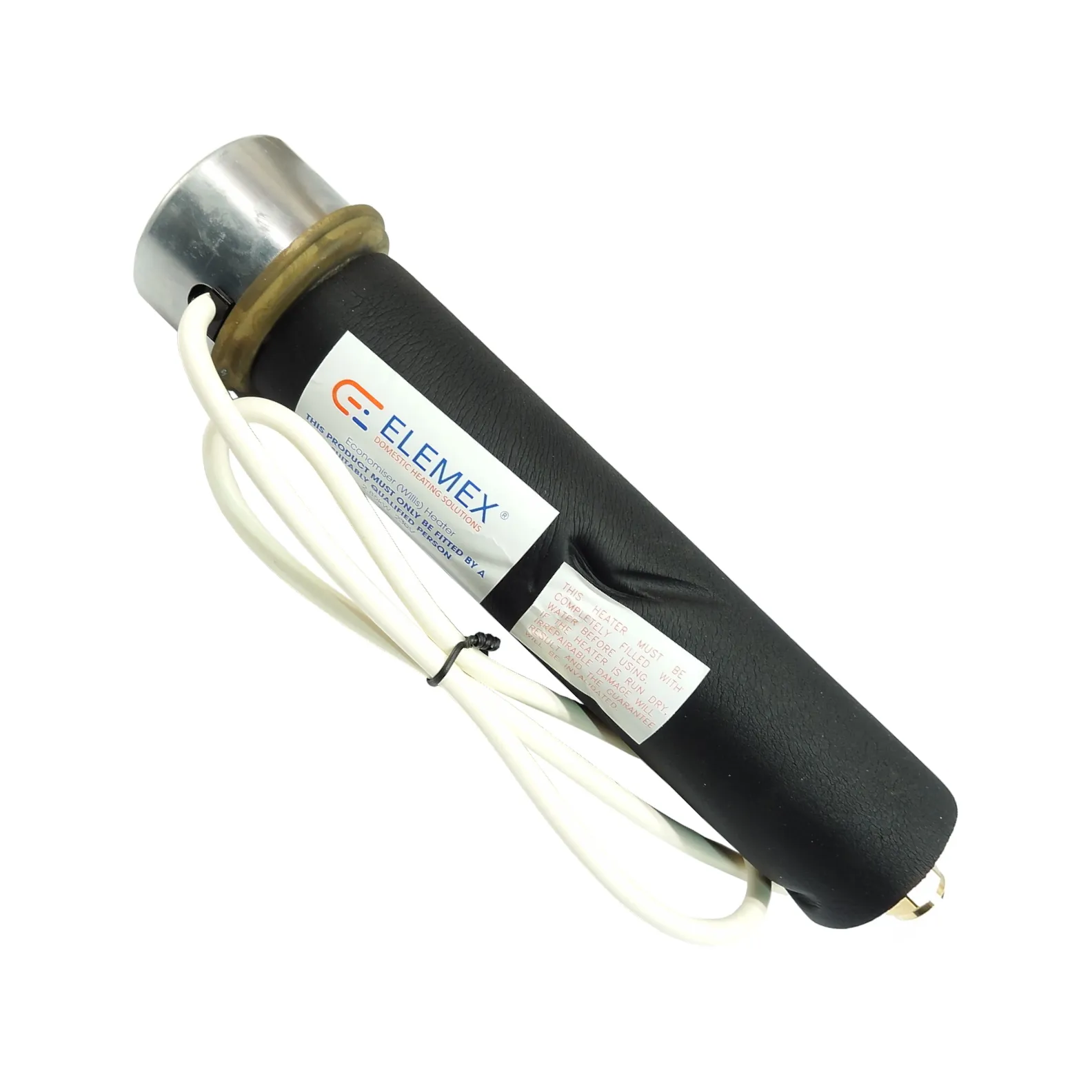

I haven't any experience of a domestic Willis system but recent google indicates a vessel of very modest size, roughly the size of of the immersion heater itself
or to put it another way less than the capacity of a kettle and one of those will boil water in a very short time.
