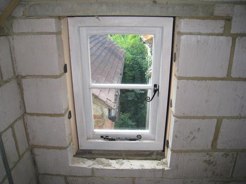

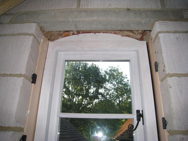

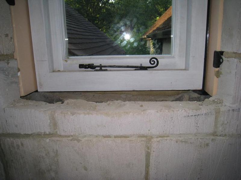

Talking of window shelves/cills (what is the right term?), these are my windows -
In fact the frame covers the outer leaf of the wall, so I can only bed the shelf on the inner leaf (was planning to use expanding foam as seen elsewhere on here) - do you think I need to positively attach the window shelf/cill to the window frame? and if so how? Use the expanding foam there too? I am wondering if I need to be glueing a strip of wood on the underside of the window frame at the bottom to act as a 'shelf' for the edge of the window shelf/cill to sit on and secure to. How would you do it?
