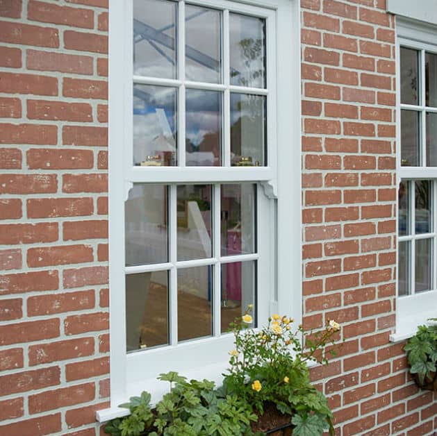

OK, look how terrible this is, and it's coming straight out of Everest's brochure! You'd think they would know better.
That is why I am trying to prevent this from happening as much as possible.
Is that image real, the left hand looks photoshopped...
To avoid problems you are best to speak to the bricklayer on widths. Yes in theory if windows are in multiples of 225mm+ 1 x perp they will match but that may not happen in practice it depends if there is a broken bond somewhere to accommodate overall measurements. Also the perps may be stretched to suit measurements, which is quite common.
