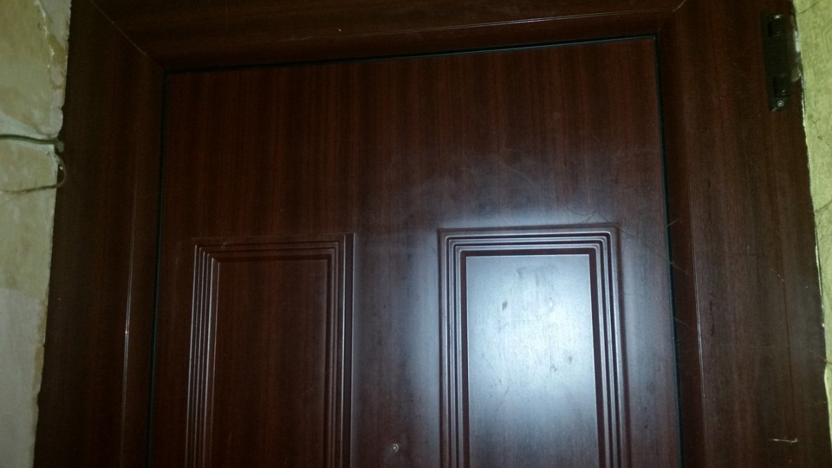

The wife wants a window put into our existing door to let more light in, I said I would only do it if there was a kit available. Does a such a thing exist? (if it does it's very hard to find when searching).
If it's a no then she'll have to make do with the light provided by the cat flap.
PVC door (as title).
Easiest would be to swap the panel for one with glass in it.
There are lots of options over the internet but you'll need to know the thickness of the panel and the woodgrain design ( it's either Rosewood or Mahogany by the looks of it ) and the overall size to get one that fits.
I've watched a couple of videos about removing the beading and then the panel, might as well replace the whole door (wife also doesn't like the dark colour). Thanks for you help.
