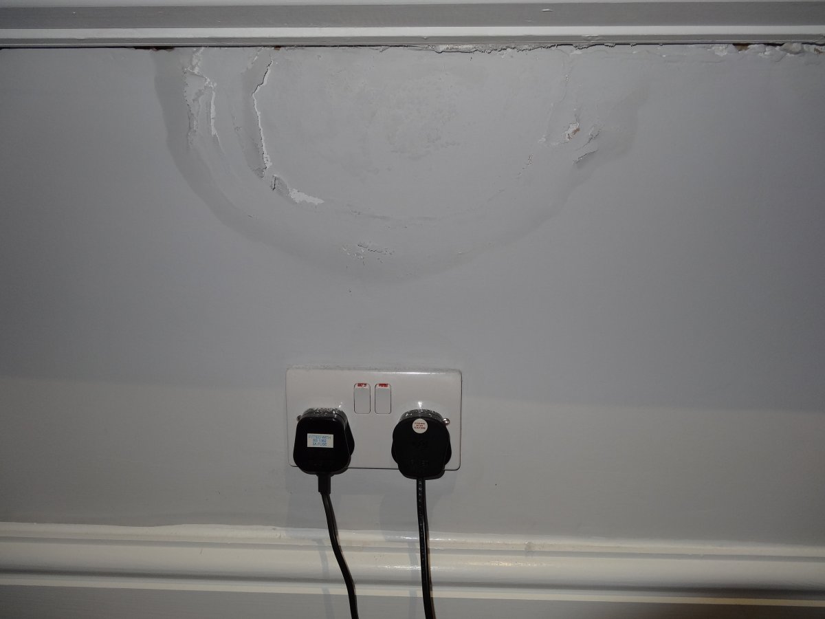

Hi All
Hoping for some advice from from the more knowledgeable folk. I am in an old Edwardian newly refurbed house that seems to have developed a leak after the recent rains. The leak in the picture below is just below a sash window frame.

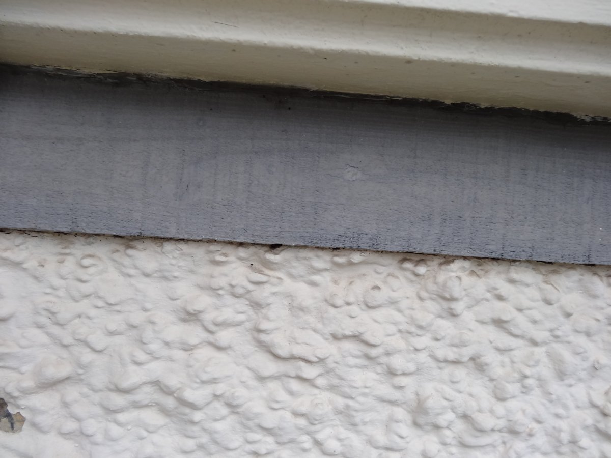

The outside of the frame looks like the picture below and my current thought is whether this is the source of the issue.

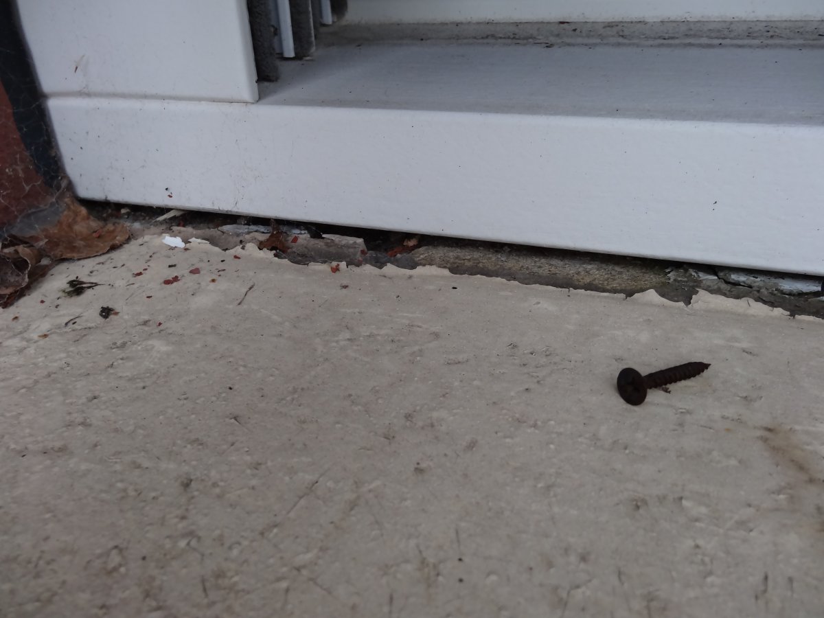

Additional outside view. Wooden board below the frame.

I would guess you are bang on there.....I'd be raking out the grot below the frame, and getting some silicone in there.
Attend to the sides too if there are gaps.
